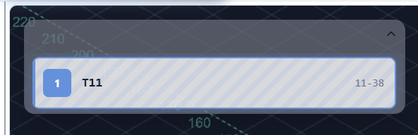

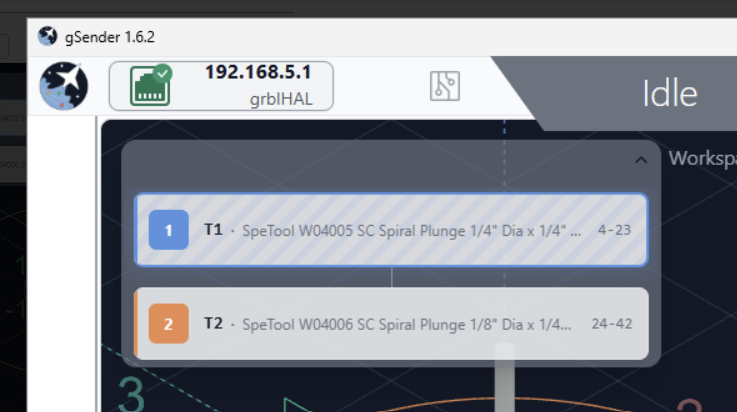

I just received the TLS and had a couple issues that I figured would be covered in the forums somewhere. While digging, I noticed that it seems the tool descriptions are shown differently between Fusion (what I use) and V-Carve in the post-processed machine files.
V-Carve displays the tool number and description where Fusion does not:
**Snapshot for program created with V-Carve**
 ![image](https://forum.sienci.com/uploads/default/original/2X/b/b3136412443dbcb138b5a5e79e6c3818c849ccd8.png)
**Snapshot for program created with Fusion**
 ![image](https://forum.sienci.com/uploads/default/original/2X/4/42150beeddae00c81724c614fe8bdf41e3d1cce5.png)
I checked some boxes in Fusion and changed a couple things in the tool setup itself, but no success. Is there a change or something in the grbl/grblHAL post-processor in Fusion to make this work?

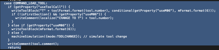

gSender annotates the Tool Timeline with any comments, (..) or ;… on lines with a M6. If you want the same information, you’d need to have Fusion append a comment containing tool information with M6 commands.
I think the default grbl postprocessor already appends the tool comment section as a comment next to M6 (so your annotations would need to go there), but I’m not an avid Fusion user so hopefully someone can confirm/correct me.

You’re correct, the tool.comment variable shows below the M6 line in the NC file but does not appear in the gSender tool dialog.

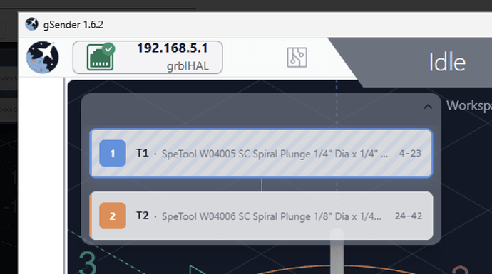

I messed around with the gcode and simply added “; \<\>” after the M6 command and the tool name appeared, similar to how the Vectric files look. Success, but a manual activity.
