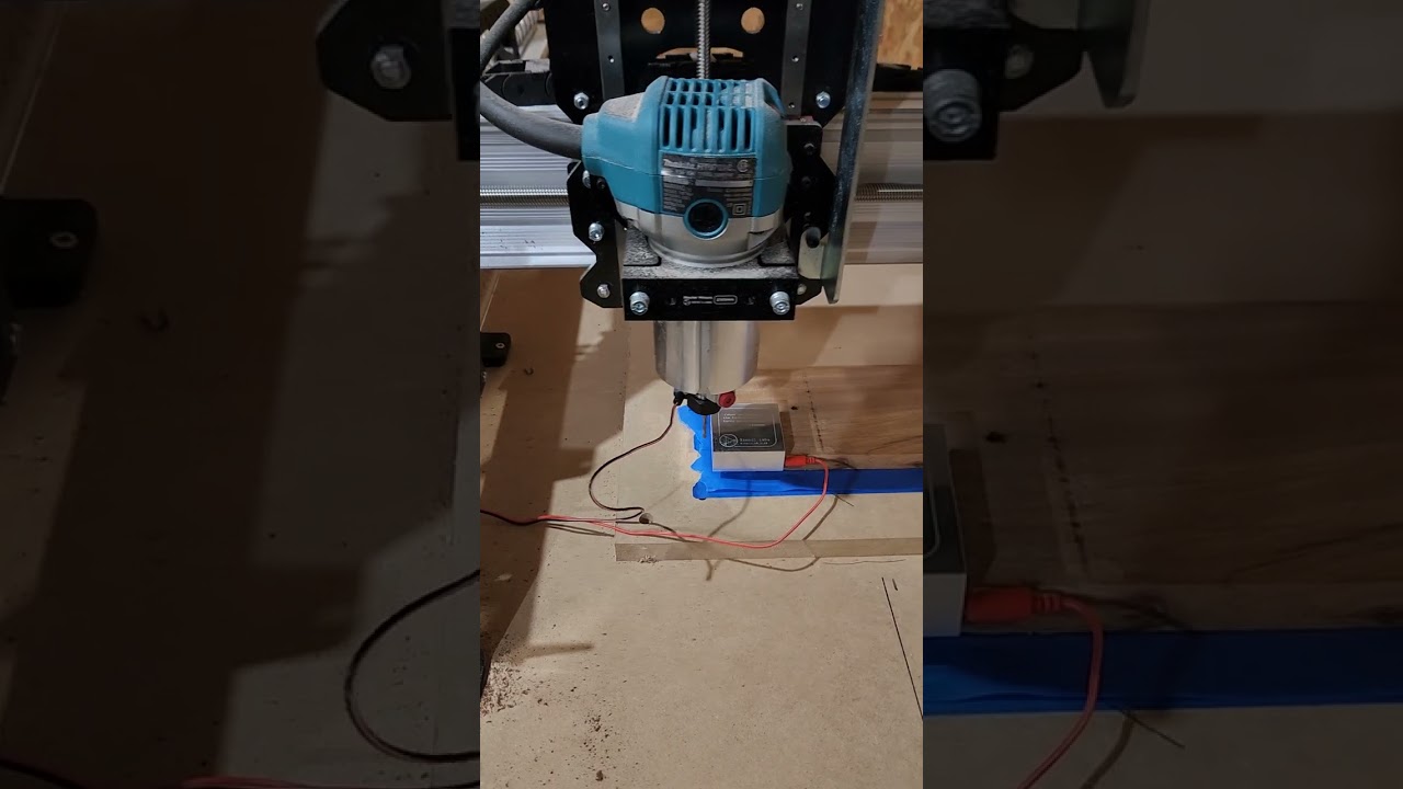

Hello forum! I am using the touch plate to calibrate my machine - the machine goes through the correct set of motions:
- establishes connection
- calibrates X, Y, and then Z
(Im following the instructions here: [https://resources.sienci.com/view/gs-using-gsender/#probing](https://resources.sienci.com/view/gs-using-gsender/#probing))
However, when I click on “Go to XY0”, the z axis goes all the way to the top, slams into its upper limit, grinds itself for a second and then stops. The X and Y are correct, but the Z is at the top of the z gantry and not zeroed. In the video below, the z axis ends with the blue position numbers at 131.00
Video here:
[![](https://img.youtube.com/vi/3Sb31RVPg3E/maxresdefault.jpg "xyz calibration with standard block") ](https://www.youtube.com/watch?v=3Sb31RVPg3E)
Thank you for any insight into solving this - I am currently adjusting the z axis with precision jogging… but would love to trust the touch plate!
