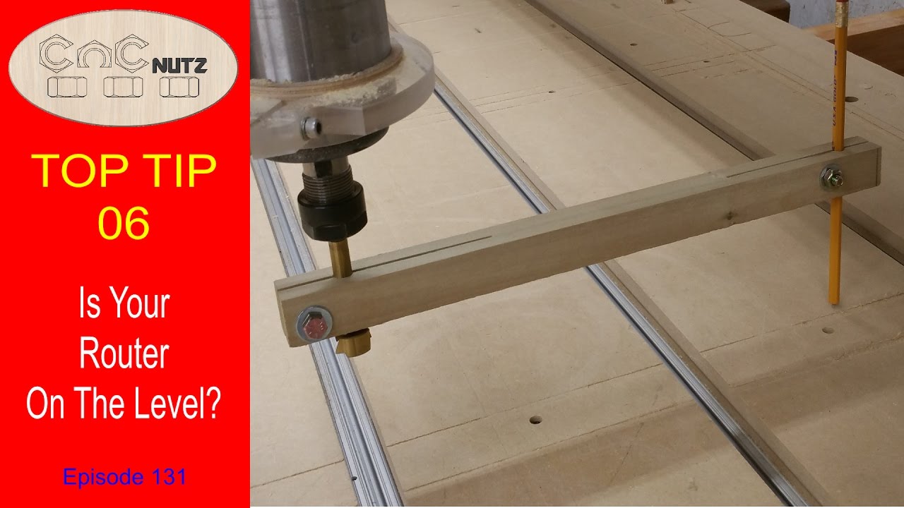

First if you put your machine together properly to begin with it should be perfectly square from that point. Check all the screws in the feet and make sure they are tight. If one is loose it could cause a problem. Then make sure the screws holding the feet to your table are tight. Not too tight to split the printed feet.
After that the only spot you should adjust the machine to tram it is behind the router in the adjustment plate. You can get brass shim material from lee valley if you need some. There are no videos of tramming the longmill but there are some that are similar.
Both of these videos are great because they are home made machines. They use the same principles as the longmill to attach the routers or spindles.
[![](https://img.youtube.com/vi/D6pfIoyhgTc/maxresdefault.jpg "Is your Router on the Level? - CNCnutz Episode 131") ](https://www.youtube.com/watch?v=D6pfIoyhgTc)
[![](https://forum.sienci.com/uploads/default/original/2X/f/fab5b014964b60ab898aa2f0a5f2c705a3f5470d.jpeg "What the heck is Tramming? Basic CNC Tramming...") ](https://www.youtube.com/watch?v=yjHQHlUH6vs)
