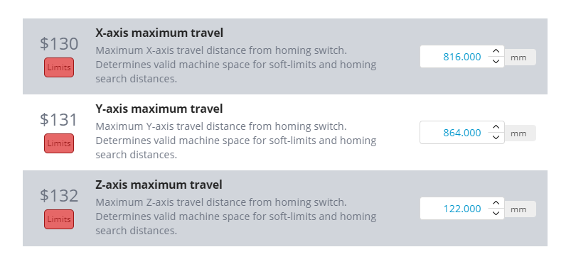

Set travel limits in firmware settings, to 816 & 864mm (X & Y); Homed to LF via sensors with “homing” feature. Send to RR via Home control, and it only goes to 775 & 820.
Any ideas?
Rapid position travels 95% of the way to limits, not all the way - it’s meant to get you into the ballpark area, not exactly to the edge.
