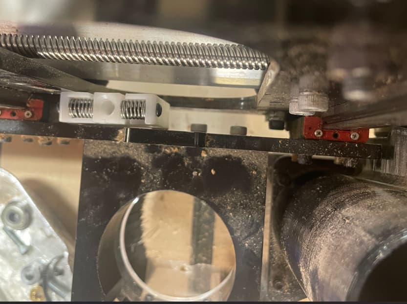

I got the new anti-lashback bolts, and installed them today. The good news is the machine sounds much happier. The bad news is the dados are still being cut too small (maybe about 0.005" larger than with the old bolts, but still 8 to 15 thousandths short )):
Here are the old bolts - note the one nearly split in half - guess I got that one WAY too tight.

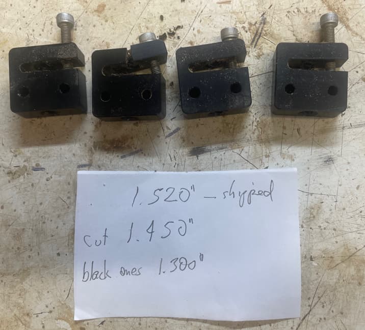

Ran into an issue getting the one for the z-axis installed: the original bolts were 1.3" tall. The new ones are 1.52". This picture is looking down the z-axis - note the small bolts to the right of the anti-lashback bolt. They are high enough, that because of the new bolt size, you cannot get the thread holes lined up. I had to cut the 4th one down, only by 0.070", but still, it was a pain. Sienci guys - you may want to make one of the four a bit smaller. Just my two cents…

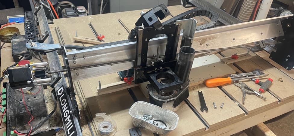

Also, I was on the verge of taking the whole right size y axis apart to get the old bolt off the x-axis lead screw. But it was much easier to take the four bolts off the motor on the left side, then the lead screw just comes out. Here’s a pic:

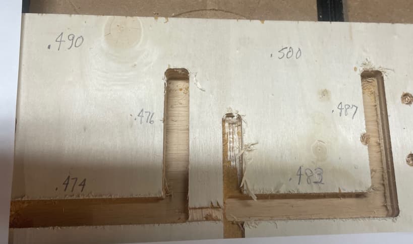

I ran a job where 2 dados in the X and Y directions were 0.49" and 0.50". Unfortunately, the Y cuts were 13 and 14 thousandths of an inch short and the X cuts were 16 and 17 thousandths short.

I’ll just edit this post because I tried a couple more changes. Rather than actually measuring the 100mm of travel, I just used numbers based on the size of the dado cuts. I tried using 102 for the second change, but the dado cuts were even smaller. So I way overcompensated the third time, and now the cuts are very close to what was specified in the G code:
  • 1: 200.00 * 100 / 101 = 198.02 => still too small
  • 2: 198.02 * 100 / 102 = 194.14 => even smaller!
  • 3: 194.14 * 100 / 94 = 206.53 => just about right :))
So I’ve learned a lot about EEPROM variables $100 and $101. Can I change them directly?
