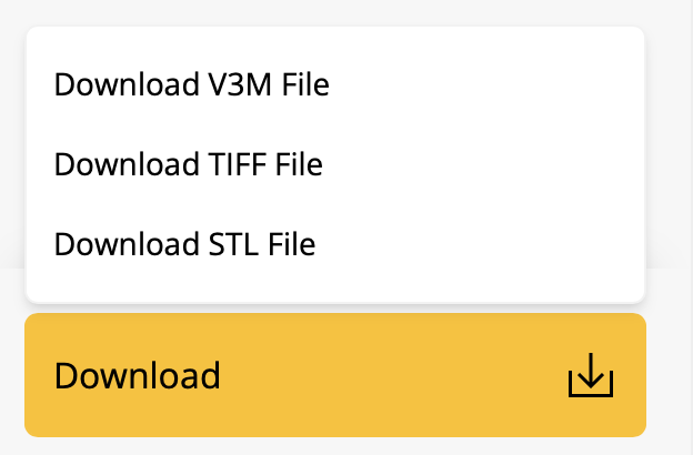

I don’t use any Vectric software except for that Easy Create and used it with my Altmill. I’ve only used Fusion with my Altmill currently. I must have exported it as STL.

@gwilki Yeah, as @DavidB points out, STL is an option. But it might be new because I don’t recall STL being available last time I used it. It’s there today.

@DavidB @Chucky_ott Good to know. Their website as of this morning only shows V3M as the 3D model format. Here is what I read on their site
“Adjust depth, scale or detail settings of the relief to get the exact result you want and export your model as a standard TIFF file or V3M format to seamlessly import into your VCarve or Aspire.”
I’m glad that they have changed that as I can now use the results on my 3D printer.
**Post date:** [October 11, 2026, 4:29pm UTC](https://forum.sienci.com/t/turning-a-photo-of-an-object-into-a-carve-able-3d-model-whats-your-workflow/27260/9 "2026-10-11T16:29:02Z")
Guess they just don’t update their website since I first exported it as STL back in July.
