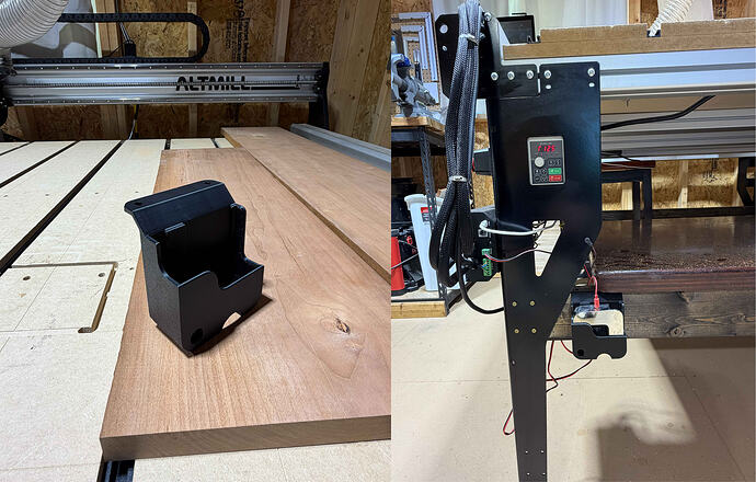

I love this holder thank you Bubba. I am also loving this new Bambu H2C multicolor 3D printer lol.
 ![Touchplate holder 3d print](https://forum.sienci.com/uploads/default/original/2X/7/73fe1d3abc9f72aaad9190748e39f6ca168161cf.jpeg)

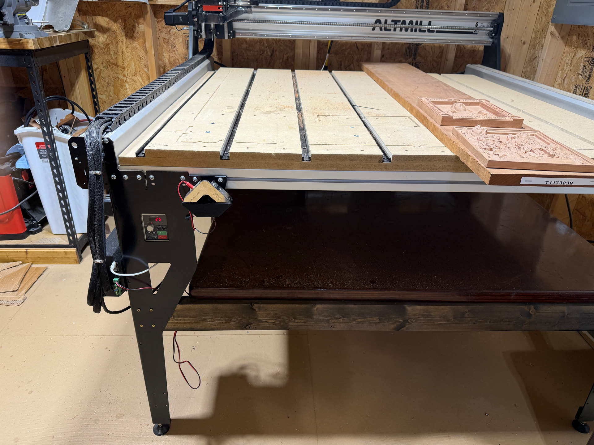

Just a small update, that print design above did not work to well with the Alt 4x4. But this one worked great:
 ![IMG_1643](https://forum.sienci.com/uploads/default/original/2X/2/29e9ed5054ab62d9108b88f4f4f23b05b9aa94e3.jpeg)
**Author:** ![gremlin](https://forum.sienci.com/user_avatar/forum.sienci.com/gremlin/32/13047_2.png) [@gremlin](https://forum.sienci.com/u/gremlin)\
**Post date:** [April 21, 2026, 3:19pm UTC](https://forum.sienci.com/t/ultimate-altmill-drawer-cabinet/25568/23 "2026-04-21T15:19:14Z")
Yeah that holder works great until you install drawers I ended up shortening the model and using VHB tape to put mine on the leg so the drawers can open

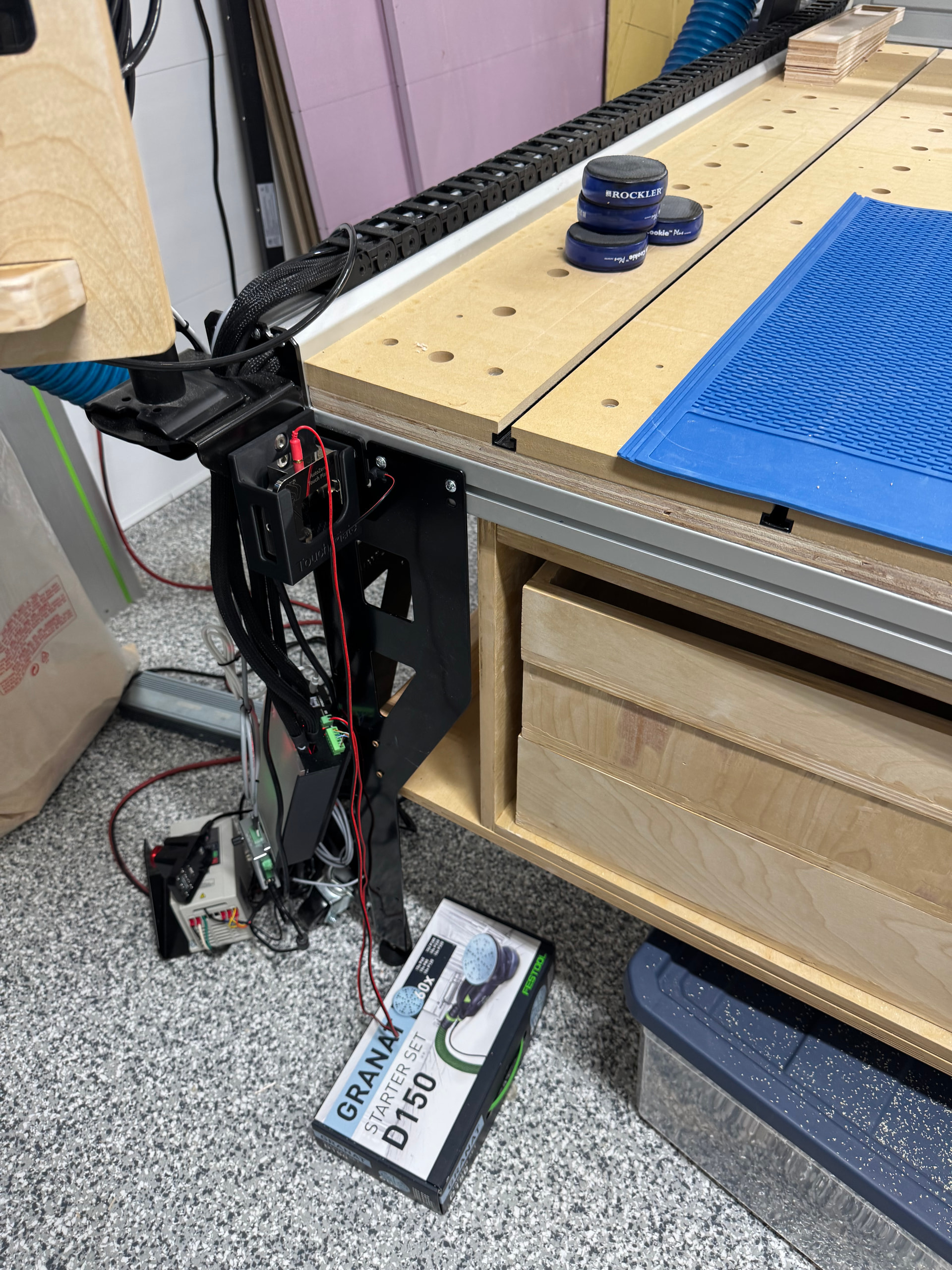

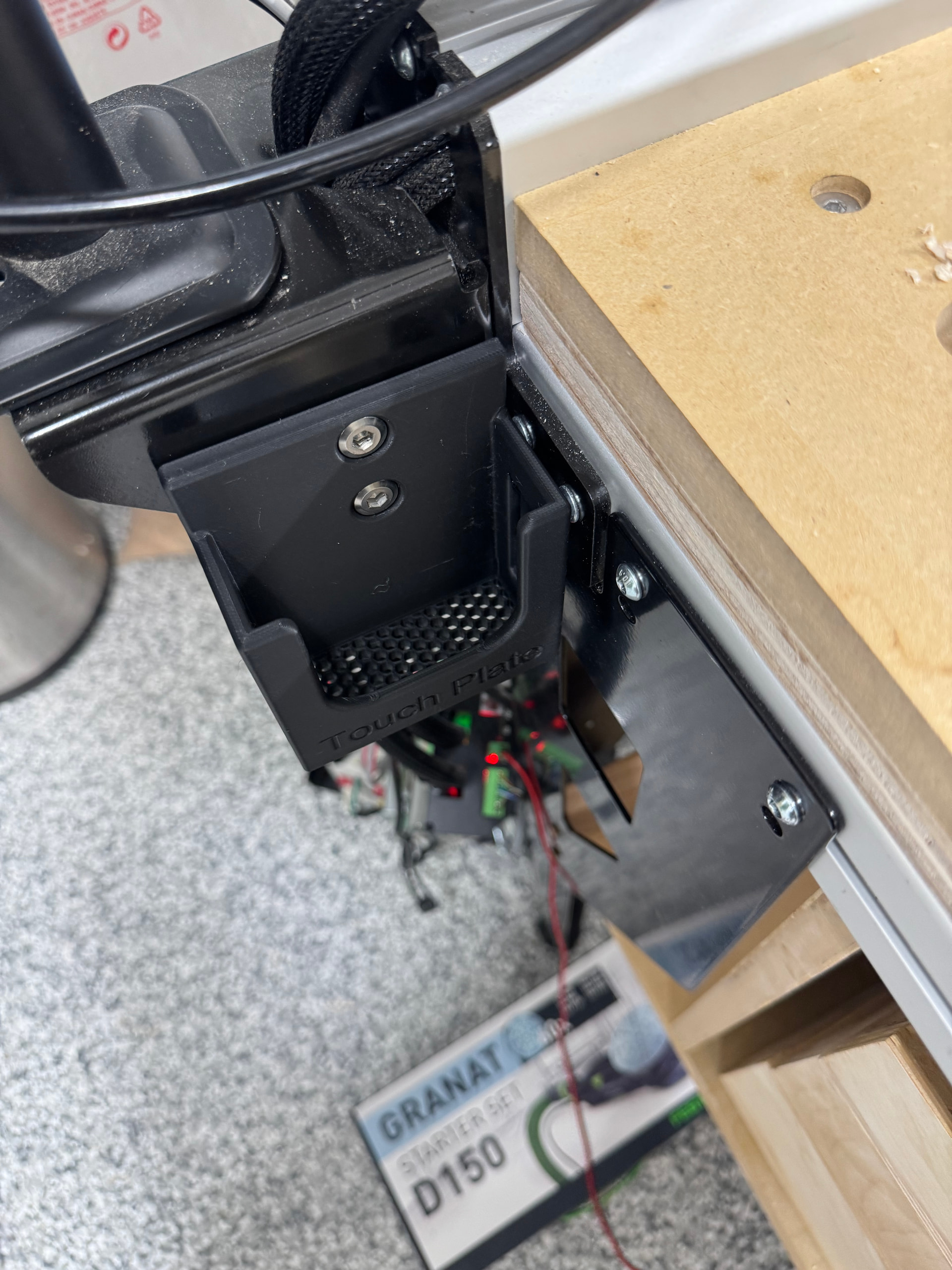

**Post date:** [April 26, 2026, 7:08pm UTC](https://forum.sienci.com/t/ultimate-altmill-drawer-cabinet/25568/27 "2026-04-26T19:08:20Z")
I ended up moving from the front of the leg to the Gcontrol mount where there were two random holes going unused. I didn’t love using the screws on the leg as I was worried about creating wobble as I couldn’t crank down on the screws as hard as it would go right through the PLA plastic. The PLA plastic was cracking as it was. So now I’m not affecting anything and it’s just as convenient. Apologies to whoever’s idea I blatantly ripped off. Relatively easy Fusion project. I won’t release since it’s not my idea. Oh those holes easily fit M8 screws.
