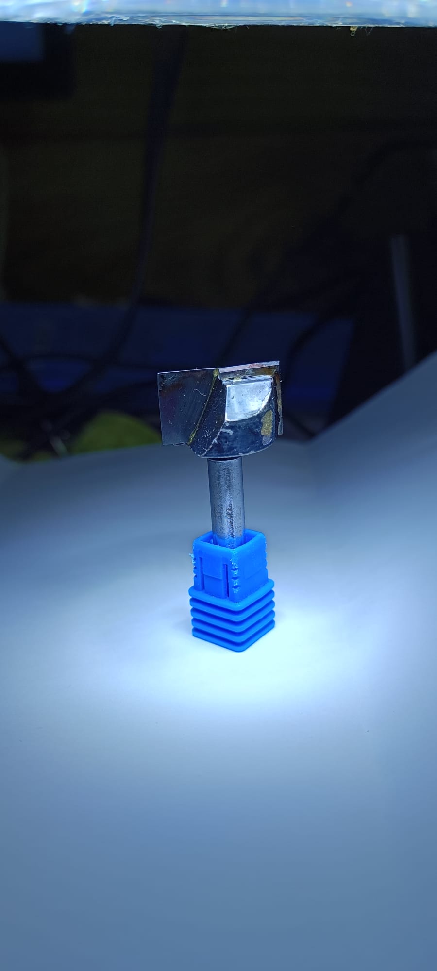

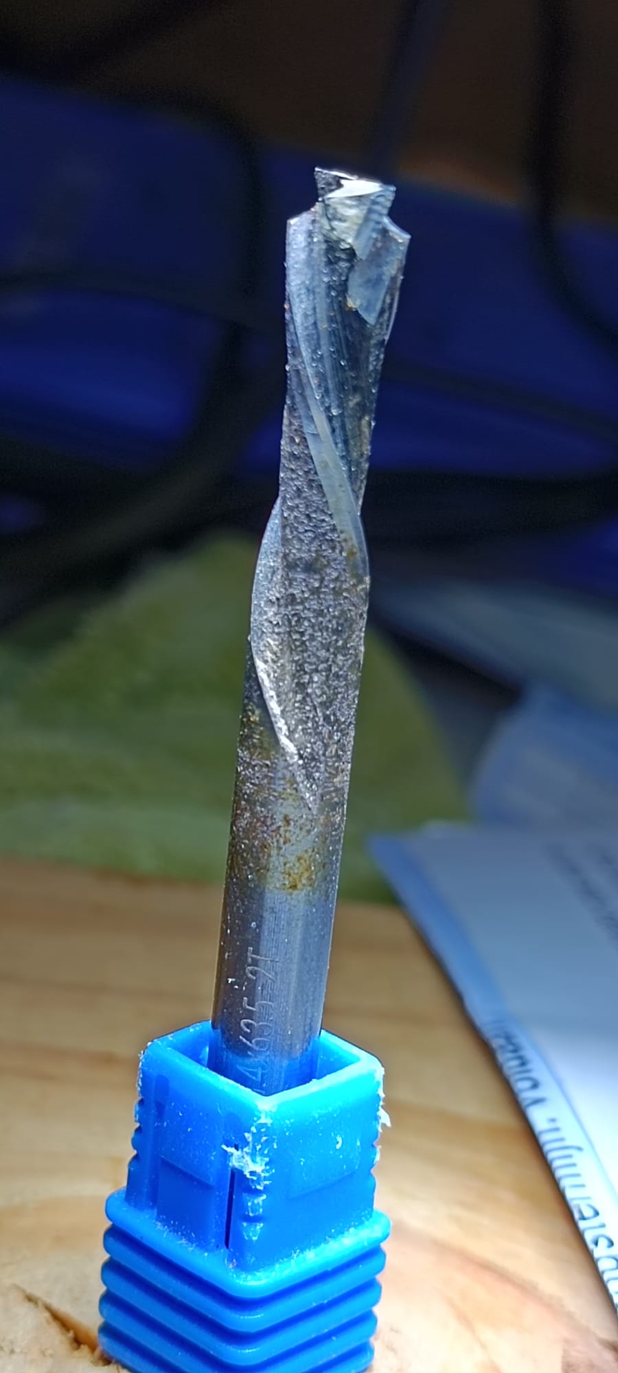

Today I felt like starting up my secret laboratory, because it has been a while that my inner Dexter got some quality time doing experiments. But what to have Dexter do?
Hey Dexter, how about you take a look at this banged up compression bit and find out why it no longer cuts as crisp as it did two years ago! Dexter rushed off into the secret elevator and shushed into a even deeper, more secret part of the lab.
“Interestink”, I heard his excited voice echo from below, “It ish compelletally coverted in some brown spotty gue!”

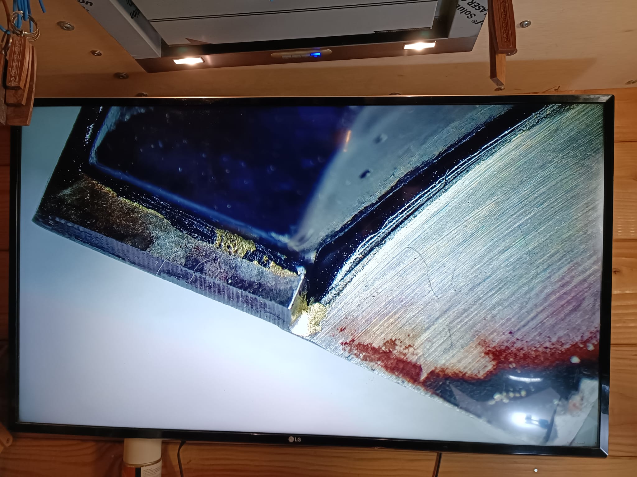

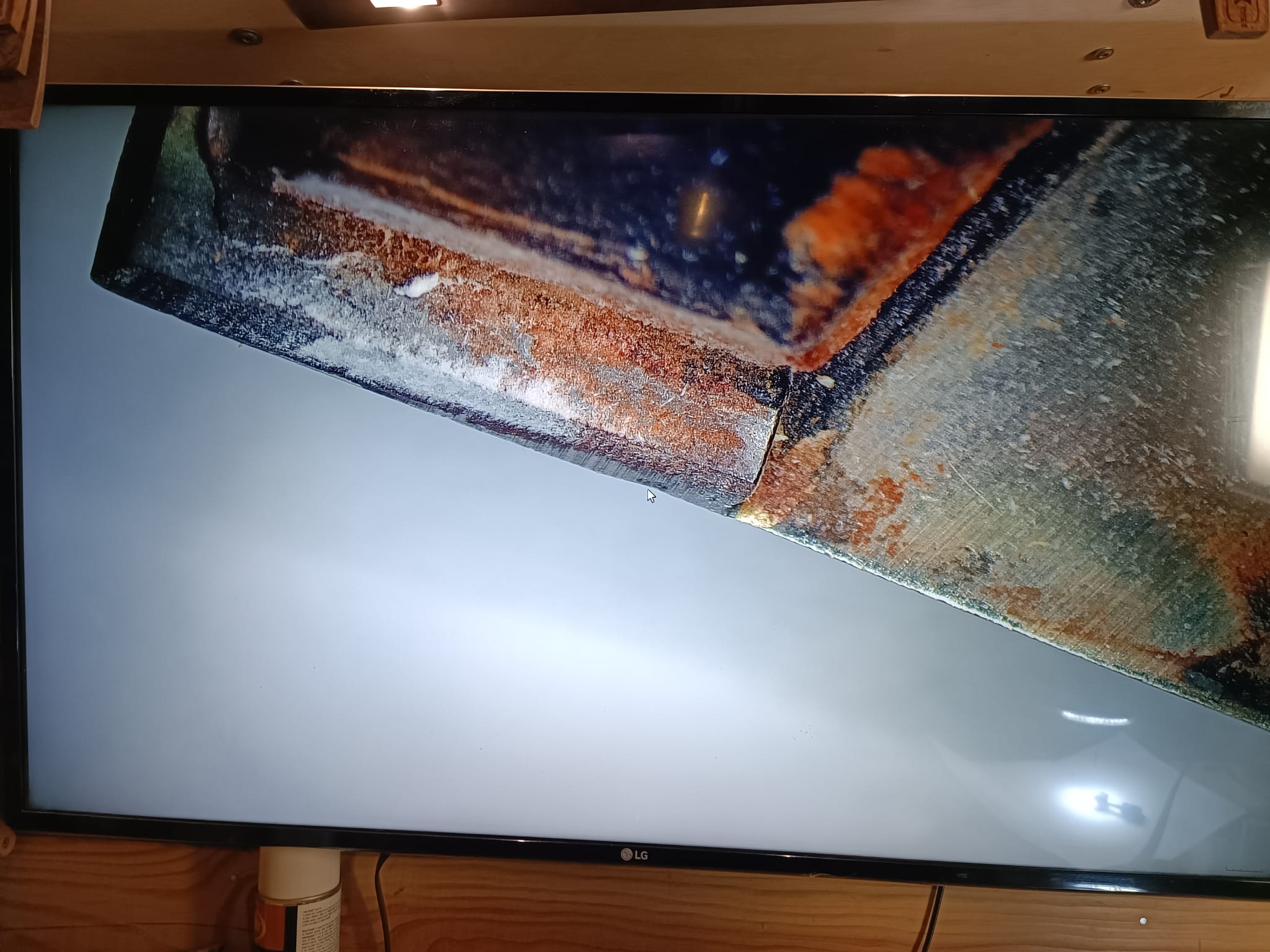

“I will puut it unter ze super conducting secret microscope wiz ze Instant Nanomilicrometer Camera I was gifted by my good friend Zeff Jezos to get an even better look at zis mysterious material that seems to grow from ze metal surface of zis poor entmill!”
 ![photostudio_1751223229441](https://forum.sienci.com/uploads/default/original/2X/8/81c3212a47ed65efedc5b573fce975dc475dfe6b.jpeg)

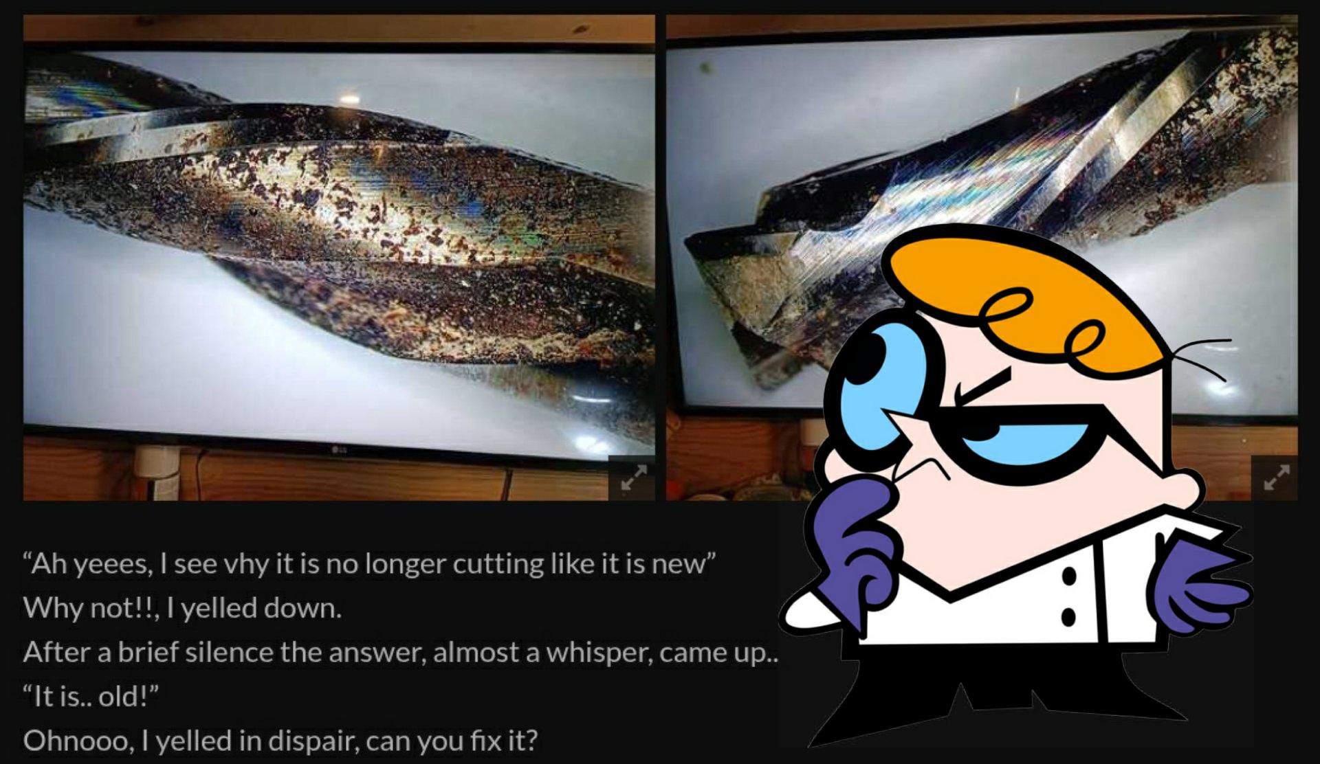

“No, I need to Jump to dry these pictures I made with ze Instant Nanomilicrometer Camera!”, he came to a stand still, looked at the pictures in his hand and smiled ear to ear. “LOOK”, he repeated and handed over the scientific evidence.
“Ve vill be for ever Young!!”, he cheered and ran off, leaving me with the pictures, still hugging Teddy. (For the last time)
 ![photostudio_1751224101907](https://forum.sienci.com/uploads/default/original/2X/1/14d809e688b129ac399d971be93ddb8ca58a2da0.jpeg)

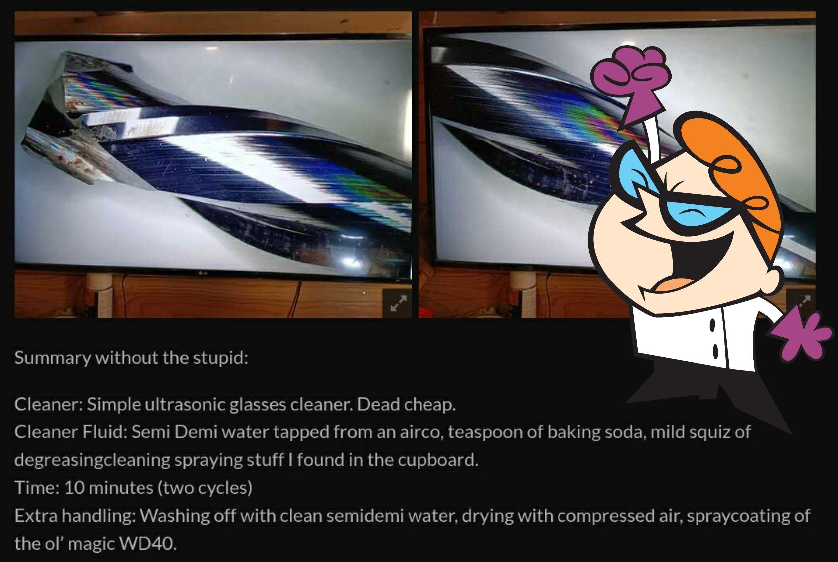

**Post date:** [June 29, 2025, 12:34pm UTC](https://forum.sienci.com/t/ultrasonic-endmill-cleaning/17904/3 "2025-06-29T12:34:38Z")
That seems like a viable solution /pun too. Dexter wants it!

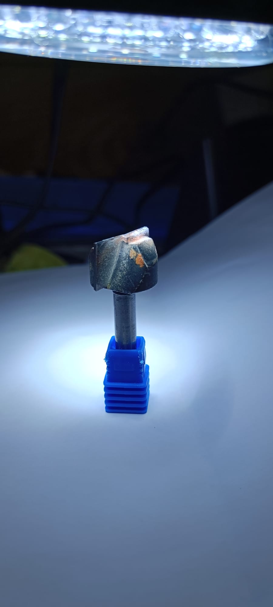

We use whatever we have at our disposal. I had this ultrasonic cleaner sitting there for a good year and that poor mill for even longer. Mums magic box does the trick and now it will go in overdrive. I have a few mills in bad shape and one cannot inspect for chipouts while they are covered in pine blood.
Next up, My surfacing bit.
