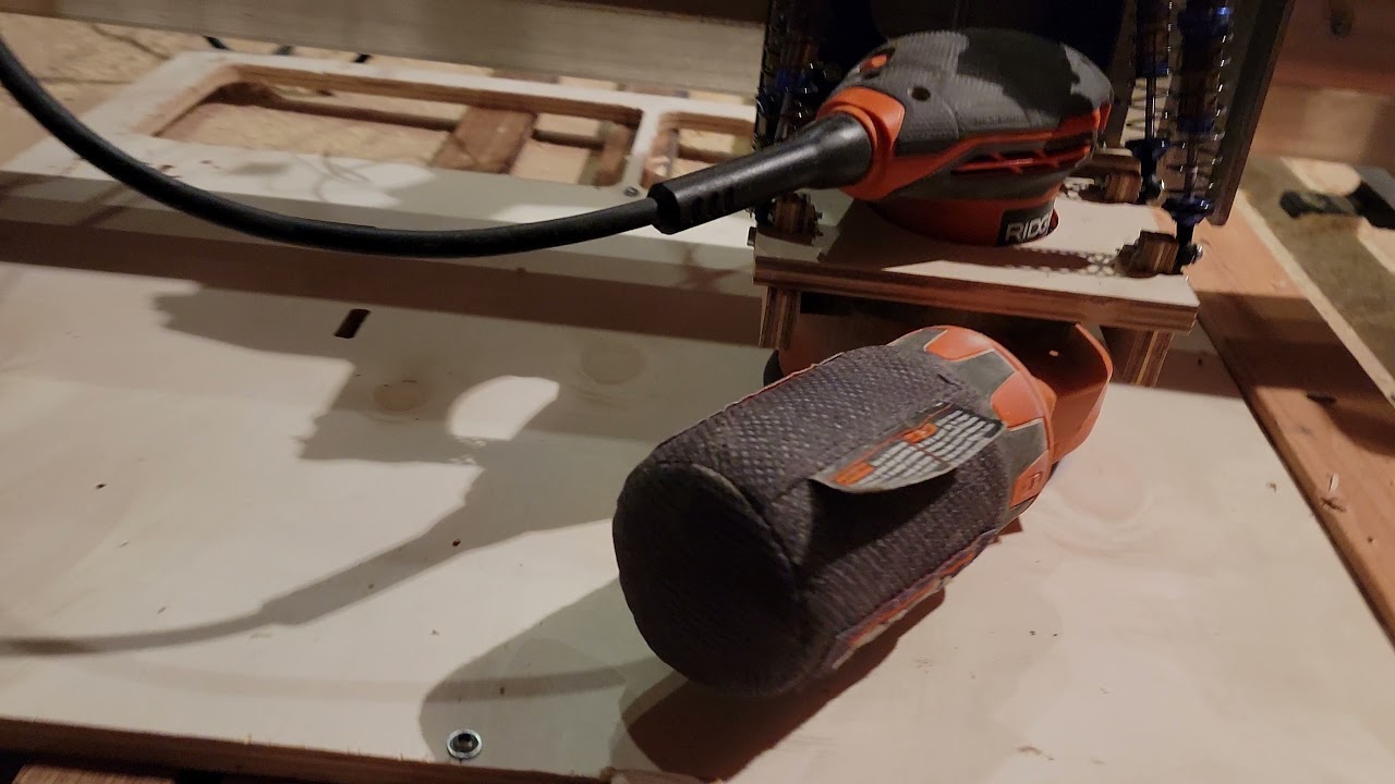

I can’t currently afford a drum sander so I’m trying to get creative with time management.
Has anyone tried using the Longmill with a random orbit sander to make a sanding robot? The software side is easy, a surfacing program with a 5" bit set to slow speed.
I have some ideas for a mounting bracket including some that I have come across online, but was looking for some neutral input from this community.
Thoughts?

Thanks! I have seen that video and am designing something similar. The part that is stumping me is how to attach it to the z axis sub-assembly.

@mid_al You could consider attaching it to the router mount. Remove the front piece of the router mount, and use the 2 x 5mm holes in the mount to hold your new bracket. **PLEASE note, I am not recommending this**. I have no idea of the forces you will be applying to the router mount and how they could affect the linear guides of the Z axis or any of the other moving parts. I merely throw it out there for consideration.

What about just using a sanding disc in the router?

I had considered this, but was worried about swirl marks. I had tried something similar using dremel bits to clean up bowls, but it had its problems. Mostly, there was no give in the bit. I broke one and scratched several test peices. The metal rod would poke through. I am almost finished my prototype. I’ll upload some video tomorrow once I finish it.
**Author:** ![mid\_al](https://forum.sienci.com/letter_avatar_proxy/v4/letter/m/cab0a1/32.png) [@mid\_al](https://forum.sienci.com/u/mid_al)\
**Post date:** [December 22, 2021, 12:11am UTC](https://forum.sienci.com/t/using-the-longmill-as-a-sanding-robot/4630/8 "2021-12-22T00:11:10Z")
![Screenshot_20211221-190901_Chrome](https://forum.sienci.com/uploads/default/original/2X/0/00cd4cef0dfb344490abf861c76c5c8acaa1a0a4.jpeg)
Here is part of the jig. I also have four 4" shock absorbers and two small brackets to attach the shocks to the router cradle on the z.

It works!

I used the 2 inch sanding disc, it worked great. Haven’t figured out how to send attachments on reply’s or I’d send the video I took of it.
I ran a 3 surfacing tool path with different angle’s each with only a 0.005" cut depth with 3 passes.
It worked really good until the very last pass and GSender had one of it’s random ‘Hard Stop Error’s’ and stopped moving, left a burn mark before I could shut it down.
I used it on raised panel cabinet doors. I still used my orbital sander for the finish work, which you’d want to do even with a drum sander for the finer grit sanding.
