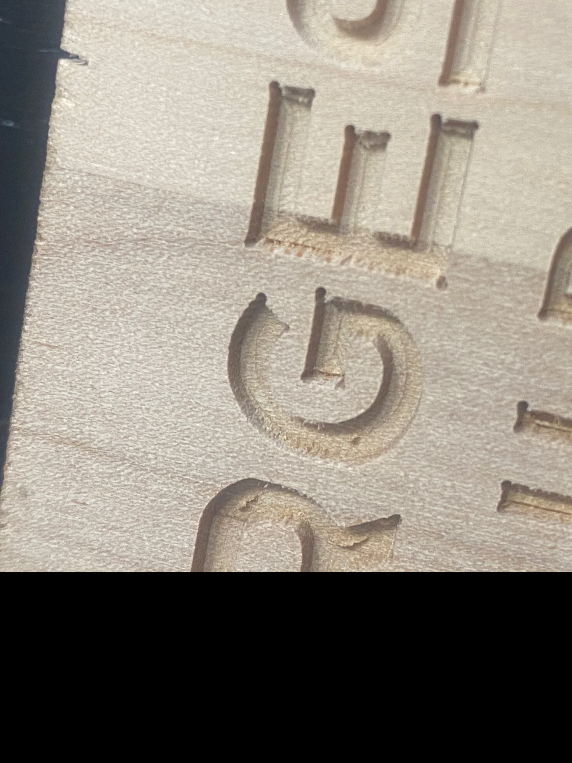

I got some problems with v-carving. I made a lot of this logo (15) without any issues. I use Vectric Aspire
 ![image](https://forum.sienci.com/uploads/default/original/2X/b/b9a105baf0b8bae66f54a89f18926db810f03045.jpeg) the corners of letters aren’t sharp and it’s ugly when I pour epoxy into it. Size is 1/2" height.
I use a 30degrees carving bit (from sienci).
Depth : 0.1"
Stepover: 4%
Feed: I try from 100ipm to 20ipm
Plunge: I try from 65ipm to 10ipm
I check and clean each V-Wheels, clean and lube linear rail and lead screws.
Any idea

@GuillC -
Did you use a pocket or vcarve toolpath?

V-carve or quick engraving in Aspire
Both made the same issue
**Post date:** [March 14, 2022, 3:29pm UTC](https://forum.sienci.com/t/v-carving-issue/5382/4 "2022-03-14T15:29:49Z")
@GuillC You mention that you’ve done 15 of these without issue. What changed?
