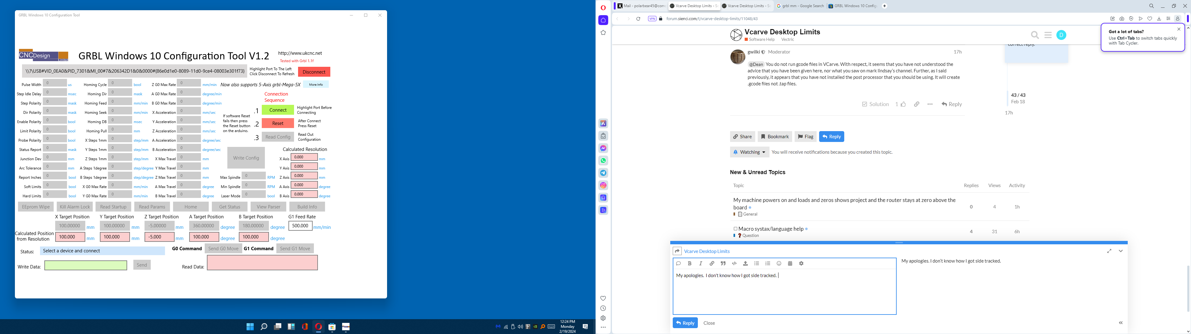

My apologies. I don’t know how I got side tracked. Am I suppose to be getting something like this for
grbl mm? If so I will try to get it installed.
 ![Screenshot (44)](https://forum.sienci.com/uploads/default/original/2X/5/57eaa9712606be21758dfb26329ca7eaa0c30e99.png)
**Author:** ![CrookedWoodTex](https://forum.sienci.com/user_avatar/forum.sienci.com/crookedwoodtex/32/10446_2.png) [@CrookedWoodTex](https://forum.sienci.com/u/CrookedWoodTex)\
**Post date:** [February 19, 2024, 9:23pm UTC](https://forum.sienci.com/t/vcarve-desktop-limits/11048/45 "2024-02-19T21:23:37Z")
Dean, the post processors are located within Vcarve Desktop. There are menu items where you can edit one. You would also choose the correct post processor when you “save” your design within Vcarve Desktop.
