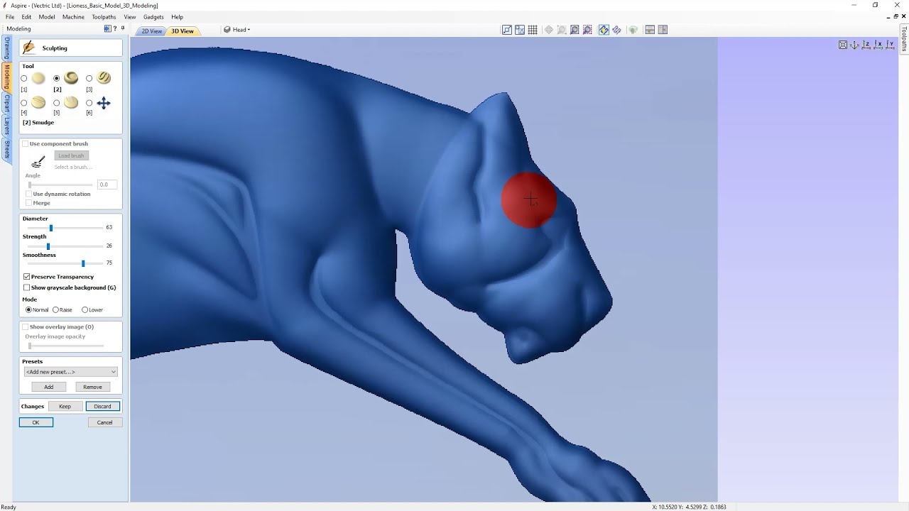

Here is a YouTube link from Vectric of the clay modeling
[![](https://img.youtube.com/vi/5weFtxgFnwo/maxresdefault.jpg "Lioness | Vectric V11 Tutorials") ](https://www.youtube.com/watch?v=5weFtxgFnwo)
I am going to go back and watch your link - thanks for getting back with me.
**Author:** ![MikeW](https://forum.sienci.com/letter_avatar_proxy/v4/letter/m/7ba0ec/32.png) [@MikeW](https://forum.sienci.com/u/MikeW)\
**Post date:** [July 7, 2023, 6:04pm UTC](https://forum.sienci.com/t/vortex-and-software/9284/4 "2023-07-07T18:04:05Z")
@_Michael Meshroom- wow mind blown that is amazing.
**Post date:** [July 7, 2023, 6:08pm UTC](https://forum.sienci.com/t/vortex-and-software/9284/5 "2023-07-07T18:08:19Z")
She is using Aspire, ~$2,000 US, and I think you need it for those modeling tools.
Quote from Vectrics website.
> Aspire gives you all of the functionality of VCarve Pro but adds 3D design tools to enable you to create your own 3D reliefs.
You can import a model into VCarve Desktop if you use another program to create the STL. [Blender](https://www.blender.org/) is an amazing free and Open Source application. It has clay modeling and a ton of other stuff. It has a Mac version. It takes a while to learn but you can model anything in Blender. It’s been used for cartoon shorts, special effects in commercials and tv etc.
