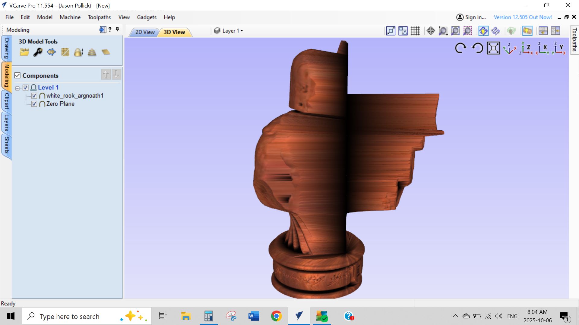

Trying to carve an LOTR chess set. Most of the pieces carve just great, but then I get to the piece below which is off-center and has an extended hand. This is causing all sorts of havoc, including “dead space” that doesn’t carve. Can anyone suggest a workaround?

Sounds like you are experiencing some **overhang,** which is an inherent limitation for the Vortex. You can read a bit more about it [HERE](https://resources.sienci.com/view/vx-second-project/#limitations-of-wrapped-rotary-carving). You can play with the orientation of the model a bit to eliminate as much as possible, but you may have to devise another plan to remove the excess under the arm.
Good luck!
