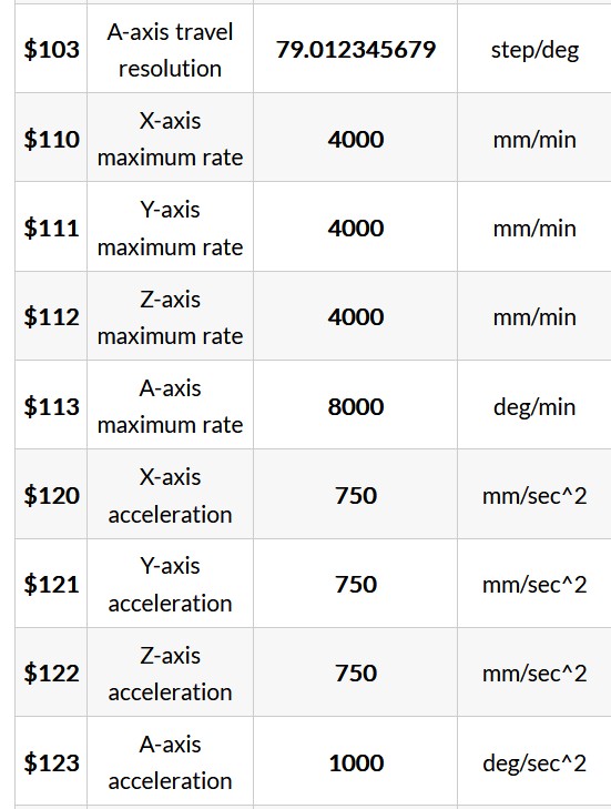

Been a while since I’ve tried to use the vortex, pulled it out to engrave some glasses but the rotation is way off. I’ve triple checked the closed loop stepper motor pin configuration, motor resolution value, 4th axis selection but I still get more than four times the revolutions than I should get. If I enter 90 in the gsender box and click the a-axis button it moves more than 400 degrees. I’ve had this issue before and solved it by reverting back to a earlier version of gsender (back to the 1.3xx series). I am currently using 1.56 with an alt-mill mk2. Is anyone able to get their vortex closed loop working with 1.5.6 on an alt-mill 4th axis configuration?

**I’m using 79.012345679. In the motor tuning area they only allow for X,Y,&Z. A is not an option.**

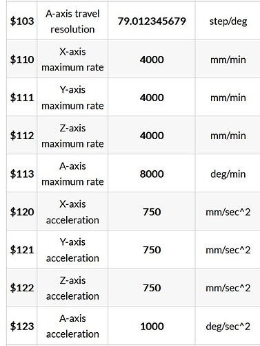

@jpnharris The AltMill SLB-ext must be different from the SLB. I have the SLB on a Longmill and there are 3 firmware values for the A axis. $103, $113 and $123. Are you saying that the SLB-ext has none of these?
 ![A axis firmware settings](https://forum.sienci.com/uploads/default/original/2X/8/82d0f712702e5e6d3da25a7c702c974edaba121e.jpeg)

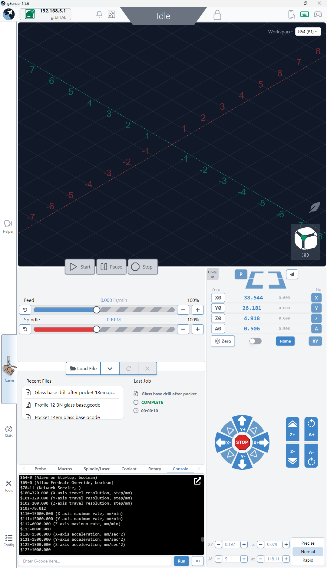

My $103 shows 79.012 although when I enter it into the console command I use the entire 79.012345679. However when I enter it into the console I just get an OK response, no confirmation like I see in the instructions.
**Post date:** [December 17, 2025, 9:17pm UTC](https://forum.sienci.com/t/vortex-rotational-issues/25216/9 "2025-12-17T21:17:09Z")
@jpnharris In console, you do not get a confirmation. Just enter $$ in console and hit enter. Check to see that $103 is set to.
**Author:** ![jpnharris](https://forum.sienci.com/letter_avatar_proxy/v4/letter/j/bbce88/32.png) [@jpnharris](https://forum.sienci.com/u/jpnharris)\
**Post date:** [December 17, 2025, 9:48pm UTC](https://forum.sienci.com/t/vortex-rotational-issues/25216/10 "2025-12-17T21:48:42Z")
79.012, not sure if you can see it in the screen shot below
 ![image](https://forum.sienci.com/uploads/default/original/2X/6/69bad2f050886e454cec8fa696b43df89d58a585.png)
**Post date:** [December 17, 2025, 10:02pm UTC](https://forum.sienci.com/t/vortex-rotational-issues/25216/11 "2025-12-17T22:02:09Z")
@jpnharris I can see the $103 value. So, if I understand what you are doing, you are setting A0. Then you are entering A90 to have it turn 90° and it is turning 400°. Correct? Is the GUI showing 400 or 90?

**Post date:** [December 18, 2025, 3:59am UTC](https://forum.sienci.com/t/vortex-rotational-issues/25216/12 "2025-12-18T03:59:53Z")
GUI is showing 90 degrees
