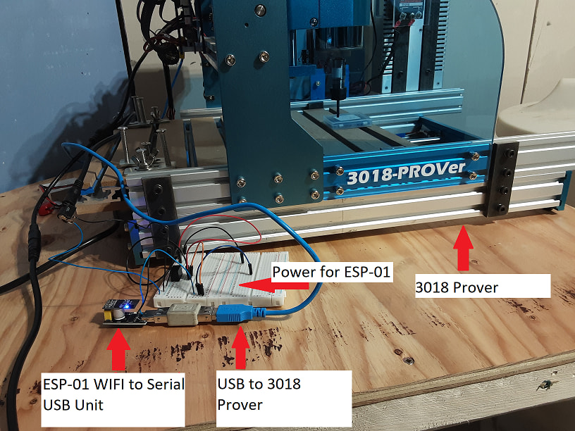

I know that this is a SCIENCI forum, but I want to use gSender with a Sainsmart 3018 Prover and a WIFI link instead of a physical USB cable. I am have some trouble, and am wondering if anyone else has tried this.
 ![image](https://forum.sienci.com/uploads/default/original/2X/7/79d31ca7bb26b09dff337a9b06bf03b9a14bd49a.jpeg)
I want to get rid of the USB cable from my PC to my Sainsmart 3018 Prover. I know that they sell a unit, the GGW-USB, that will do this, but it only works with the Genmitsu app, and I want to be able to use it with gSender.
I built and programmed an ESP-01 WIFI to Serial USB device. I set my router to fix the address of the ESP-01 to 192.168.1.103:23. I tested it extensively with YAT (Yet Another Terminal). I could open a terminal on 192.168.1.103 port 23, and when I plugged it into a USB port, it recognized and I could open the COM port on my PC in another terminal using YAT.
At this point, I could send text messages back and forth from one terminal to the other, transparently. It worked perfectly.
When I connected my 3018 to my PC with a physical USB cable, it worked perfectly with gSender. When I connected the 3018 to my WIFI to Serial USB device, it did not work. I found this online:

This would indicate that the problem is in my CNC controller. I cannot understand why a physical USB cable works fine, but the WIFI to Serial USB unit does not. Of course, the first thing is to suspect the WIFI unit, but I have been doing electronics for a long time and I am reasonably sure that I got it right. I will keep testing, but I have run out of ideas and am looking for help.
Has anyone else tried this and made it work? What problems did you have along the way?

I did get telnet going. I can send serial data from IP address to COM Port flawlessly. The problem lies in the UART to USB Adapter.
I think, now, that my problem is not a matter of having a transparent serial to usb device.
I think that the problem is that the CNC machine is built as a USB Device, and my PC is a USB Host. When plugged into a Host, the Device handshakes a bunch of data with the Host. The Host decides what talking gets done after this.
The problem is that the ESP-01 UART to USB adapter is a **Device, not a Host!** So, when I plug my cleverly programmed Device into the CNC machine, which is another Device, there is no Host in the system! You cannot plug a Device into a Device and expect it to work.
So, there it is. Dead in the water. I have either to figure out how to turn the ESP-01 UART to USB adapter into a Host, or to rethink the entire project. I guess that my problem is that USB is so darned easy to USE that I gave no thought as to what was actually going on.
Back to the drawing board! Thanks to all for taking an interest in my problem. If I figure it out, I will get back you you with the solution.
