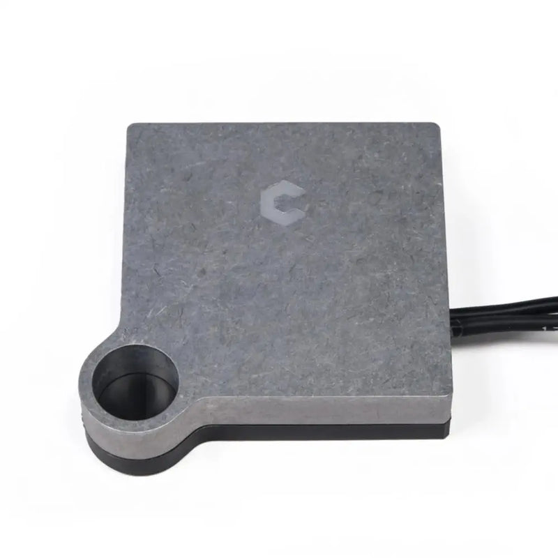

Is your touch block similar to this one?
 ![carbide-3d-nomad-3-bitzero-v2-1-28115582](https://forum.sienci.com/uploads/default/original/2X/a/aaa600ea6af52946e0e3a26a162bee32a0e2ec0e.jpeg)
If so there is a setting in gSender to select a BitZero probe, Config-\>Probe-\>Touch Plate Type.
The way the BitZero touch plate is designed the center of the hole is at XY 0. I don’t have one to test but I’m guessing that setting will use a different probe routine that finds the center of the hole for XY and then, or maybe first, Z as normal. Not knowing if Z is done first or last I’m not sure where the bit should be at the start of the probe. The picture of the probe in the probe tab changes based on probe type but the BitZero type uses the AutoZero for the picture so that doesn’t seem to help.
Maybe that’s enough to get you pointed in the right direction and get it figured out.
EDIT: If I had to guess I think you would start with the bit partway down the hole or just above it for an XYZ probe. That’s seems like the logical way to program the routine. Any other way would risk missing the hole. I’d keep the stop button handy til you got it figured out just in case.
EDIT2: It occurred to me that I could test with the wrong block at least a little. I set my mill to use the BitZero with an XYZ probe. After the continuity test I hit the start probe button and the probe moved slowly in the -X direction without going down first so starting with the bit partway down the hole should be the way to go.
