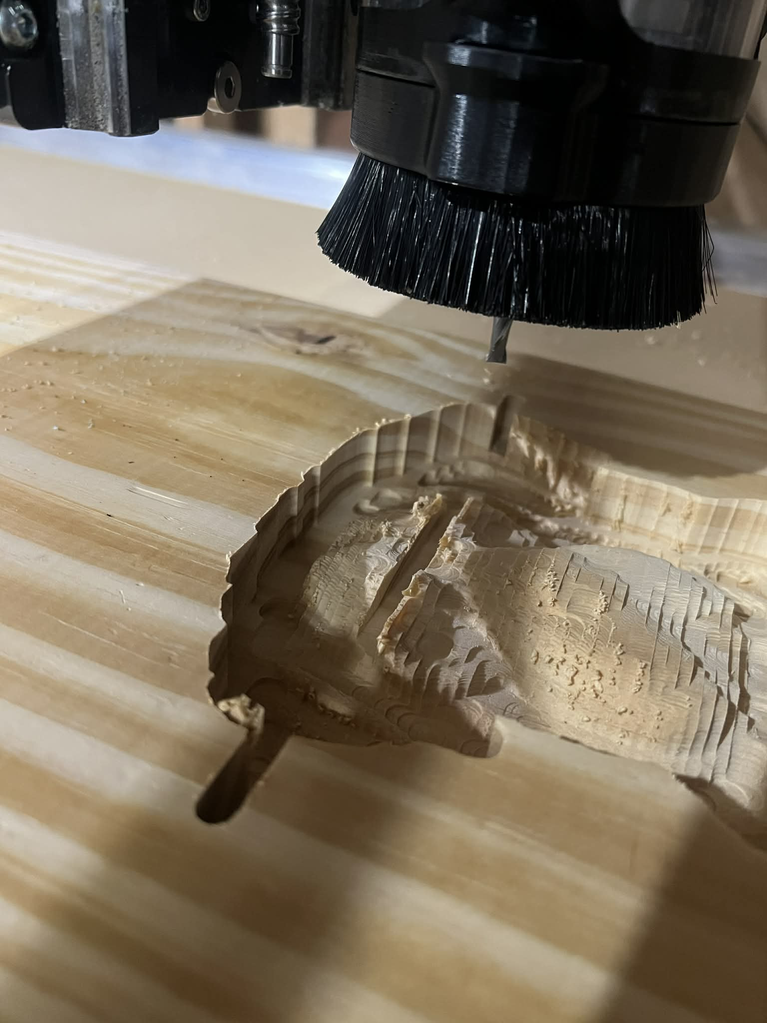

We have an odd issue going on where the machine will plunge the Z axis and then proceed to go back and fourth on the Y axis during a project at ungiven times, we have no faults in Gsender.
Yes we have ran the project twice, redoing the file in the process and making sure were exporting appropriately. Provided below will be the sample of Gcode where the error began and the picture of the result.
This happens during the roughing pass on 1.51in Pine using the 1.5Kw with a Spindle 1/4″ Flat Upcut 2Flute (edit) We’re using a AltMill 4x4
Any help is appreciated, thanks!

Goes fully outside of the model boundaries.
Second time we were able to replicate it but noticed it happened much sooner through the rough in process. We’ve only had this happen one other time an had disregarded it, hasn’t happened again until now many projects later.
did you power cycle the SLB between jobs?
I’ve had several instances that /really odd things/ happen that I can’t explain, that rebooting windows and restarting gSender don’t fix, but a hard power cycle of the SLB and everyone is friends again…
