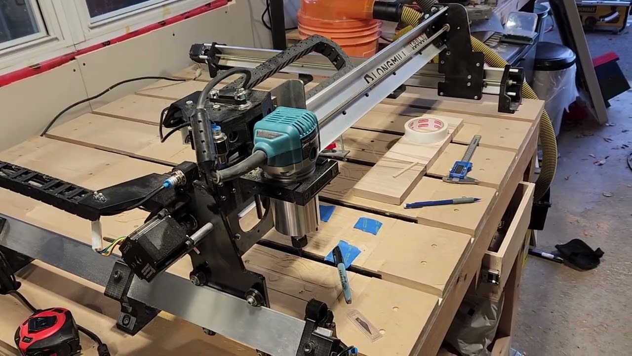

Im having trouble getting this fixed.
As you can see in the picture attached, i was drilling cibbage board holes and they arent lined up. (The picture looks turned, the pencil lines are running horizontal along the x-axis)
Vectric file, shows they are straight.
I ran the calibration tool in gSender and was out 1.3mm, I updated the settings to reflect the steps (per the recommendation of the calibration).
I also put the inductive sensors on previously and im not sure if that is causing the issue.
I updated the settings in gSender per the sensor page from the website.
Anyone have any thoughts?
 ![20221018_113915](https://forum.sienci.com/uploads/default/original/2X/3/3b3e2425410760195ce7cf66375c378b5efd8ce1.jpeg)

#### Post date: [December 10, 2022, 9:33pm UTC](https://forum.sienci.com/t/y-axis-out-help-please/7020/7 "2022-12-10T21:33:07Z")
Problem still persists…I’ve tried reflashing, calibrating multiple times and even went as far as re-mounting the longmill to the table.
It seems like one side of my y axis is movimg faster then the other…
I’ll post a short video I took that you can see my issue.

Have you tried checking or replacing your couplers or Delrin nuts? I’d try pushing your Y gantry back and forth and check for any looseness or rattling as well.
One of those parts might be slipping. If it’s a mechanical issue, reflashing will likely not help.

Looks like one of my couplers was loose. It seems to move better this time. I’ll do another calibration and test carve tomorrow and see where I’m at.
Do you mean the Delrin anti-backlash blocks? Or are the Derlin nuts something different? I can’t find Derlin nuts on the parts page.
