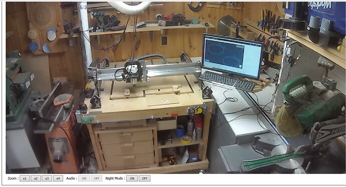

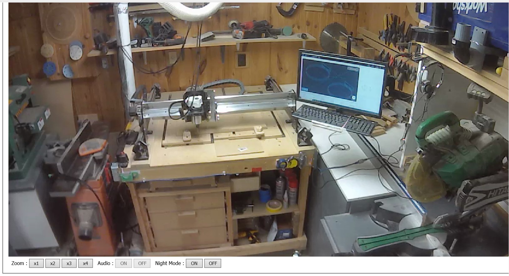

Mine is positively archaic compared to other setups. It does let me monitor my shop in a browser from my second floor office. I can also see the time remaining graph in gSender so I know when the job is finished. It’s not good enough to see the actual minutes left, but since it is almost always way off anyway, it really doesn’t matter to me.
The camera is a very old dlink isp camera connected with ethernet to my home network. I can pan and magnify, but it is very basic.
