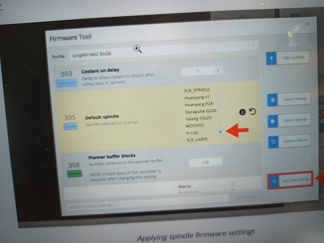

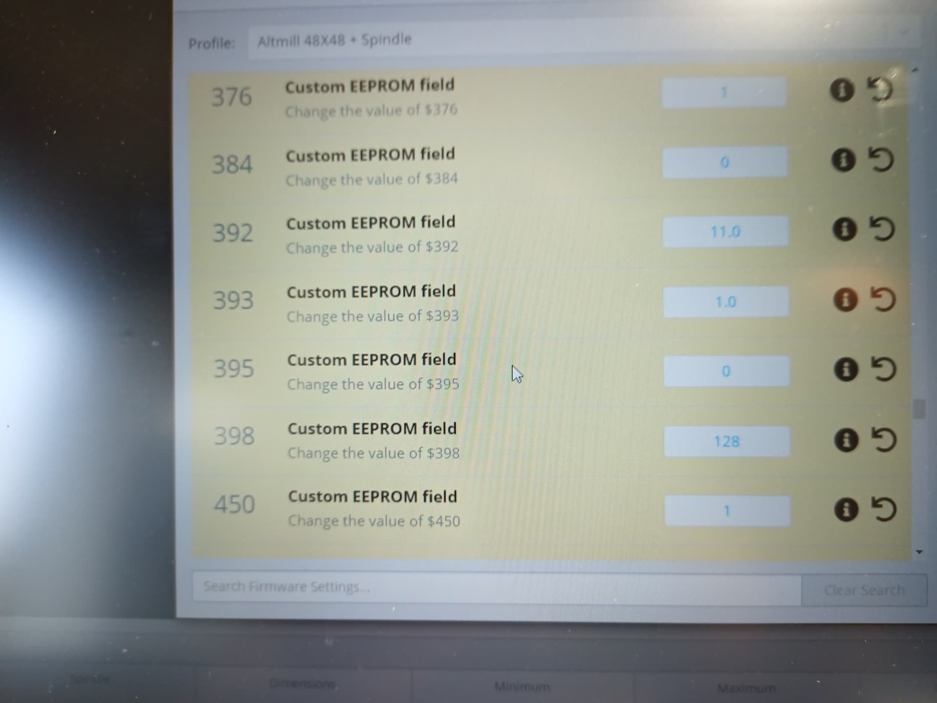

Have a new altmill i just finished assembling , can get all the motion from each axis but cannot get the spindle to fire up , even tried reloading gsender several times . The instruction pics in the guide are different from what i get in g sender menu in the latest version . The instructions dont seem to match
I think the “RESTART <insert SLB/VFD as appropriate> BY POWER CYCLING” steps in both the AltMill Spindle Kit Setup (https://resources.sienci.com/view/am-spindle-kit-setup/)and Unofficial Guide (Linked Above)are crucial.
I have tried that half a dozen times , even removing g sender and reloading it. idont get the same screen for the 395 to enable the H100 and says nothing about the spindle .
this is what i get in my gsender

@Walter when you make your initial connection to your machine, you need to make sure you select the right firmware in the dropdown. Make sure you click ‘grblHAL’ and not ‘grbl’. That’s the problem you’re having

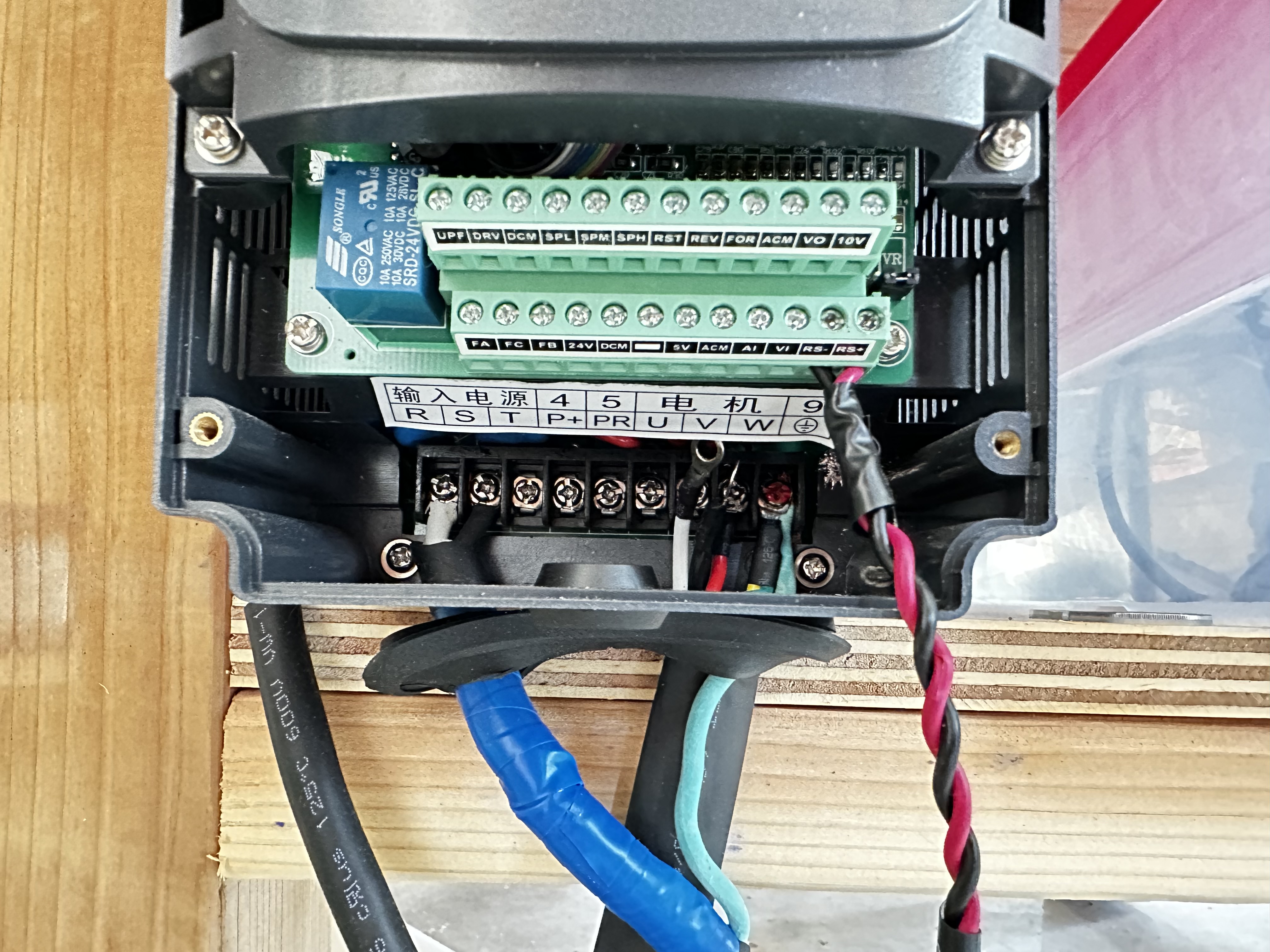

It’s been a while since I’ve worked on this due to work and life but I wanted to see if the Huanyang HY02D223B was compatible with the new instructions and if there are any limitations I need to consider.
It’s a 2 phase 2.2kw VFD but I couldn’t find how it relates to h100.
I’m in the middle of connecting my new spindle cable so don’t mind the U V W
@cncdm your VFD is an HY-type, so hopefully you should be able to follow this guide instead and get everything working:
