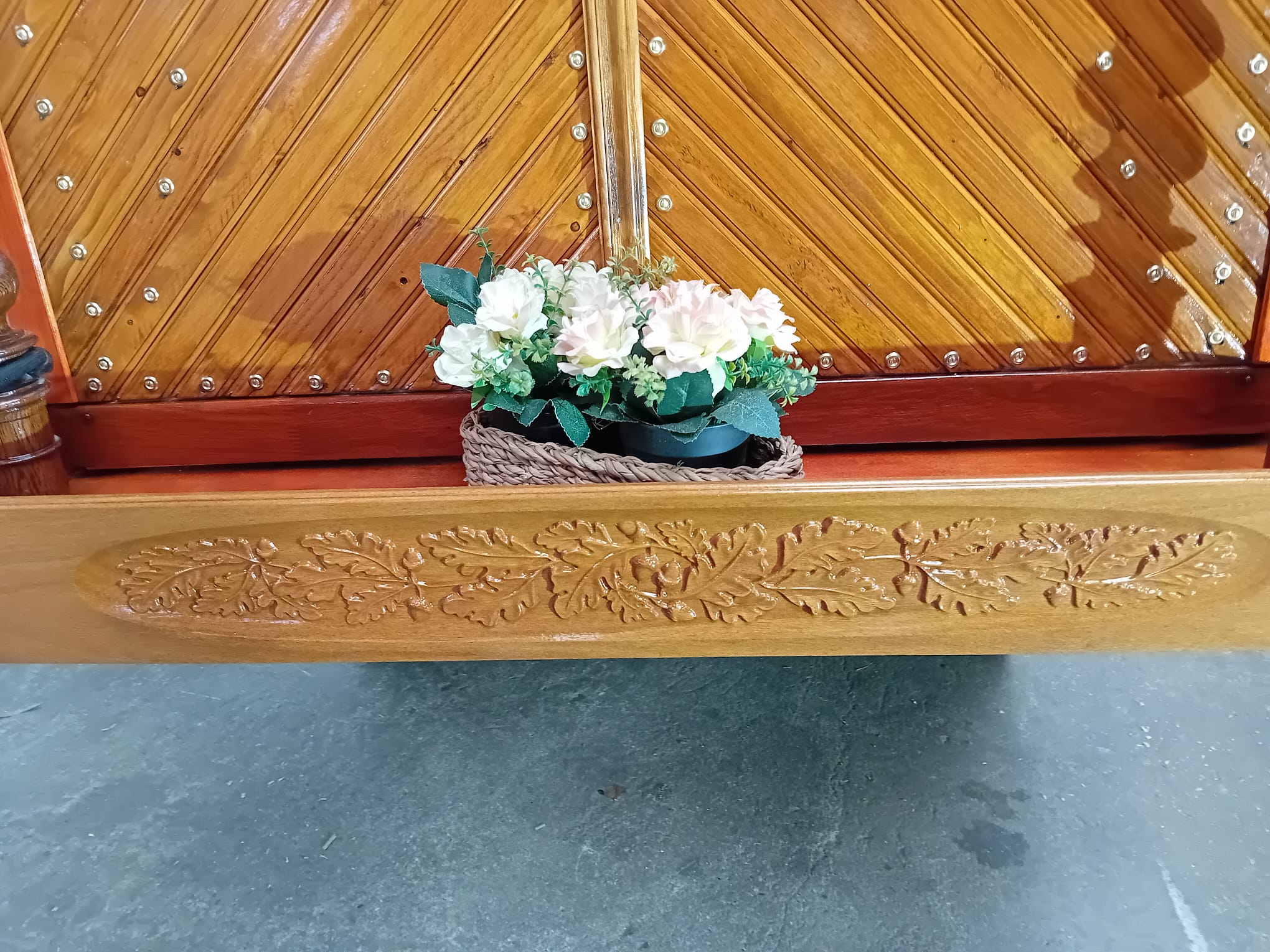

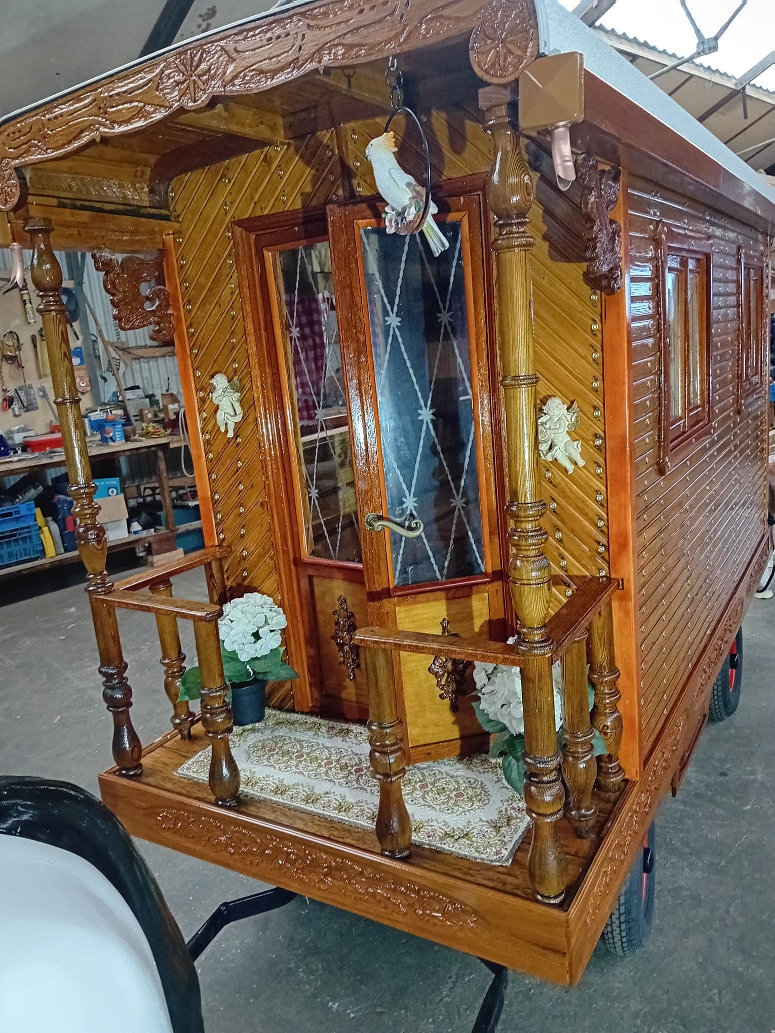

I have made a project using 3x 800mmx150mmish 3D carves on a 2.5 meter board in that time with time to spare. I did my roughing with a simple .25 upcut and my finish run with a 2.5mm tapered.
The boards were needed as a lower ornamental strip on a wooden “caravan”.
If I can pull that off using a longmill, running conservative feeds’n’speeds because there was nill room for error. You must be able to carve out your rose in .. don’t know but 7 hours.. 200x200.. with an Altmill.. nopenopenope.

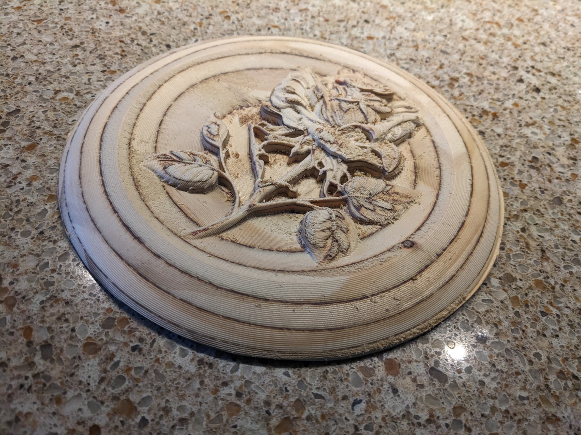

I brought it down to around 4 hours with a higher step-over but one of the side effects, because I was testing this on particle board, was a lot of little chunks breaking out. So, while the tool path was ok, the end result was disappointing.
Attempt two will be using plywood to see if that comes out better.

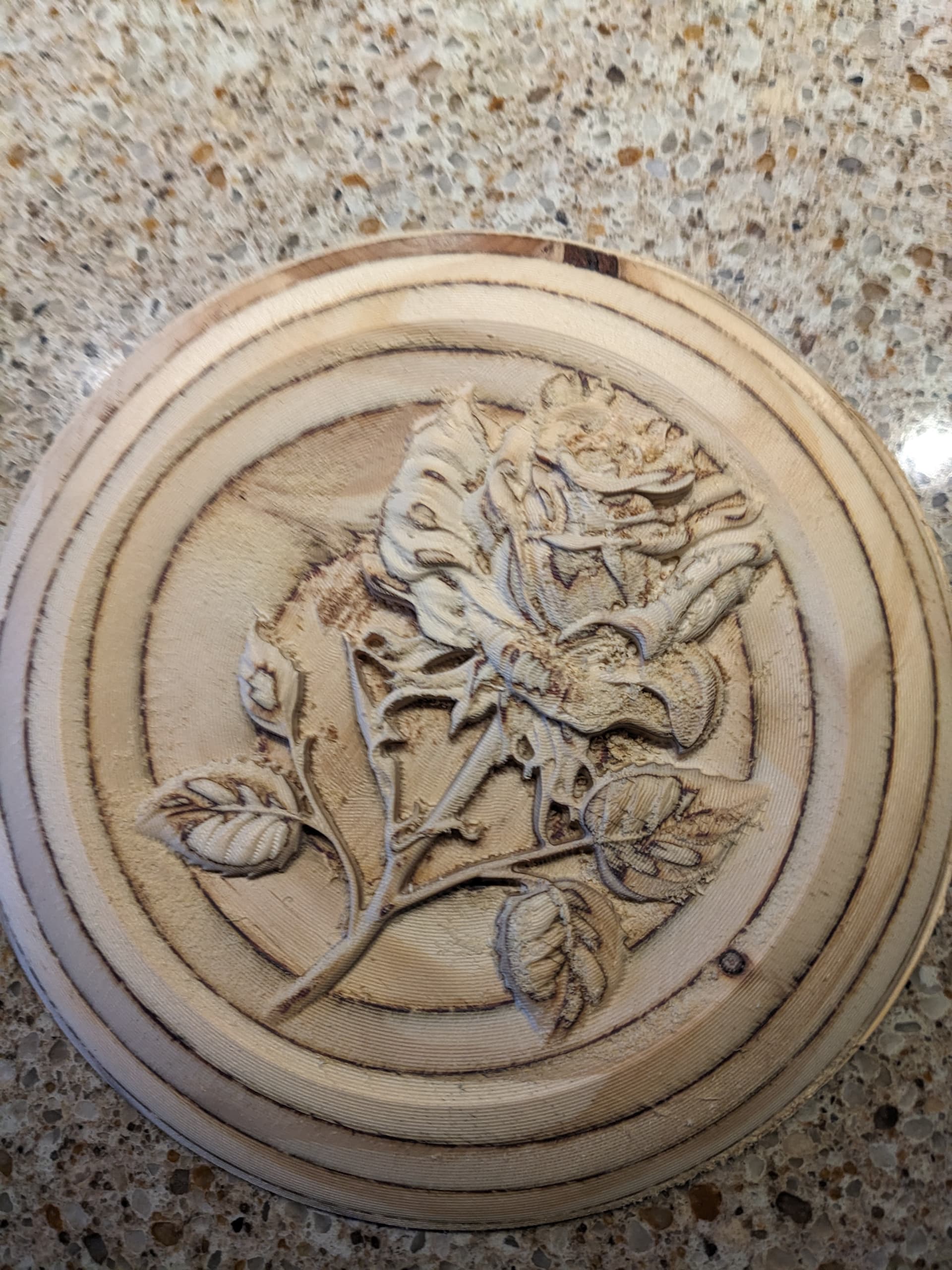

My second go around using plywood was HUGELY improved. The plywood is very old so it has no voids that showed up.
There are some fuzzies in tight corners that are kinda difficult to eliminate but other than that it looks pretty darn good.
I will see if I can find some solid wood for the final product
Ooooooh, that is awesome! It almost looks like a dried out rose from a long crumbled bridal bouquet. The layers from the ply make it realy pop.
A nylon or bras bristle will make easy riddens of the fuzzies in the tight corners.
I like your stamina Jens, not giving up, even after announcing you had given up. You’re a biter, aint ya?
A winner
@Jens Congrats on your success, Jens. What did you use for mills?
I used a 1/4 ball end mill for the first roughing pass, the same mill for a semi finish pass and then a tapered ball end mill with a 1/32 dia tip for the detail work.
