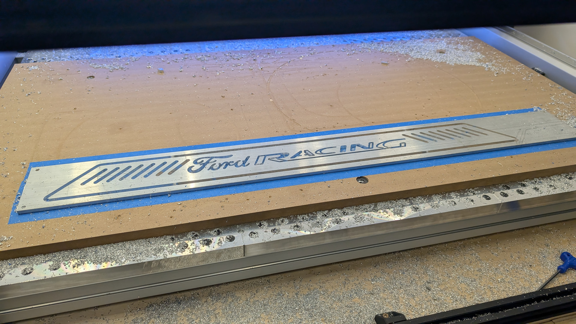

Absolutely start with MDF first, the aluminum fixture plate is great if you need to repeat jobs with custom made fixture plates. This is the main reason I made the plate, 90% of the work I do is repeat tasks, faster setup is a win.
In fact for anything that are random sizes. I still have a large MDF flex board I throw on. The added weight of the fixture plate helps with some dampening which is great.
@gabo another option is to use delrin for making the fixture plate. Easier to work with.
Here is a project I helped a buddy with yesterday on the MDF board I throw on and bolt down.
