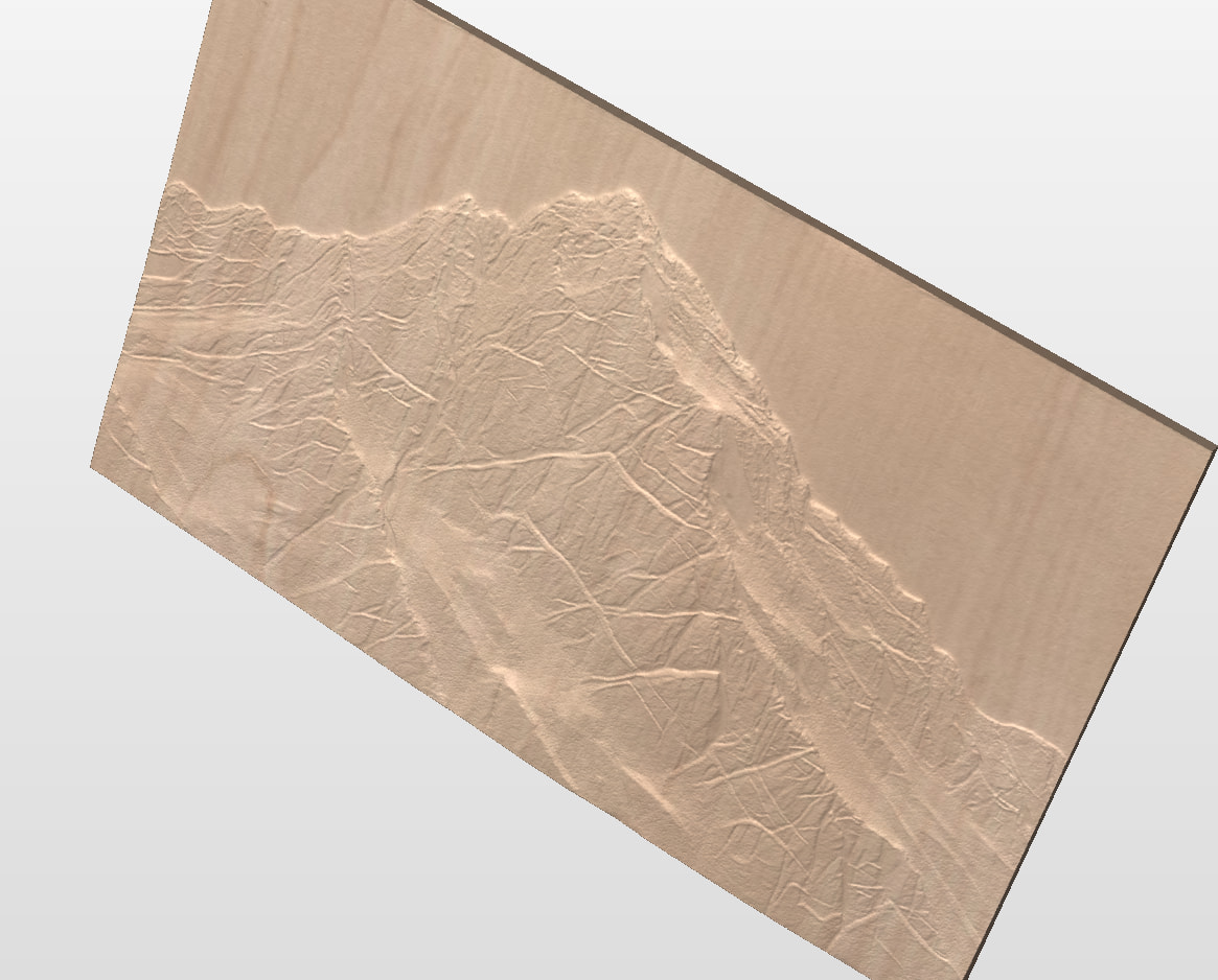

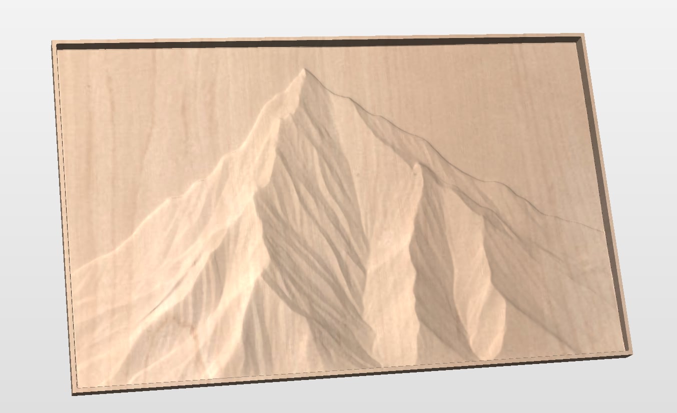

My daughter wants a large (29" x 48") wood carving of a mountain peak for her dining room. I created a model using Easy Create and now I’m working on creating the g-code with vCarve.
For those of you who have done 3D carves, which tool should be used to get enough - but not too much - detail?
For the finish pass, is a 1/4" BN mill with a 5% stepover enough? Or should I go with a TBN ? Or a 1/4" BN followed by a 1/8" BN? Lots of possibilities. The time estimates for a BN and TBN is 9hrs and 60 hours respectively. I’m thinking that for such a large carve, a BN should be sufficient.

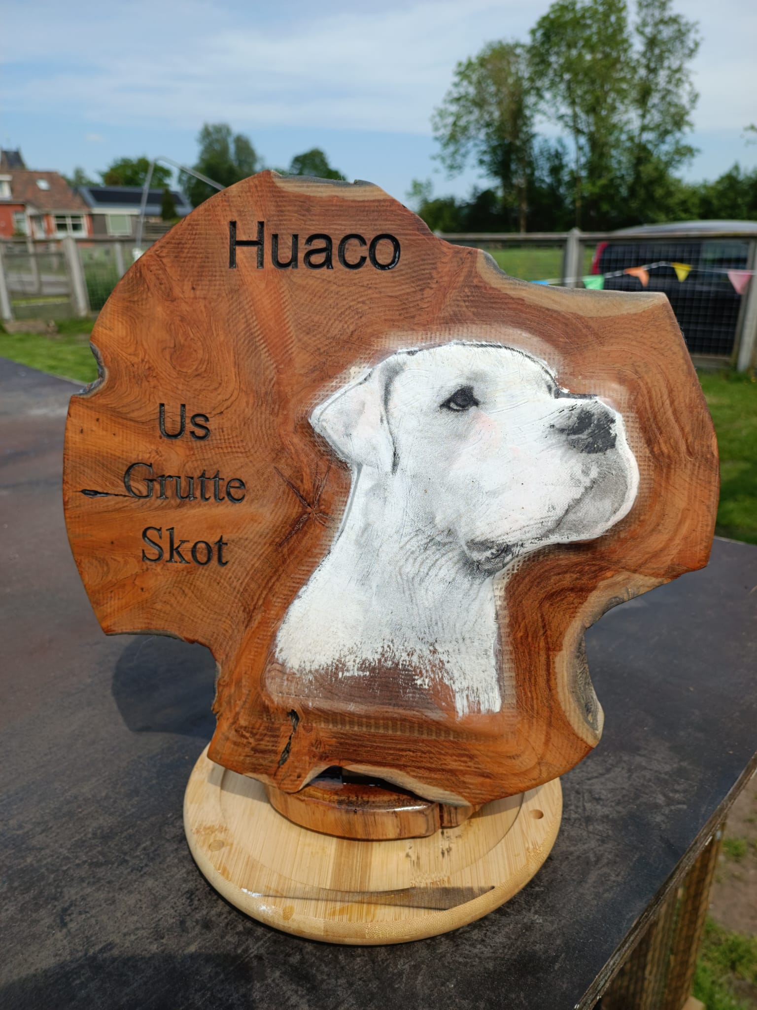

I have created 3d work using 1/4 inch only, lasering the details in. This dramatically cuts down (:roll_eyes:) on carving time. You do need a laser unit with a large focal range to get away with this technique in one pass though. I have found the results surpassing pure 3d carves, mostly because I apply a base layer of titanium rich paint that can be added a hint of color.
Since the early experiments doing this on 3d carves I eliminated the 3d part and only carve an outline pocket, paint it and laser it slightly on the dark side to totaly vaporise the paint and retrieve bare wood at the darkest parts of the picture.
If time is a problem, this is the fastest way to make something that has an unique look because.. well, this is the first time I mention it. Is it the same as a 3d carve, surely not, but it looks like nothing else I have seen done on a cnc combining wood and laser. If anything, it looks like a hand painted wood panel because.. at it’s base.. it is.
I have done pure 3d carves and had nice results using a tapered ball nose with 2.5mm tip. It was not the most crisp result but good enough for the time it took. (30-ish hrs for a total of 800mm by 800mm area)
The time vs result is the main reason I went into the painted pocket laser etch direction.

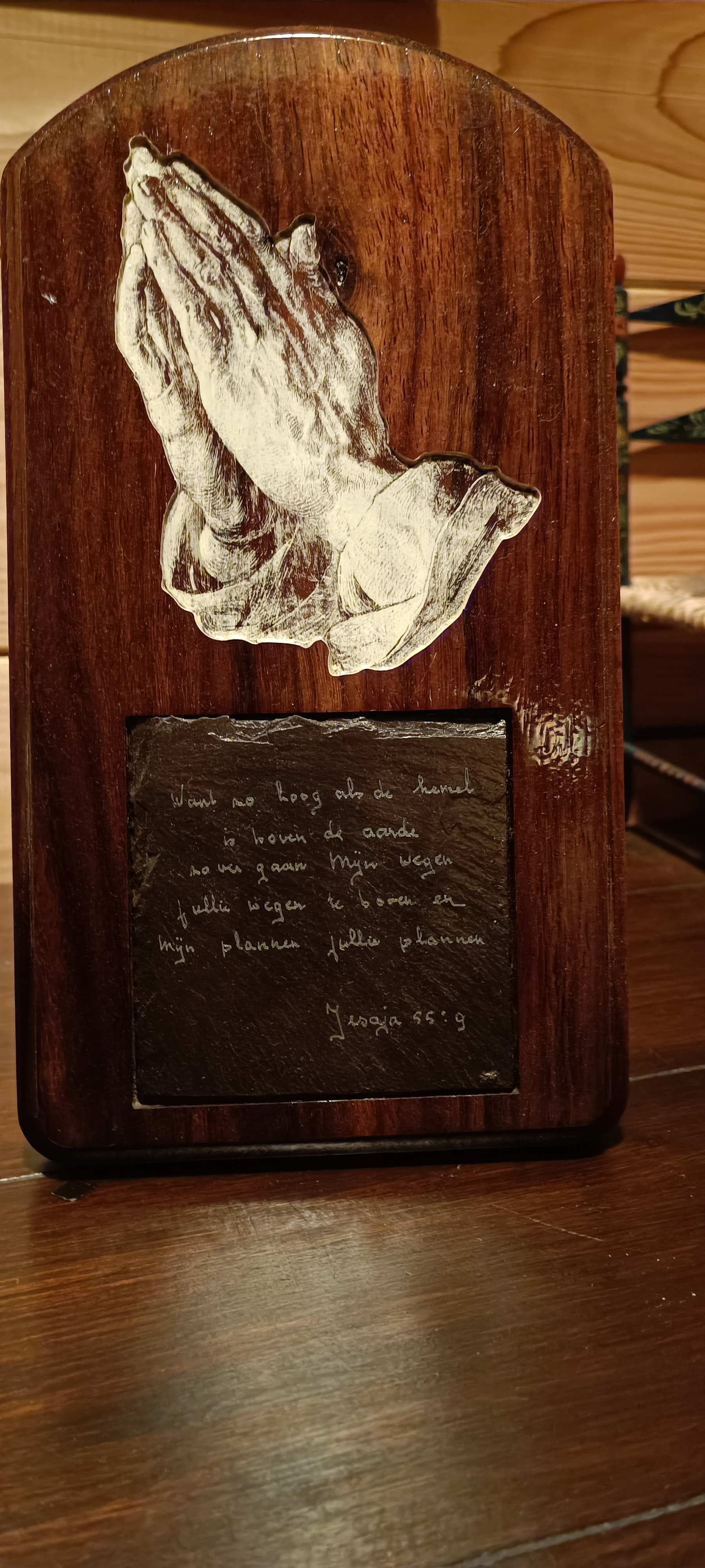

@Spamming_Eddie Unfortunately, I don’t have a laser. But I really like the distressed effect on the hands. I might just get a larger TBN and give that a shot. It’s another one of those “winter projects”. Spring finally has decent weather so it’s cottage time. And I have a building permit deadline to meet.
Didn’t you have a sharpy thingy that you could strap onto your machine? That might work as good, if not better than a laser (no base layer needed)

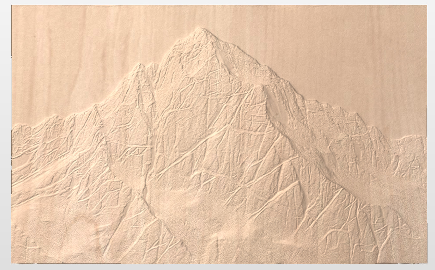

@jkculliton My daughter thought my initial model had too much detail. So I asked Easy Create to make a new model with less detail. She likes this one. The relief depth is 1". Overall depth is 1.5"

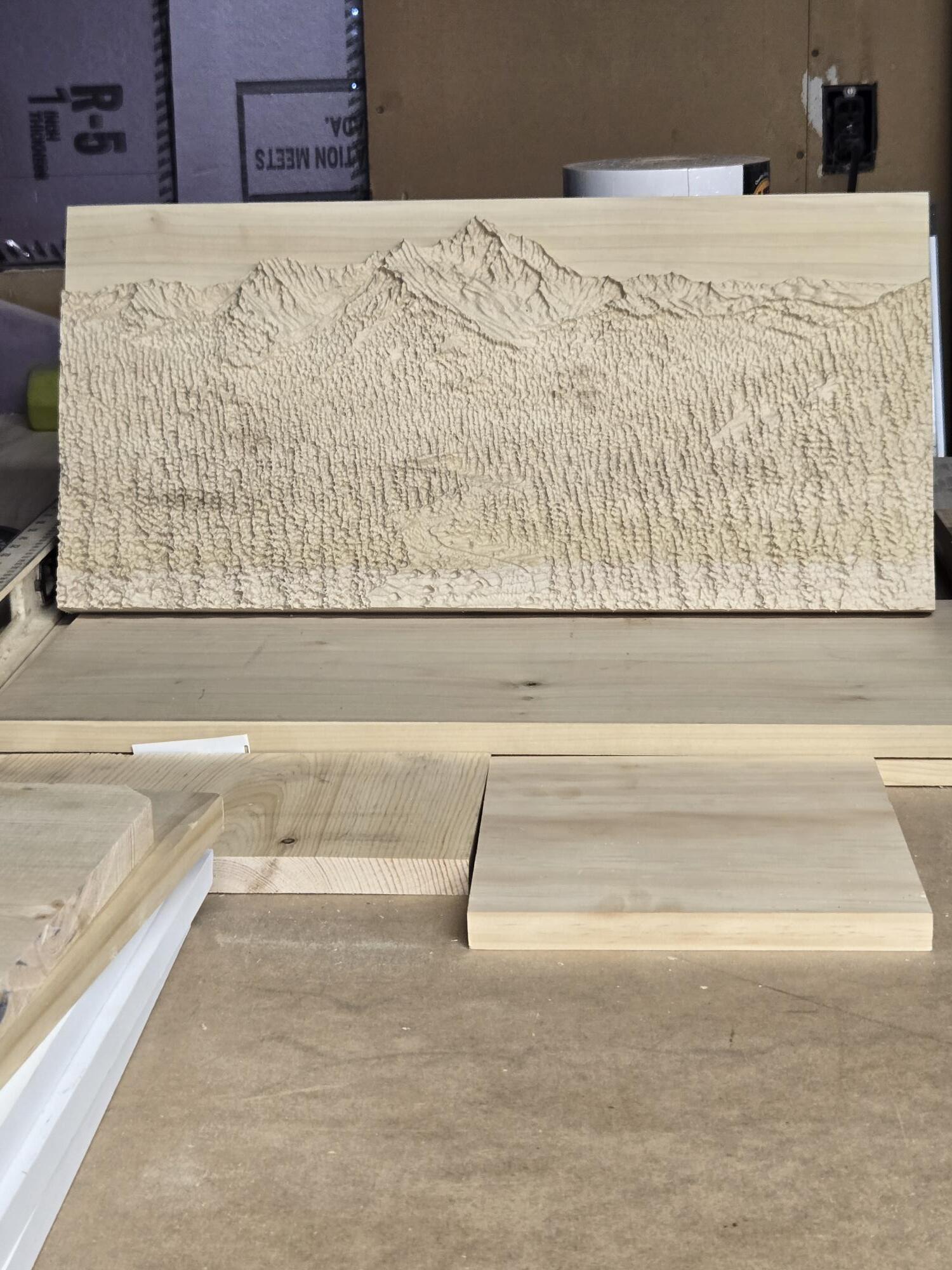

My cut was .9". Breckenridge CO.

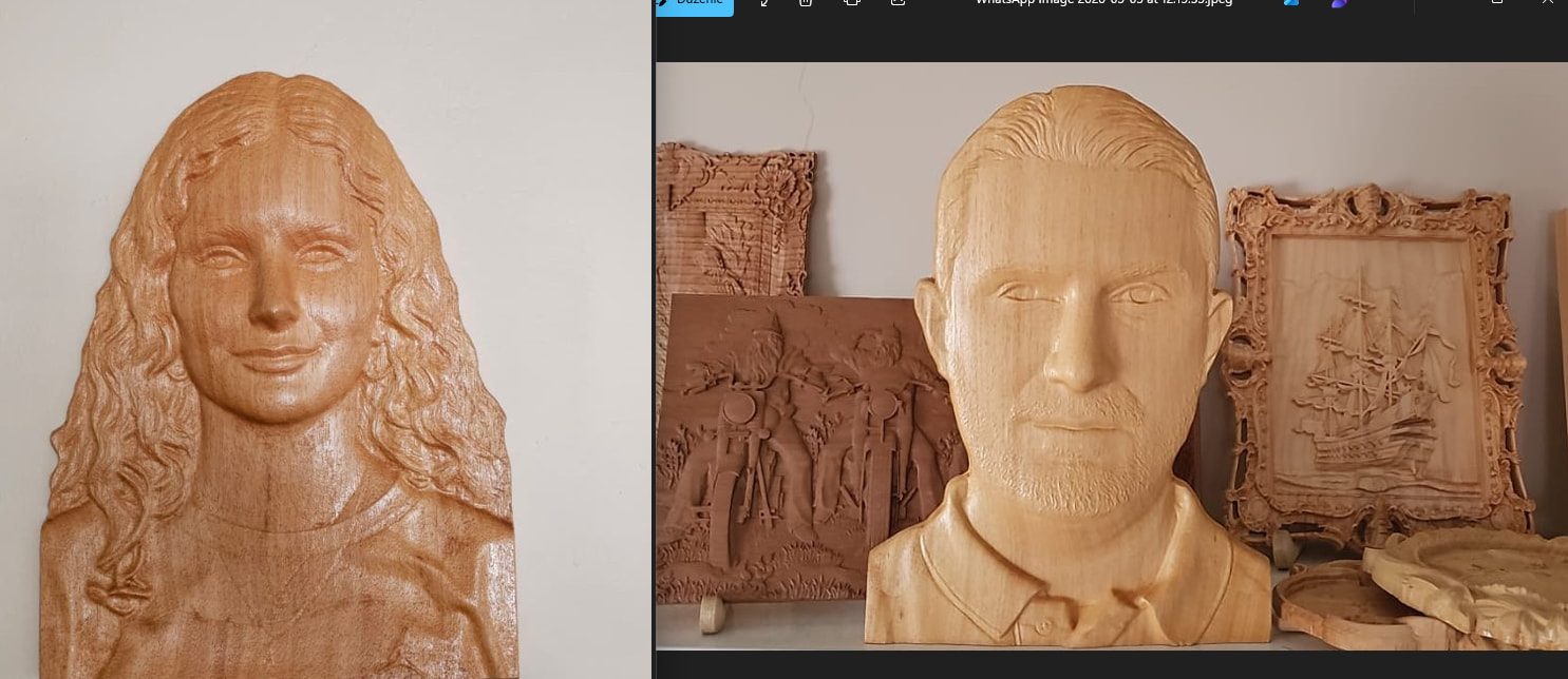

boyut önemli değil zamanınız varsa. kaba ißlemede boyut bĂŒyĂŒk diye 8mm 10mm ile girmeyiniz 6mm kaba boßaltmada yeterlidir . detaylarda tek sefer r1 veya r0.75 traped bal konik uç kullanın herßey detaylıca çıkar . ama bu boyutlarda zaman çok alacaktır kesintisiz gĂŒĂ§ kaynağınız olsun veya olası durmalar da kaldığınız yeri bulmak içinde ißlemin belirli yerlerinde satır sayılarını hep not ediniz. ben genelde 40x40 alanda insan resimleri ißliyorum bĂŒst olarak .

I used google translate to create an english version of your post. I have no way of determining the accuracy of this.
“Size doesn’t matter if you have the time. For rough machining, don’t use 8mm or 10mm bits just because the size is large; 6mm is sufficient for rough machining. For details, use an R1 or R0.75 trapezoidal conical bit once; everything will be detailed. However, this will take a lot of time, so have an uninterruptible power supply, or note the line numbers at certain points in the machining process to find where you left off in case of any stops. I generally work on human figures, busts, in a 40x40 area.”
