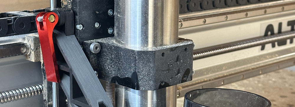

I agree on the usefulness of a 3D Printer. I got a Bambu X1C last November and have almost 1,500 hours on it. Here is my AltMill with a ZeeSlide independent Z-axis bracket along with a Modular Dust Collection 4” Magnetic Locking Hose Connection and Sienci Lab’s 80mm Clear Cut Dust Shoe.
ZeeSlide &  MDC Coupling

The Print NC looks ideal though a bit flimsy. Having the suction hose on the back is really the best as it’s vastly less likely to hit anything and is out of the way. Also doesn’t interfere with my laser mount.
How did you mount that thing to the z axis assembly?
The Shoe that holds the hose is attached to the two steel shafts that are clamped to the z axis. The whole this is quite rigid and has been working very well for me

I did buy the ZeeSlide but then realized I need the Clear Dust Shoe which is not available atm.

So I bought the ZeeSlide and printed in. I am actually very impressed with that guy’s CAD skills. The parts in PETG are rock solid. I always worry about 3d parts holding up but this thing seems really well designed. I’m currently trying to retrofit it to work with the PWN CNC version 7 dust boot since the Sienci boot is out of stock. I’ll post my frankenboot once I get it up and running. Some of the parts aren’t on Amazon prime…
I’m currently using the PWNCNC v12 which I had to modify to account for the cutouts Sienci made at the bottom of the spindle. It works great in terms of not interfering with my laser mount and not being so huge that it smashes into things like the original Sienci boot. However, it’s actually dust performance is a bit meh, especially with 1/4" cuts. It’s fine for finishing work.
