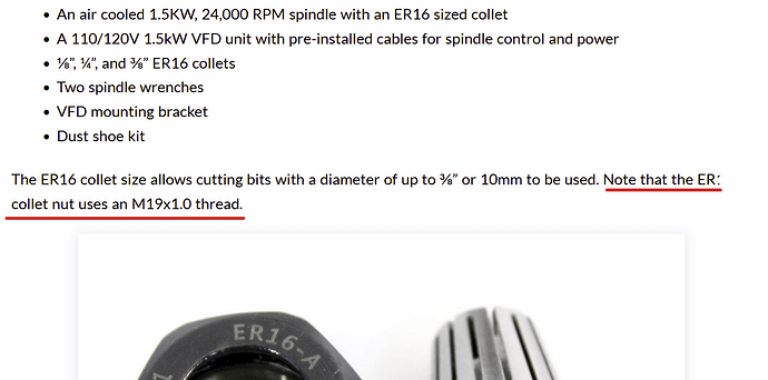

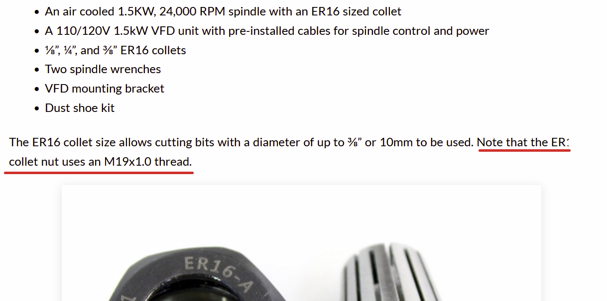

Only now that you flagged this with your topic, I have looked into it and have indeed found two distinct types of ER16 nuts. One with 19mm threads and one with 22mm threads.
Tugged away in the Altmill spindle kit product details it is mentioned but that is quick to be overlooked.

@JPlocher @Spamming_Eddie There are indeed two sizes of collet nuts. They are distinguished by their name. One is an ER16 and the other is an ER16A. Both take the same ER16 collet.

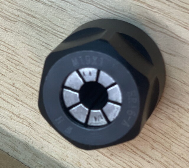

I checked the Sienci supplied spindle nut and it says it is an ER16-A
In small print (OK, it all is small print…) it also says M19x1
TL;DR - The Sienci supplied spindle (and the rapidchange ATC unit) use a M19x1 ER16A collet nut with ER16 collets. The key is the ā€œM19x1ā€ and not simply ER16 -vs- ER16A. M22x1.5 nuts will work with the collets (not that it does me any good…), but NOT with the Sienci spindle or the RapidChange ATC.

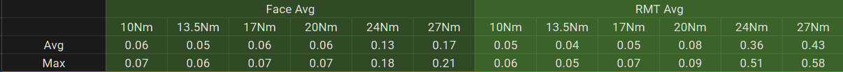

The second issue is how much torque is too little or too much for minimal runout. That I have some numbers on. We have been colleting it and will probably eventually put something up about it when we feel we have enough data. Here’s an example though. This is the average and max runout on the same ER16 1/4" collet with a mini nut and 6 different nut torques. In total it’s collected from 480 points of data. Not enough data points or on enough collets for our taste. But it gives a broad idea and other ER and bore sizes follow this pattern with the exception of high runout on the low side in some cases.:
These are at 2 different measurement points, the face at the front of the collet, and at 1" away from the face. The units are in thou (0.001"/ 0.0254mm). The last torque intentionally exceeded the max torque spec.
Both the slip resistance and the runout variation will change, potentially by a lot, based on the quality of the collet and and spindle bore. Or at least how well they match and the clocking.
All that said something that could produce between 11.5-28.9Nm on the nut is a wide range. It makes for too many extra variables for my tastes.
