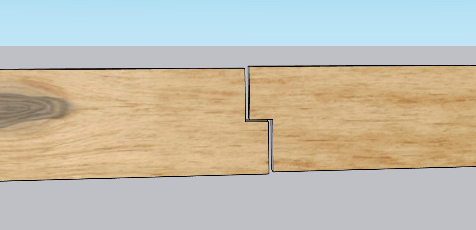

Finally assembled my Altmill and making plans to build a shelf for storage and to stabilize the legs. I am really struggling to decide how to attach the 2x4’s to the legs.
First, the diameter of the holes on the legs is 0.21”, so the biggest size bolt I can get through is an M5 or #12. This doesn’t seem like large enough bolt to support the weight of the frame and plywood top.
Second, the holes on the front and side of the legs are so close together that it seems I have to attach only the front or side 2x4’s to the table or perhaps miter them.
I am hoping to get some feedback from those who have tackled a shelf. What size bolts did you use? Did you only attach 2 - 2x4’s? I noticed that’s what Hamilton Dilbeck did, but I think he may have drilled the holes out to accept a bigger bolt.

If it was me, I would build a square frame and install it in the existing holes. A single M5 bolt in shear can likely hold up anything that you can stuff on a shelf.
Anyway, the key is (IMHO) to make a frame.

Several months later - Im using 3/4” thick x 3 1/2” maple stretchers for my shelf support. Im tackling the hole spacing problem by using lap joints so that the connection of each side of each rail piece will have three 5 x 30mm flat head head hex socket cap furnitures bolts (in black) going through them to hold them to the legs. Having three in each will help with any racking issues if any. Im also using stretchers in the middle to help support the shelf.
