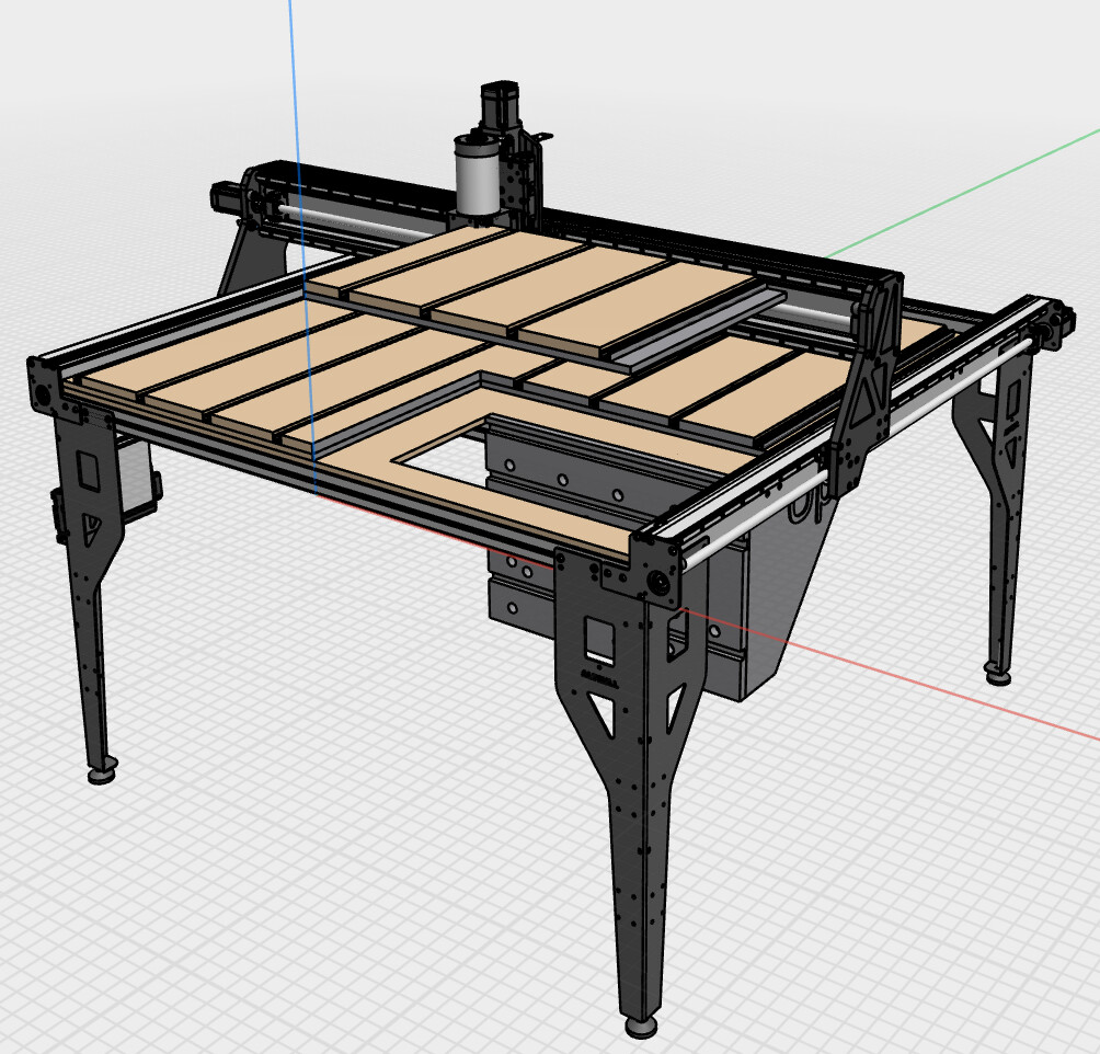

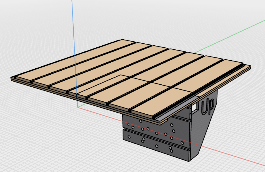

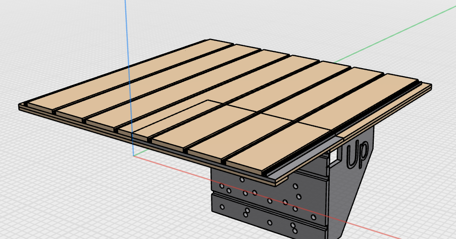

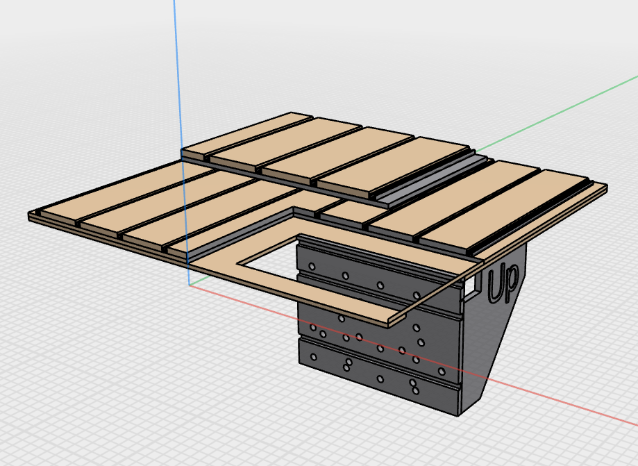

Hello all – sharing my initial design for a vertical clamping table for Altmill.
Have not finished in real life yet, so beware of mistakes I have not caught yet . . . :slight_smile:

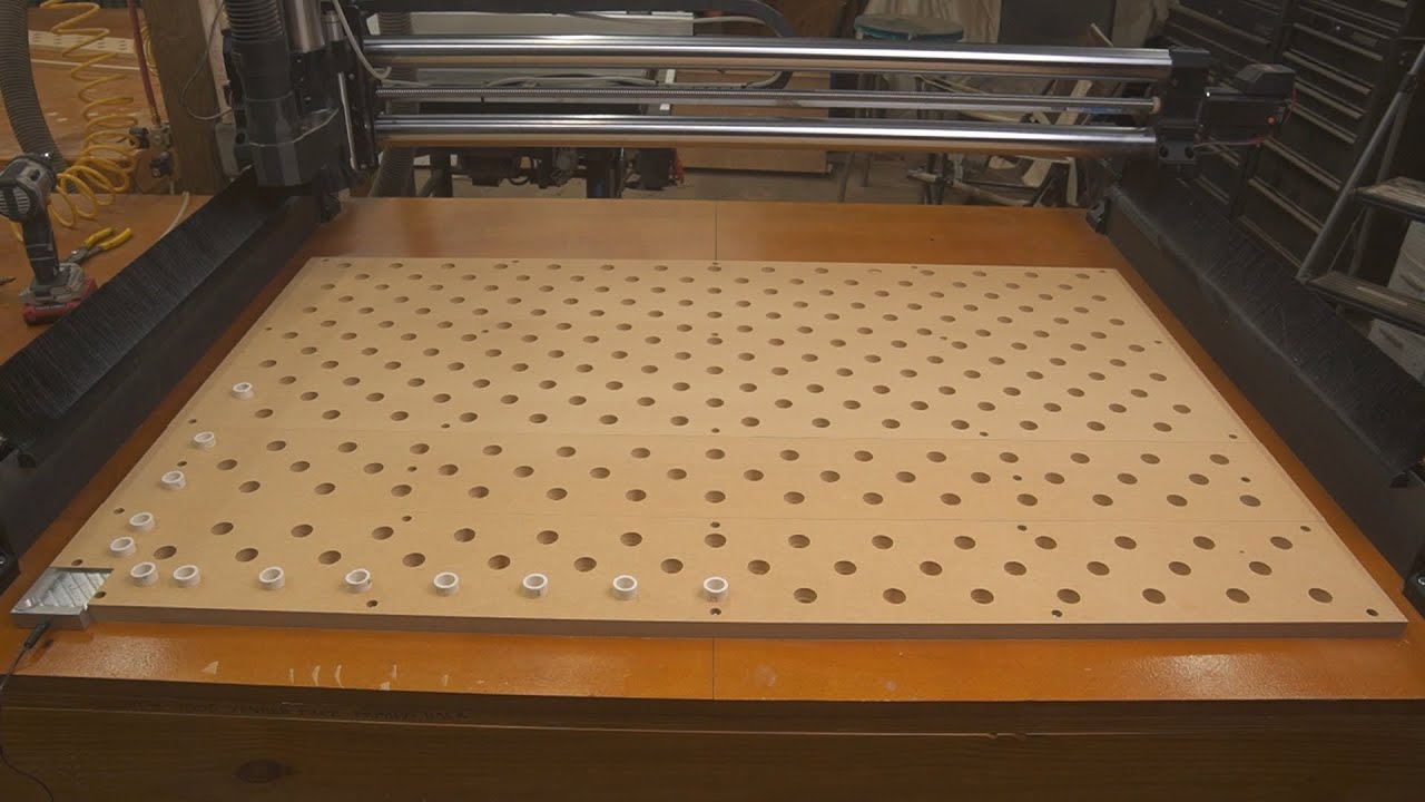

This is what I’m planning to do. Incorporates the rotary and a vertical clamping surface.
