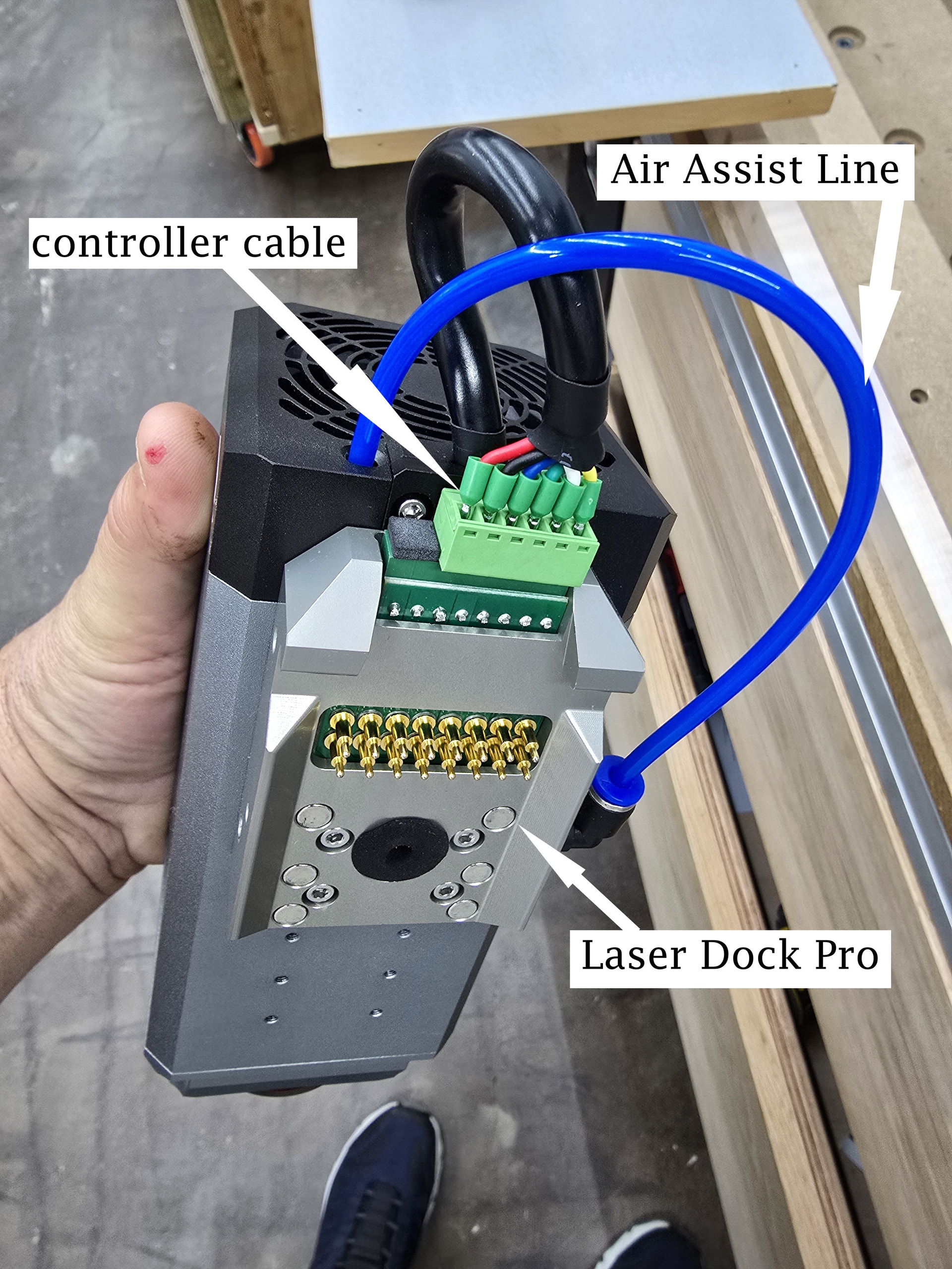

Anyone have a video or guide for hooking up the Sienci laser with an Altmill and gControl?

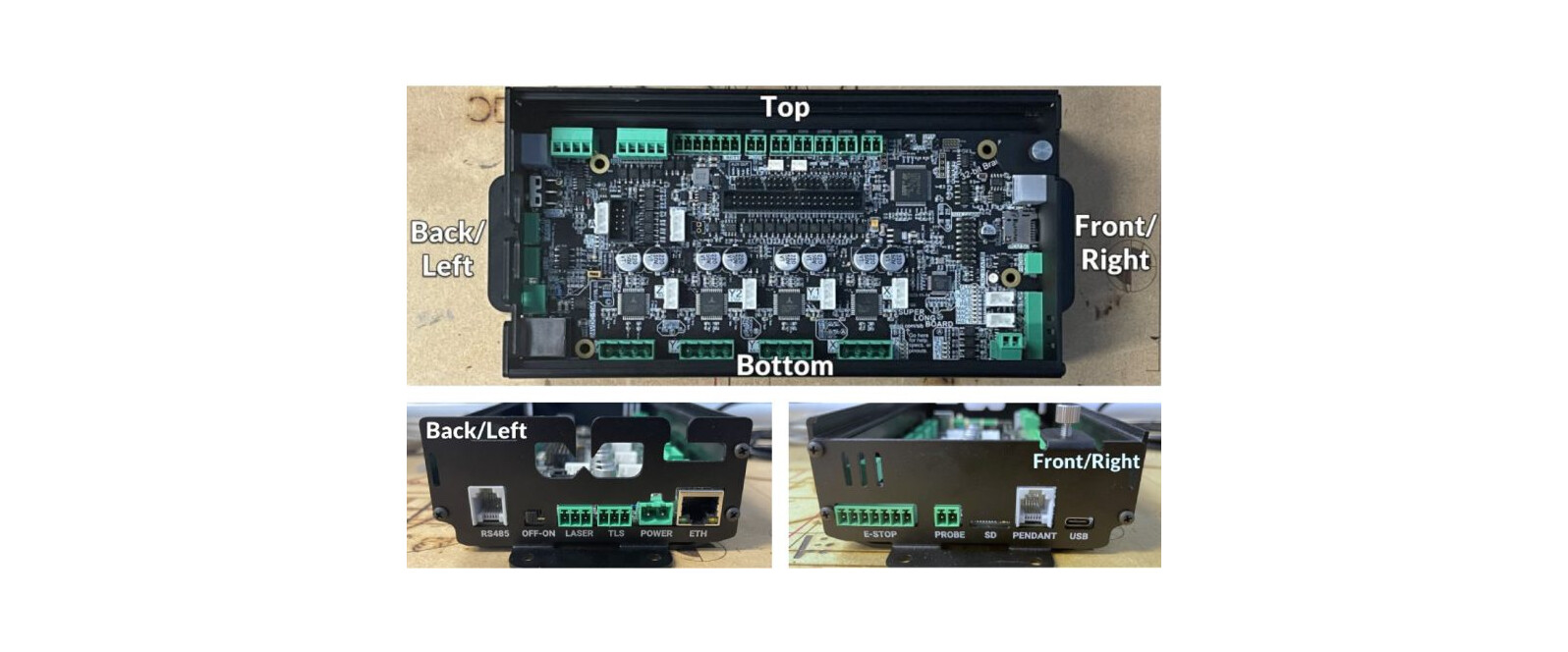

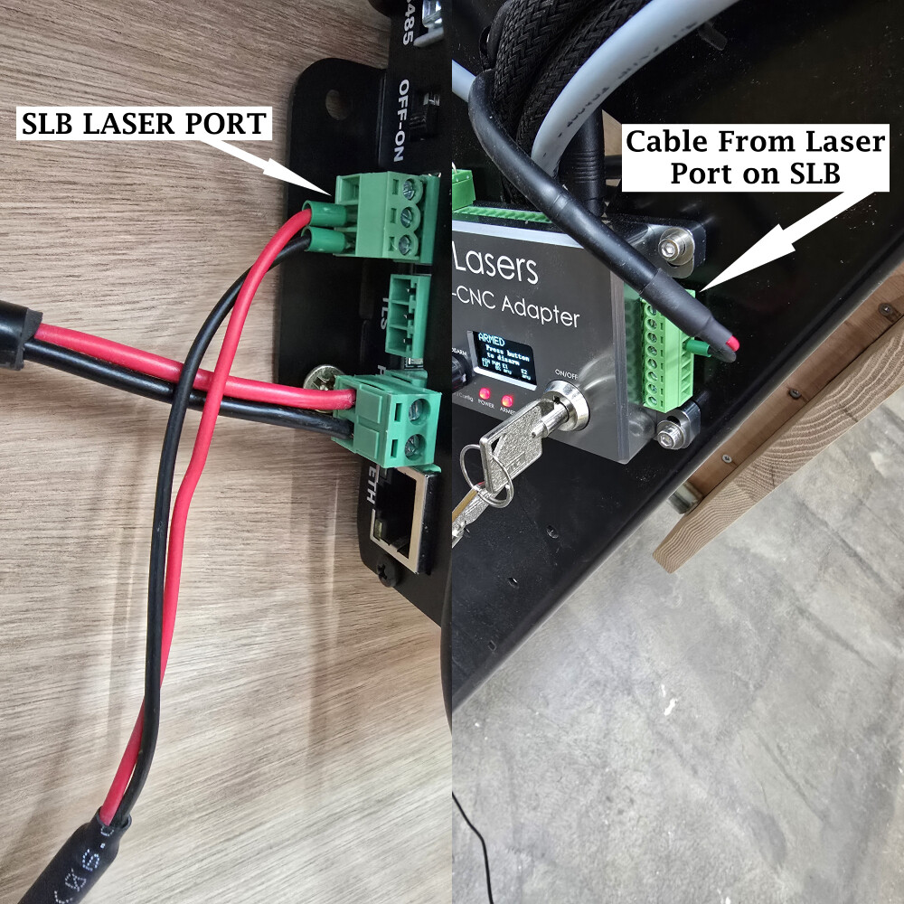

I have a Sienci laser on my alt-mill. It hooks up exactly like it did on the long mill except the wiring in the drag chain will be too short unless specifically ordered to fit the alt-mill. I made my own with 6c 18ga wire so I didn’t need the three wire solution that Sienci sells. Make sure to plug in the bottom two ports of the laser plug on the SLB-EXT. If you have a specific question, I’d be glad to help if I can.
