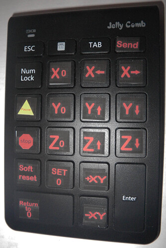

Well, I gave up on the F310, Bill. It was just too glitchy. However, I’ve had a wired keypad kicking around since a former life keying in many numbers on a laptop. I used the map feature in UGS to map its keys to the Mill’s functions and it is working very well.
Other’s here may find this useful, and an very inexpensive way to be able to be up close and personal to your job while controlling the Mill.

Here is what I ended up with, Bill. It works well, and was inexpensive.
Gwilki, did you use JoyToKey like Bill did? Same or similar configuration? Or did you just straight map it to UGS? I just ordered a keypad like yours. Also downloaded JoyToKey. Any help appreciated. Tired of using a USB wired mouse and trying to watch a 17" monitor 4’ away. Definitely think this will help a lot.
There is no need to use joytokey, since I’m not using a joystick. I just used the key mapping feature in UGS. It worked first time out. I did labels in photoshop, printed them to sticky labels and stuck them on. You can’t map the esc, tab, calc, numlock and enter keys. I didn’t map any keys with numlock turned off, but that would give you the same number again. I figure that I’m OK with what I have. So far, so good. If I can be of any help, just let me know.

H: I didn’t use the UGS defaults. If I recall, they use ctrl+ characters, which don’t really lend themselves to a keypad. I started a new profile, deleted all the defaults and created my own mappings.
I do have a keyboard hooked up. I use the computer for more than just running UGS. I have a wired mouse, too. With the keyboard, I just need to remember that, if UGS is running, the keypad numbers are no longer numbers, they are UGS controls. I’ve goofed a couple of times.
I saw that set of stickers on Instrutables, but decided on my own. He did his on paper and used glue. I did mine on waterproof labels that I got on amazon. Each label is a full sheet, size A4. I did them big enough that I didn’t need a backing to black out the key character. The label itself does that. There are lots of ways to skin this cat. Have fun.
