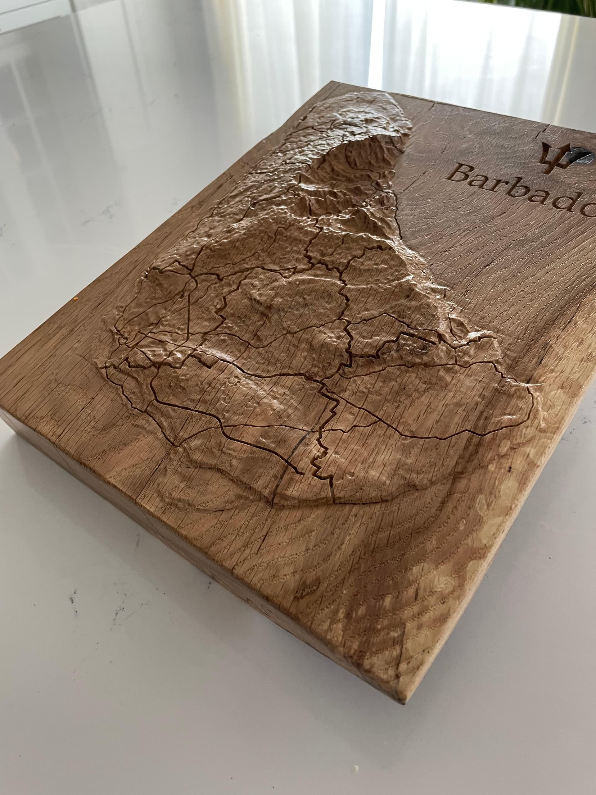

I have made a couple of Topo maps for family and friends:
  1. Devon Island in the Canadian high arctic (in support of an expedition);
  2. Barbados - because we vacation there a lot with friends;
  3. The island of Newfoundland as I have family there; and

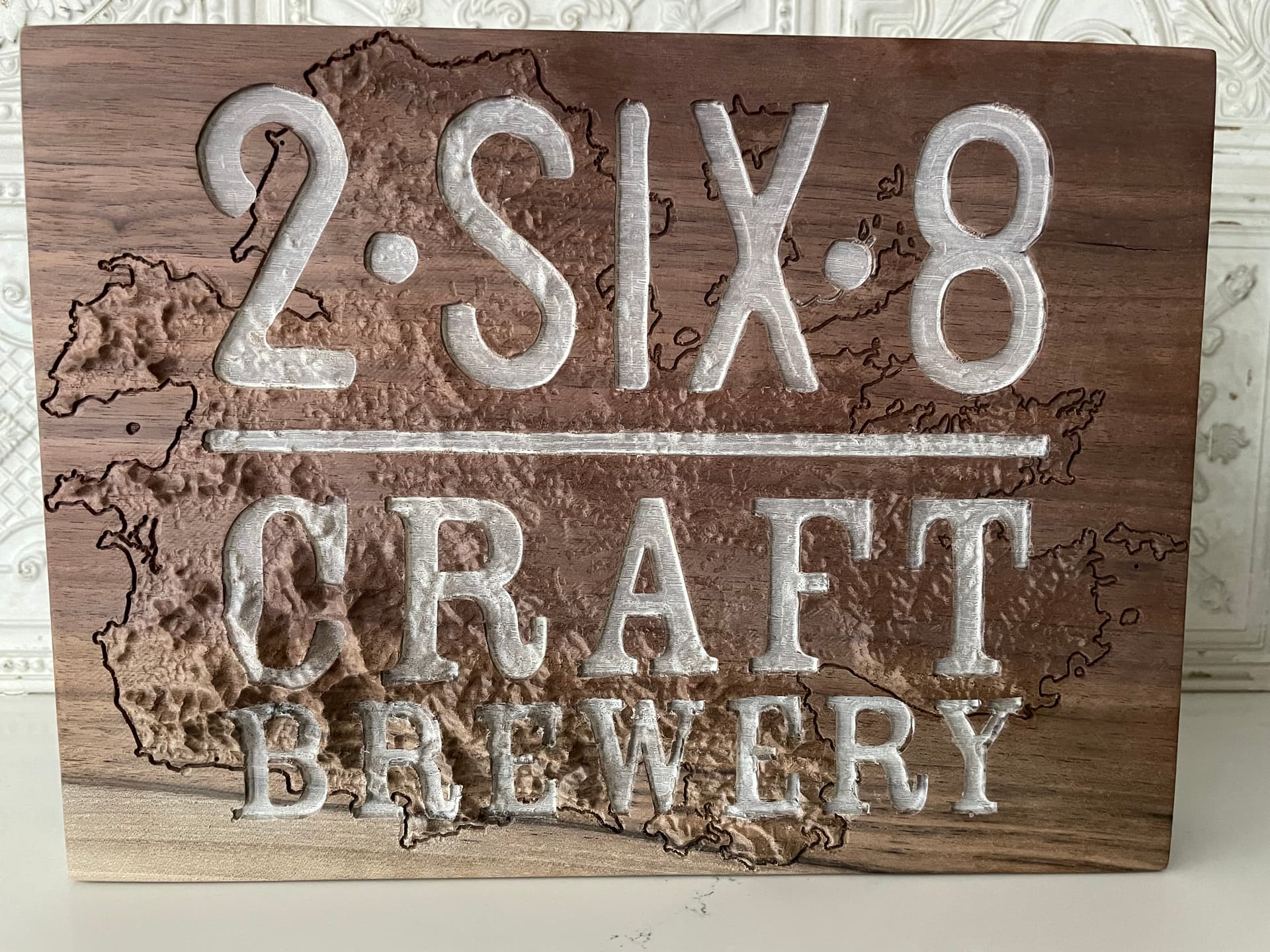

  4. Antigua (family friend own a brewery on the island).
Very nice @grubbertire. What’s your process for clearing and finishing these pieces? Flat end mill and tapered ball nose?
I started with a 1/2 bowl (ball end mill) for roughing, then a 1/4 ball for a 3D clear and a 1/4 tapered ball mill for the finish. 60 Vbit for the lettering and a 30 Vbit for the roads and boundaries.
The STL file for the topography I get from the Iowa State University (TouchTerrain: Easily Create 3D-Printable Terrain Models (version 3.6)). Streets, boundaries, lakes and rivers I get from Open Street Map (https://www.openstreetmap.org/), I clean up these vectors in Inkscape (https://inkscape.org). And finally overlay the vectors onto the 3D model in VCarvePro. (Touchterrain, Open Street Maps and Inkscape are free :grinning:).
