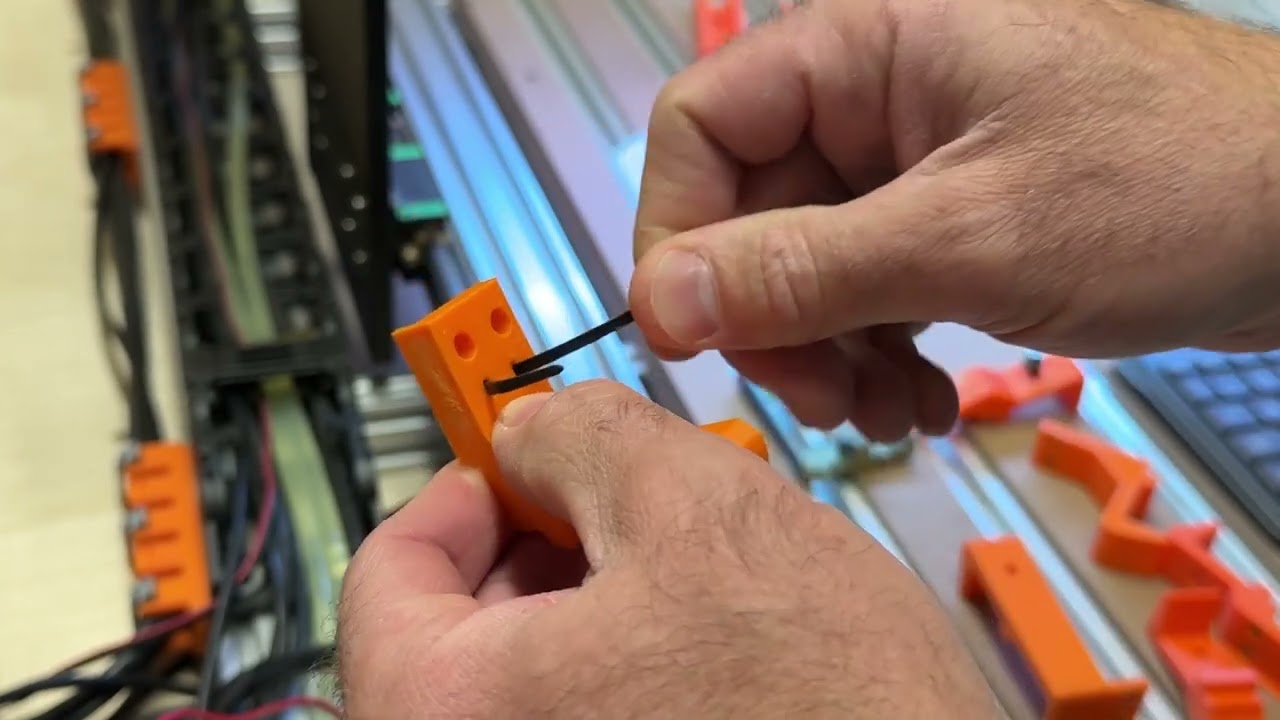

Hey Sparky,
I’m curious how you have your limit switches wired up? I’m considering repurposing my z inductance switch as a second y and replacing the z with a mechanical rocker.
If you have a sec please describe your set up and post a pic.
Thanks,
Nat
Evening.
Here is the best look at my setup.
Final version Proximity Switch mounts
Hey Sparky,
Nice Video thanks for sharing.
Nat
