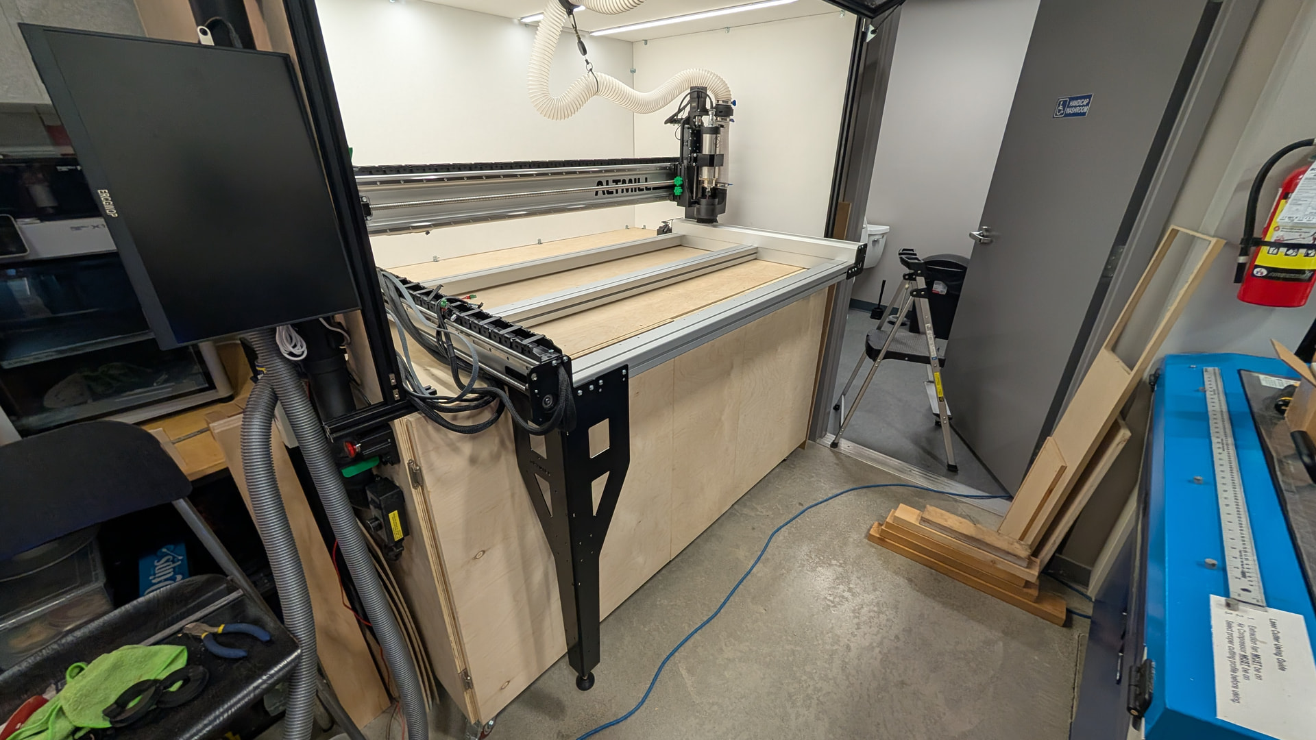

I have the cabinet CAD files somewhere…might be on the computer at home. But the outside dimensions of the enclosure (plywood is 0.75in) is.
X:71.5in
Y 45.75in
The enclosure doesn’t use the Altmill legs as I wanted it at a specific height + I wanted to sound isolate in the cabinet under the machine for the dust collection that I currently have which uses a shopvac as the dust extractor.

It’s a great build and very similar to what I’ve been thinking about. I was thinking about sandwiching 1/2ā€ mdf with green glue and doing an accordion fold door. It seems that you’ve made it quite tall - do you feel like you need all that cabinet height and also the relief around the sides? Thanks for sharing!
The accordion folding door is a pretty good choice, just make sure the fold doesn’t block the computer and you are golden.
I think the height of enclosures are very much personal preference thing. I like the ability to manage the inside of the enclosure space with the extra room for things like lighting, vacuum tubes, and etc. Should I ever need to crawl in there to work on something, there is plenty of room to comfortably sit in there as well, for reference I’m 6’3ā€. Lol ask me how I know.
As for the sides, yes absolutely. Without the extra space, performing service wouldn’t be possible. I would say what I have there is probably the bare minimum, unless I redid a section of the L and R side of the enclosure to be removable/openable.

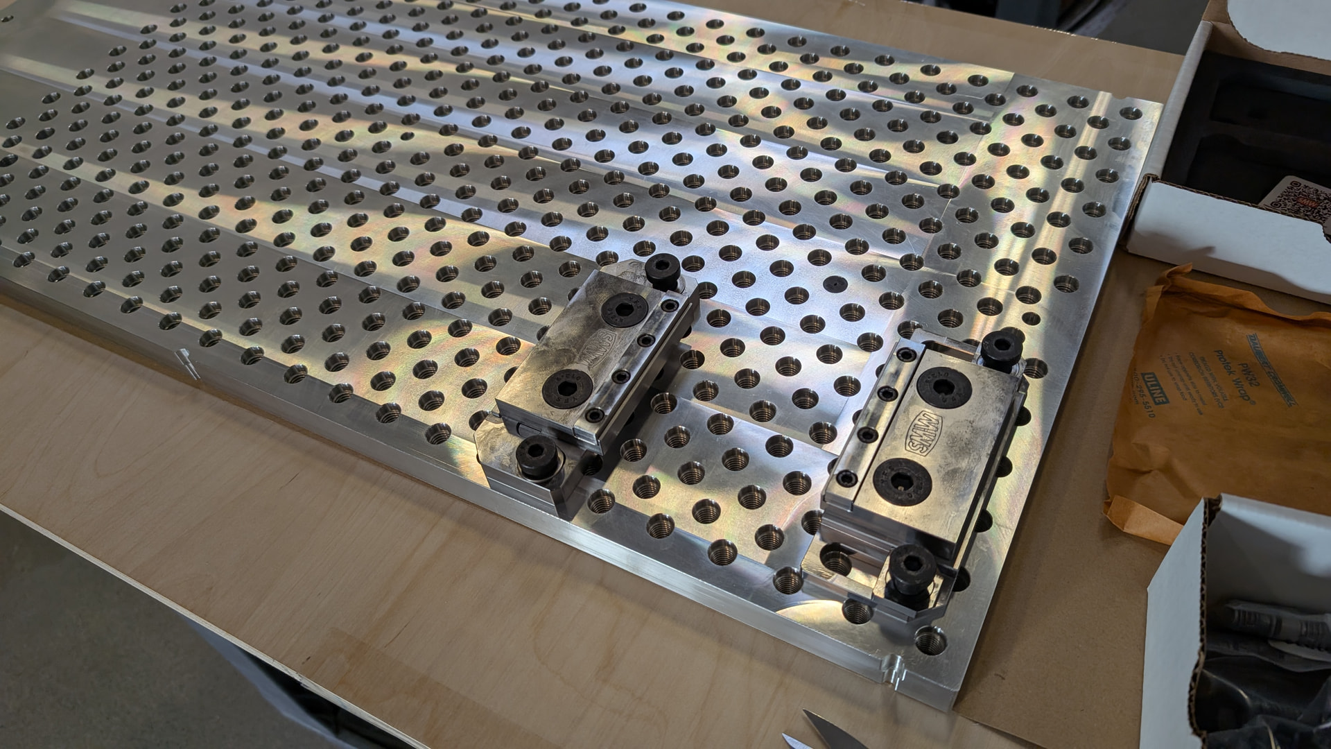

Saunders Machine Works (SMW) makes fixture plates for a lot of different machines, including hobby CNC routers like the Shapeoko, AVID, and even Shariff plus larger mills, and will do a custom job. A full fixture plate either DIY or purchased would be expensive relative to the cost of the AltMill - less so for a Brother or Hass. I’ve seen what looks to be a small custom fixture plate used in Siensci videos when they are milling aluminum - they must have either made that or got it from somewhere. I came across a fellow on YouTube with a similar machine to the AltMill who made (DIY on the machine) a full-bed fixture plate out of Derlin with threadmilled holes into the plastic, plus a full vaccuum setup with a grid cutout on top - didn’t save the link unfortunately. Would be very interested in what you decide to do as I’d like to do something similar when my machine arrives. My current thoughts are a relatively small aluminum plate to supplement the MDF spoilboard. Best of luck with it.
The fixture plate is designed around SMW’s hole spacing, so I can easily use their vices and accessories without reinventing the wheel.

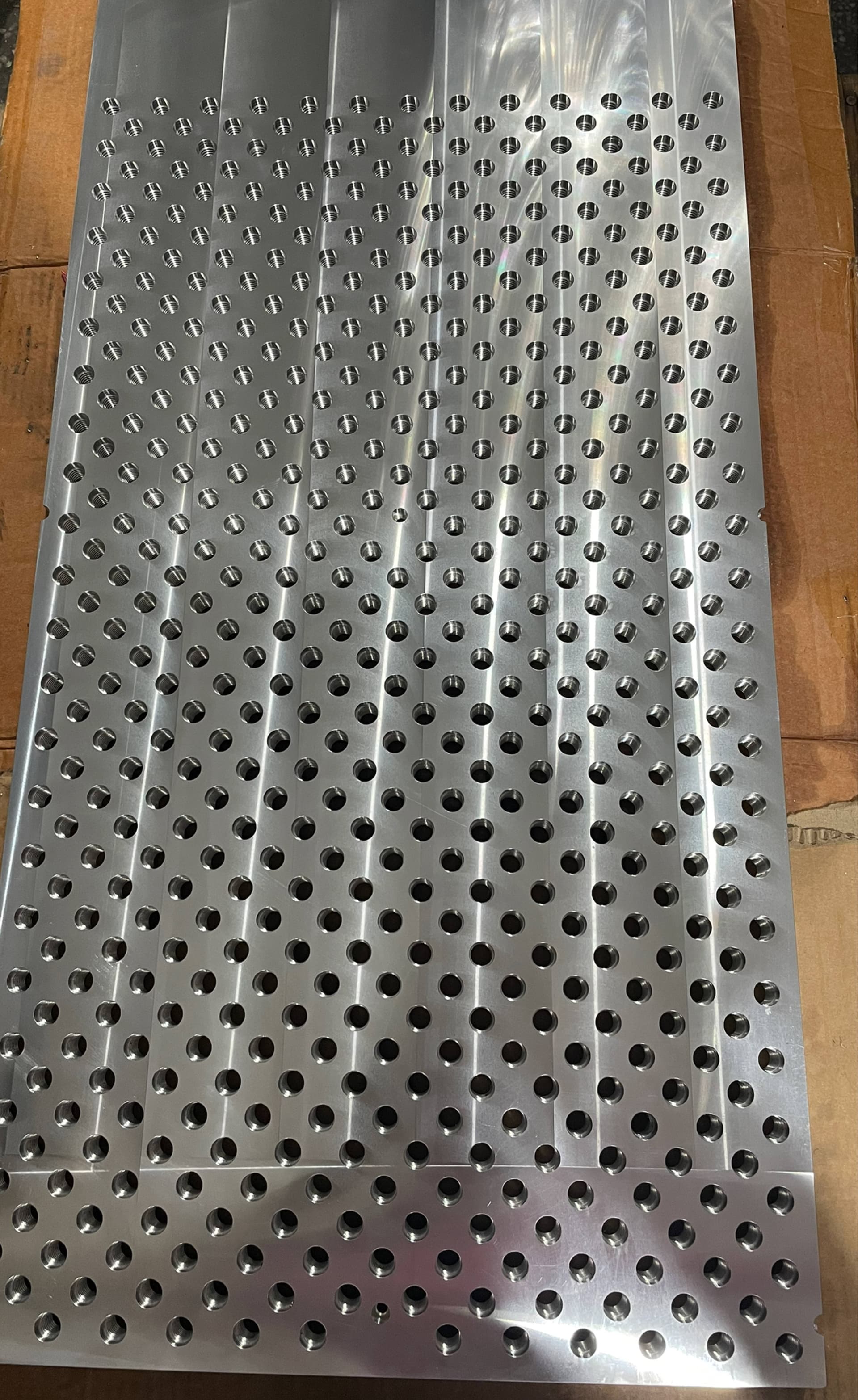

I ended up sending the plate out for fabrication, and it’s nearly finished. A few days ago I received a photo with tolerance checks, and I’m excited to see it all come together.
I originally bought the Altmill as a production tool for my business—not just as a hobby machine. In the short time it’s been running, it has already paid for itself several times over without a single hiccup. Adding a fixture plate, even if it adds additional cost, will only help to speed things up further, making the investment well worth it in the long run.
I’ve also looked at the smaller fixture plates Sienci shows in their videos. Using only two of the cross braces reduces the Y-axis cutting area significantly. While designing the fixture plate, I thought about extending an unsupported cantilever section past the two cross beams… but it just didn’t sit right with me with the amount of deflection from downwards forces that could be applied.

I’ve finally received the fixture plates! Now to find some time to get them installed.

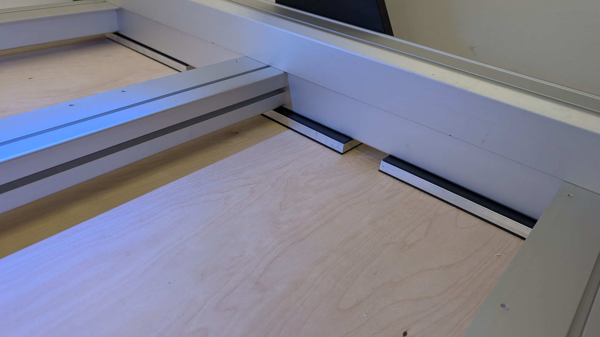

I’m going to upgrade my Longmill with a 2x4 Altmill. I want to sit it on an existing stand. There is some talk in this thread about having to put in a spacer to raise the extrusions off the table surface. Is this the case? What’s the reason?
Hey Mike,
The reason for lifting the machine up a bit on spacers is because the zerk nipples on the Y axis rail might sit below the frame of the machine. This means when the machine travels, the fitting will drag/grind, something worth avoiding.
The left Y axis on my machine was fine, but the right Y-axis had the Zerk fitting sitting a few mm below the surface of my Altmill’s frame.

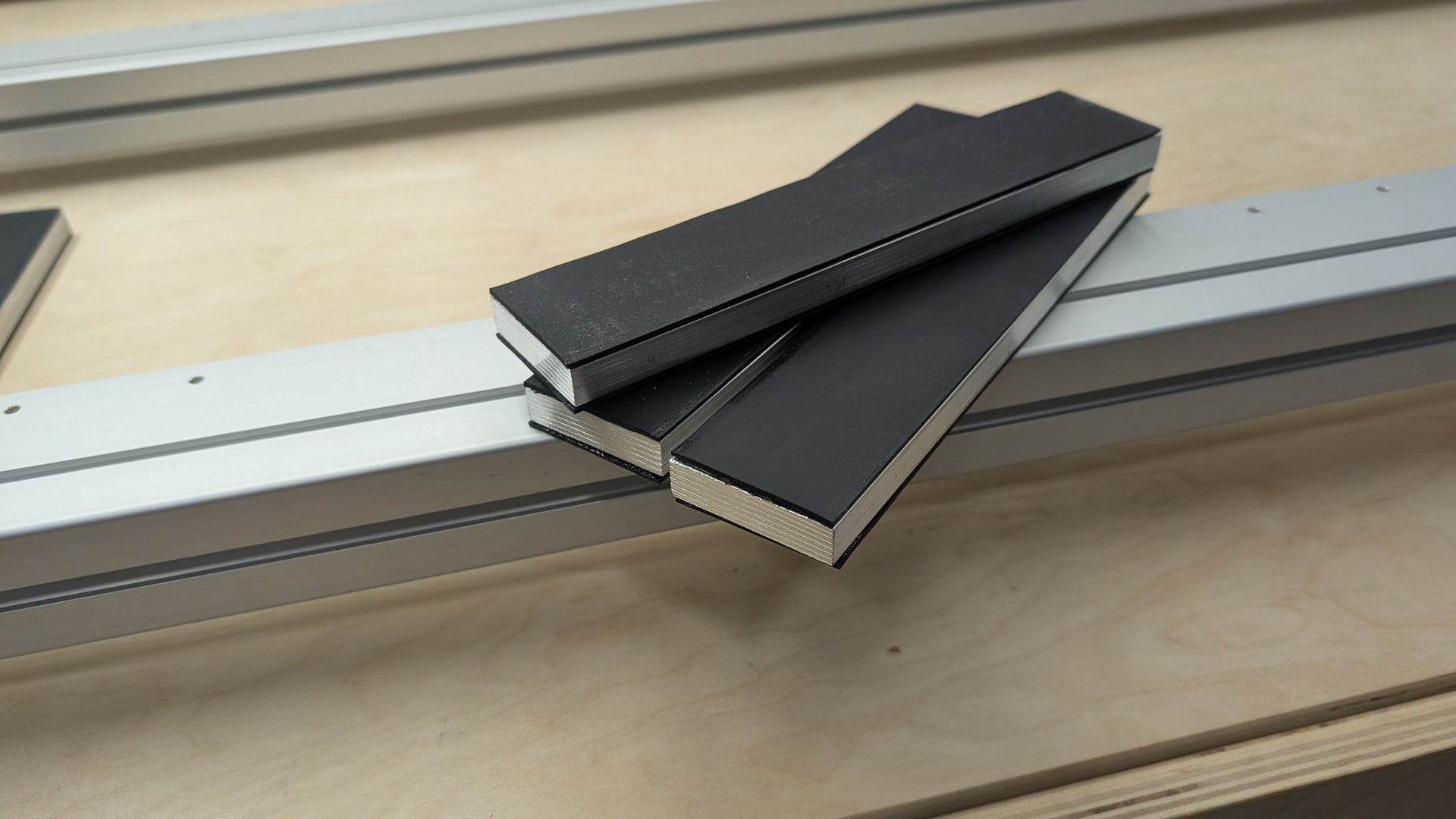

Holy moly… the year-end rush is real! I had to wait until all the immediate orders were fulfilled before I could even think about tackling this. Even then I only have a few days before it needs to be back up and running. Ended up having to get pretty creative, too. With limited access to the bottom screws that secure the MDF, things got a bit sketchy/interesting. I had to disassemble the door frame just to slide the machine out, reinstall the original legs, and then use some 2x4s to prop up the machine while I slid underneath to reach those screws.
Also decided to make a few dampened spacers out of 1/2ā€ Ɨ 2ā€ aluminum bar stock, with neoprene rubber on both sides, to lift the machine and support the additional 120+ lbs of weight. This should also give me more than enough clearance to reach the grease fitting on the right side.

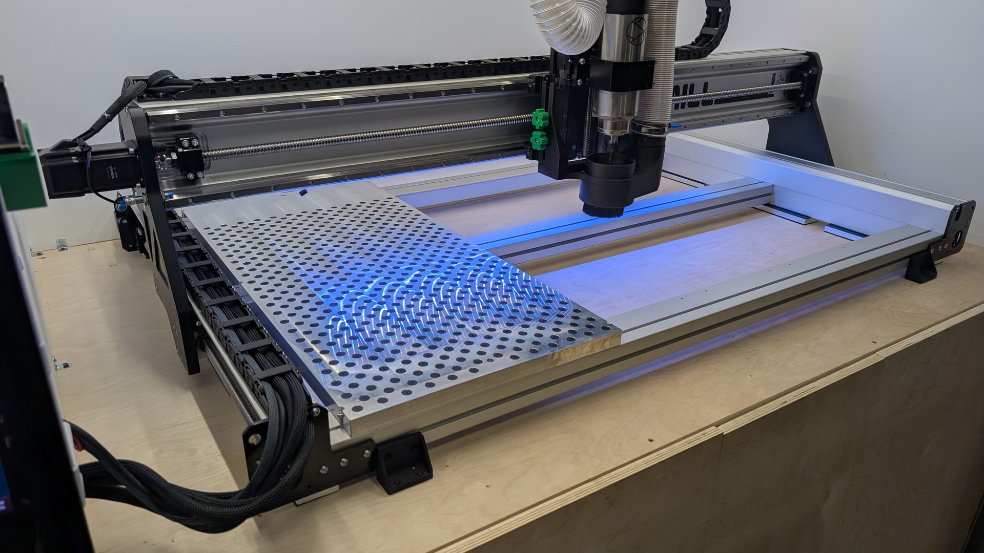

Didn’t get around to finishing the install since it was already pretty late by the time I reached this stage… but I test-fitted one of the plates to make sure all the mounting holes line up with the extrusion channels….and THEY DO! I’ll get the rest wrapped up tomorrow once I have some daylight and a bit more energy. Also, plugging 1600 holes with the SMW plugs was no fun, lol at least thats done.

I’ve posted this photo everywhere else but here… so I thought I’d finish the fixture plate series with a final photo with all 3 plates on the machine. This was done back in Dec 2025 before the holidays kicked in.

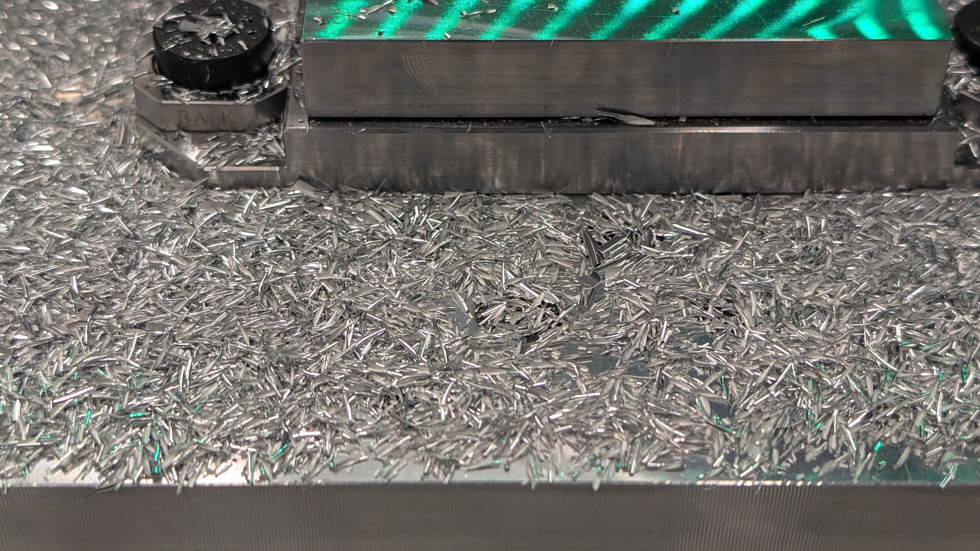

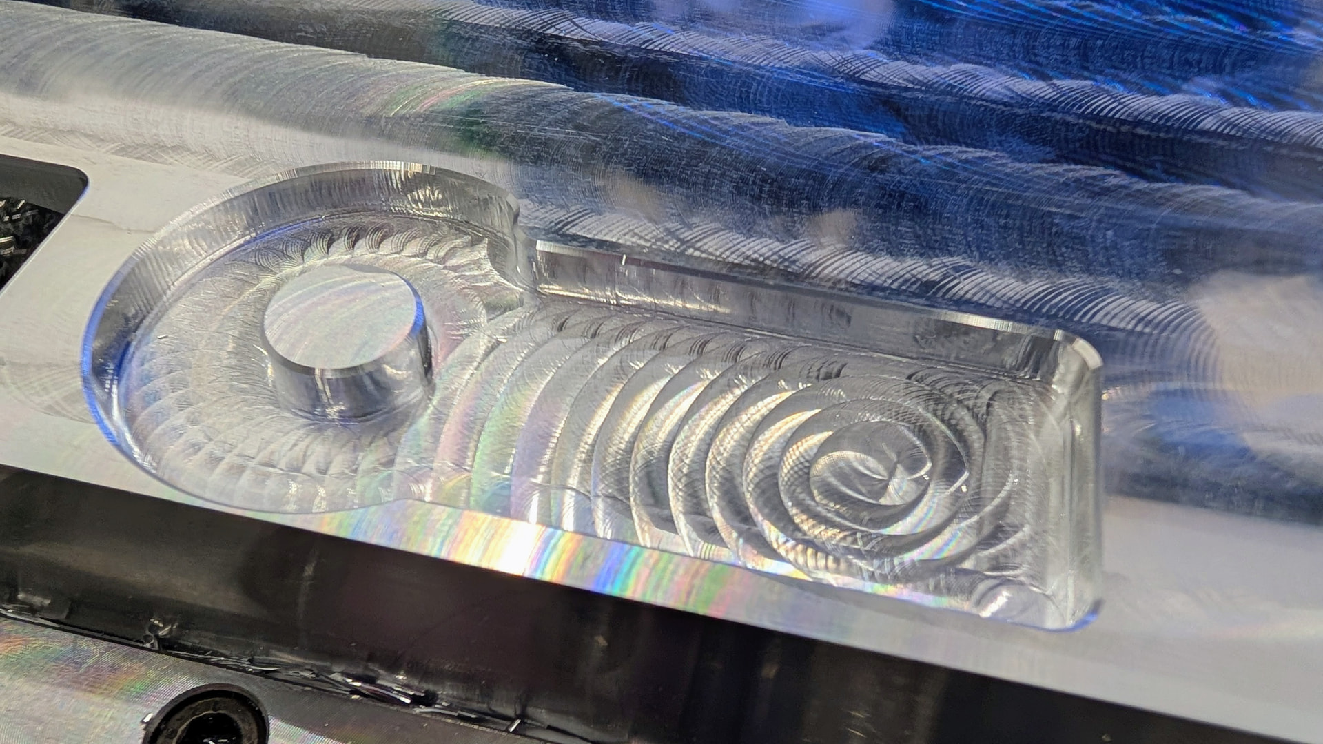

Also been dialing the tools in that I often use for aluminum work. Most of these are with 2d adaptive. Here are the chips from a mix of 3.175mm- 6mm single flute endmils as well as a BAP300R carbide insert cutter.
Chips
Test cut for dialing in
For anyone looking for a starting point here are some of the settings I have been using reliably for the work I’ve been doing on the Sienci 1.5kW spindle. You can get more aggressive, but I like to leave some room for peace of mind when cutting dry.
BAP300R-16-80-C10-2T
21,000 RPM
1,500mm/min feed rate
14mm WOC
1mm DOC
3.175mm single flute (3.175x10x38.5) DLC endmill
24,000 RPM
900mm/min feed rate
0.9525mm WOC (30% & optimal load for 2d adaptive)
3mm DOC
0.0375 mm feed per tooth
6mm single flute (6.0x12x50L) DLC endmill
24,000RPM
1,550mm/min feed rate
3mm WOC (50% tool diameter & optimal load for 2d adaptive)
4-9mm DOC
0.0645 mm feed per tooth
8mm 3 flute (8.0x8.0x60L) DLC endmill
24,000 RPM
4700mm/min feed rate
3mm WOC (38% tool diamater & optimal load for 2d adaptive)
4mm DOC
0.0653 mm feed per tooth
3 flute 45degree chamfer DLC bit
16,000 RPM
400-600mm/min feed rate
0.5-1mm chamfer width

enclosure came out great. Does it reduce sound levels as well?
Ya it does a great job of it.
