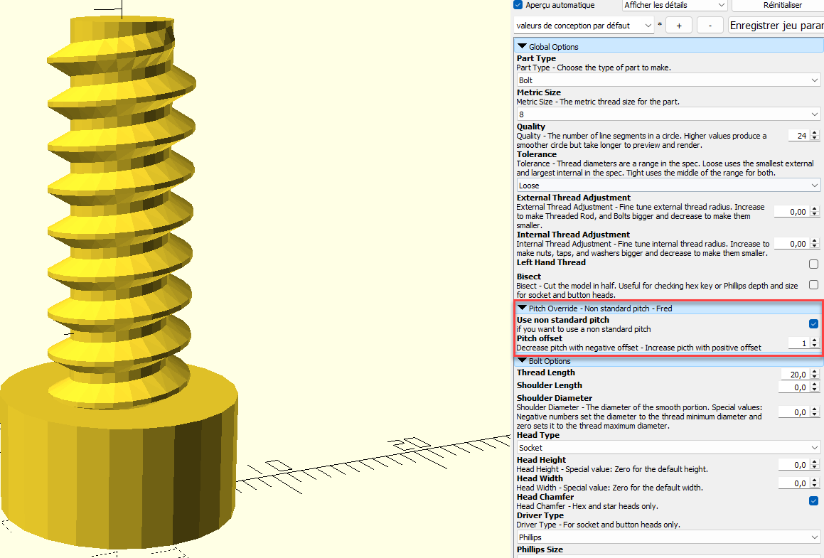

Hello, thank you for your work, very usefull…
I’ve slightly modified the script to support a non-standard pitch, which can sometimes be useful in 3D printing. Here are the changes if you’d like to incorporate them.
Inside [Global Options] after Bisect = false;
/* [Pitch Override - Non standard pitch - Fred] */
// if you want to use a non standard pitch
Use_non_standard_pitch = false;
// Decrease pitch with negative offset - Increase picth with positive offset
Pitch_offset = 0.0;
      ? p + Pitch_offset
      : p;
@FredxX59 I’m glad you found this useful! I think the non standard pitch is a useful addition especially for smaller fasteners.
