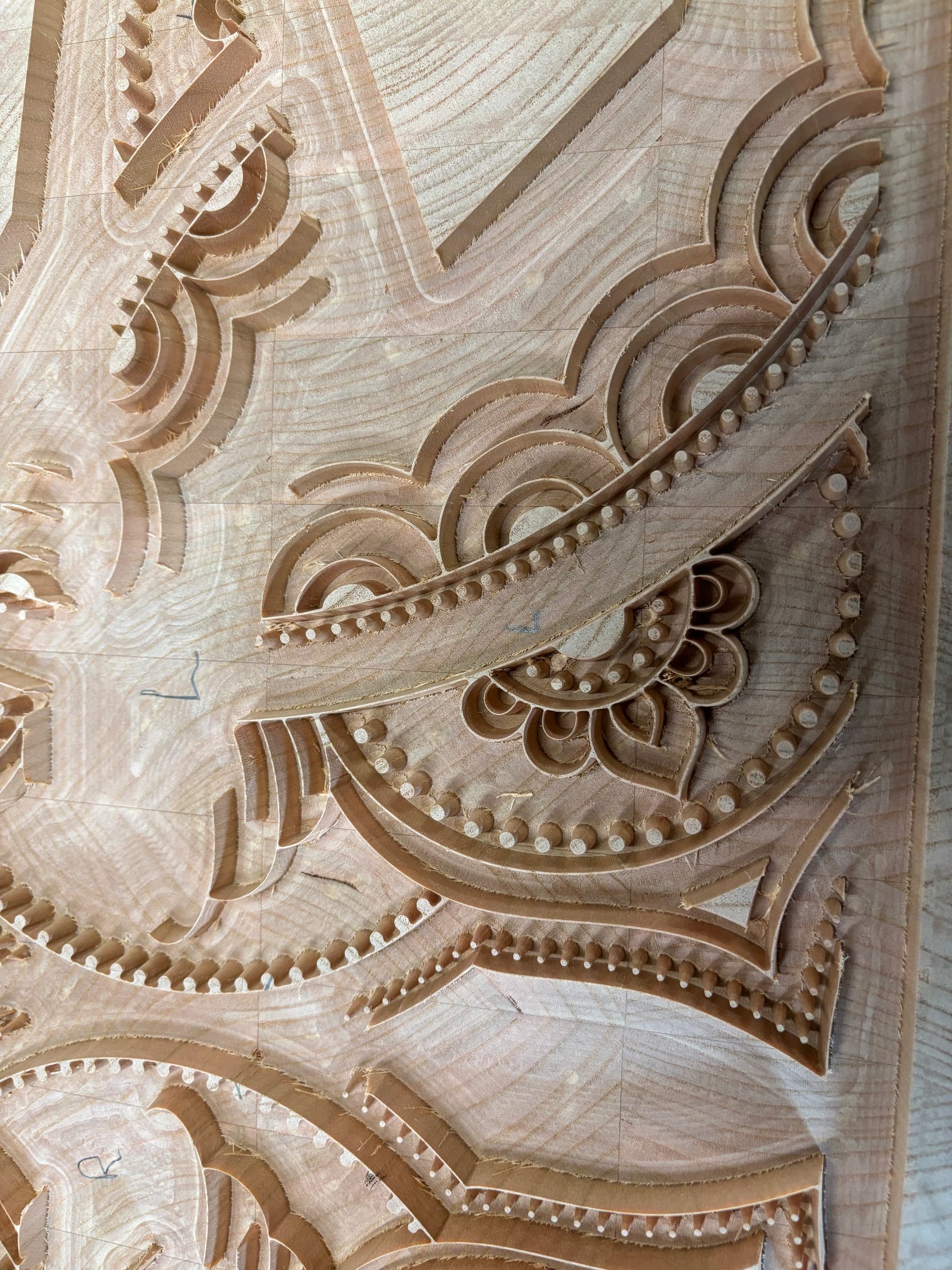

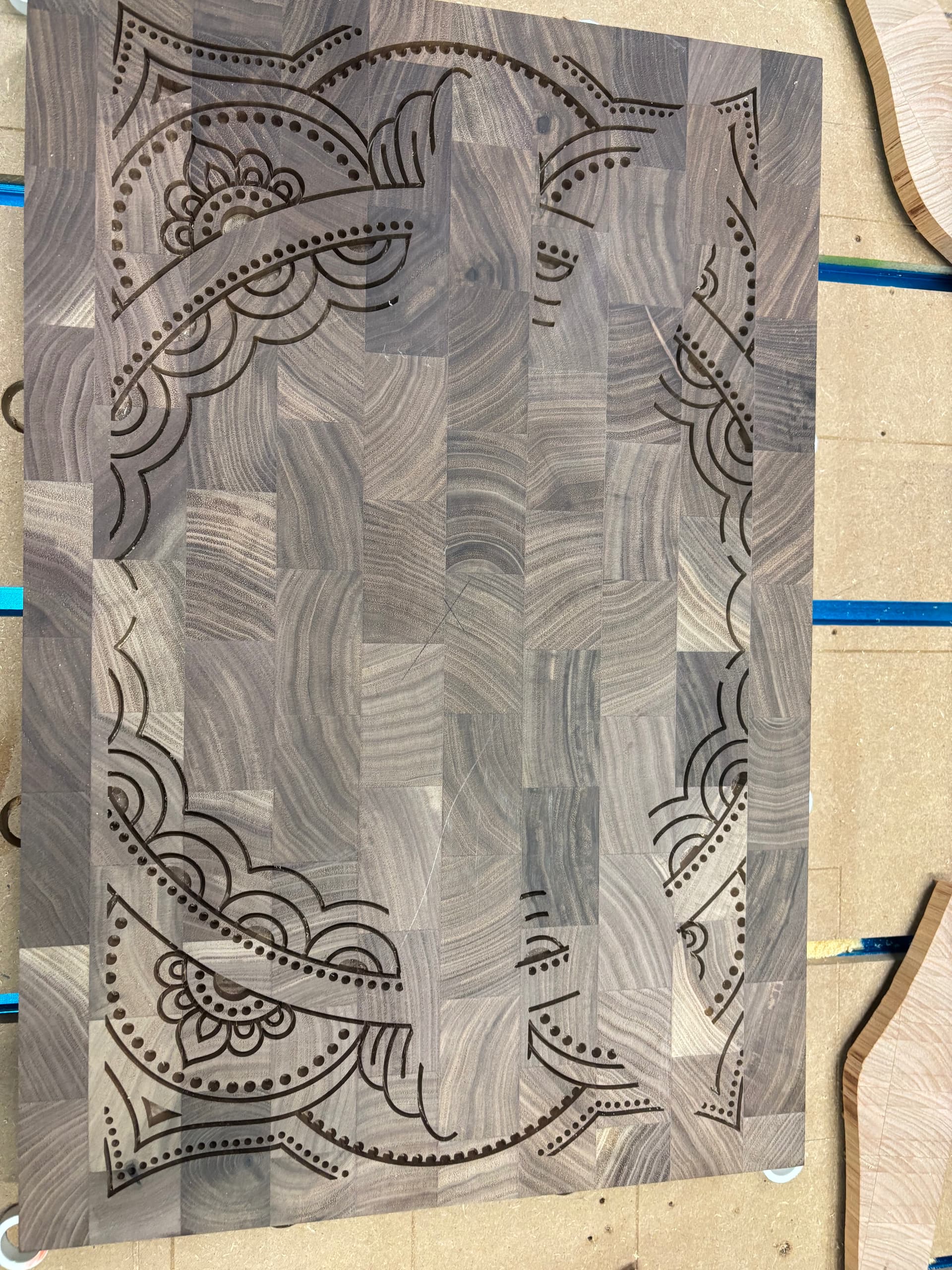

Hey Rusty,
Just read your post. Had that happen to me too! Read somewhere that doing the finish cut first and then the roughing cut after helps support the intricate pieces . Tried it and that is now my go to method for intricate inlays. Canโ€™t speak to your speed and feeds and cutters. Hereโ€™s what I use; Amana tapered ball nose bits 6.2 degrees 46280-k and 46473, both run at 12,000 rpm, 30 inches/min feed rate, 40 inches/min plunge. Clearance tool for intricate inlays Whiteside end mill .125 at same feeds and speeds. Hereโ€™s some pictures of inlays that I cut yesterday and glued this morning. Purchased the design from Nik @broinwood .com. Hope this helps!
