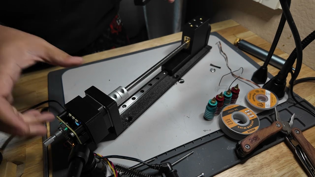

Creating a topic to document my progress in building the AutoDustBoot for the Altmill, similar to what I did with my Onefinity. You can check it out here:
The main reason I created this dust boot is to achieve full automation with an ATC, such as the RapidChangeATC. Additionally, I’m not a fan of spindle-mounted dust boots because they create more pressure as the spindle cuts deeper.
Key Features:
  • Automatic retract and expand during job runs, which is crucial for avoiding collisions with the ATC.
  • Quick removal without requiring any tools.
  • Ability to save material height.
  • Swappable brushes with different length accommodate varying wasteboard heights.
Here are pictures of my concept design.
Here is the electronics components. I’m using a stepper motor with a closed-loop driver and a small microcontroller.

For me, having an ATC was always a dream, but I never considered it seriously because of the complications with the hardware (compressor, pneumatic lines, ATC spindle, etc.) for a hobby-grade CNC. However, when I saw the implementation of the RapidChangeATC, it was so simple that all I needed was to find a place for the magazine—everything else is handled through the software configuration, with no need for extra hardware.

It’s actually a fully functional ATC. In the prompt, I’m issuing M6 commands, which is the standard way of changing tools and the same command most CAM software generates in the G-code. The firmware (grblHAL with an NGC expression macro stored on the SD card) handles everything automatically. The the macro in gSender and the macro in the firmware used by RapidChangeATC are different.
In the video, I demonstrate a G-code program generated from Fusion 360 that runs a job using two tools.

Although the acrylic tube looks cool, it will be hard to align it during assembly so I simplify the dust leg. Still can be remove without using any tools.
It’s almost done:

Instead of directly driving the dust boot, would it be possible to design this in such a way that the dust boot is spring-biased downwards against a hardstop, which itself is driven up and down by the motor?
The goal would be for accidental Z-plunges to just compress the spring and cause the boot to slide upwards instead of breaking something.
I think it will add more complexity. I tried to make it as simple as possible to ensure it’s easy to produce. I did consider making it completely foolproof, but there’s only so much I can do.
An alternative solution, which might be easier, is to cut the idle power to the stepper motor when it’s not moving. In this case, if the user forgets to add the M8 command in their g-code to expand the dust boot and allow the Z-gantry to plunge, the stepper will simply give way and follow the Z-axis until it reaches the travel limit.
By the way, I designed the bottom travel limit to be much lower than your Z-gantry should ever travel. If this happens, you’ll face more serious damage to the CNC bed rather than the dust boot— which is much easier and quicker to replace. :blush:
