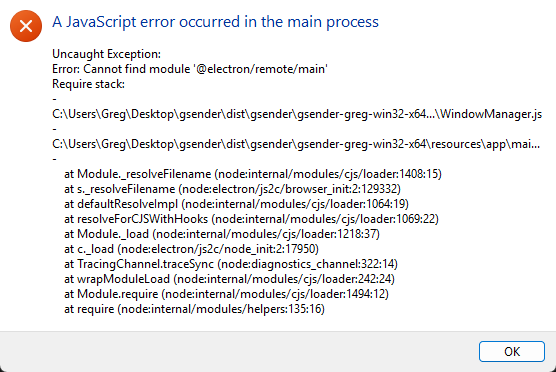

Made it through most of the steps, but running the app
I had this exact problem at first. Also just fyi, the process hangs so you’ll have to kill the process for any of them that you opened.
I am not 100% sure yet how I solved that. Because I tried a few things and then it just worked. I believe that error is related to a package missing, so I suspect that when I was careful to make sure I was in the path build/dist/gsender (this is the build output from yarn build.. then in my local terminal I did yarn install / npm install (I think that’s redundant?) .. it worked after doing that.

@greg5 - I figured it out. I had forgotten that I did this.. ok the error that we both got, is actually because it is missing a package @electron/remote - I do not know why this isn’t a package installed when you run yarn install in the dist/gsender directory after building, but it isn’t.
To solve this after you complete a build, prior to packaging it for electron you need to run:
npm install --save @electron/remote

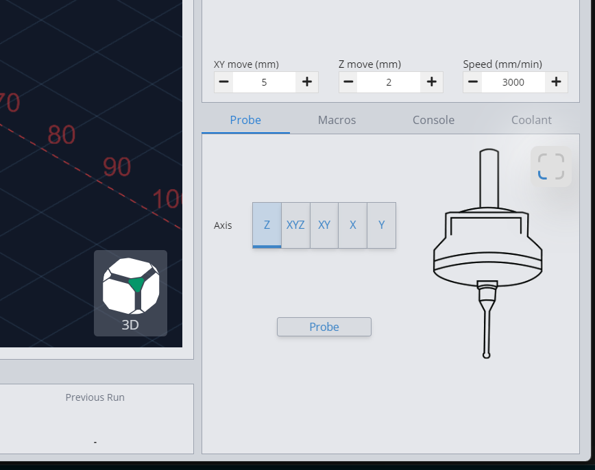

I cannot edit my original post anymoer - so hopefully folks see this update. Gsender runs fine when this package is there. I also see my code change - I modified the probe settings to add my “3D Touch Probe” as a new probe type, and modified the probe widget to show the image when that probe type is selected:
