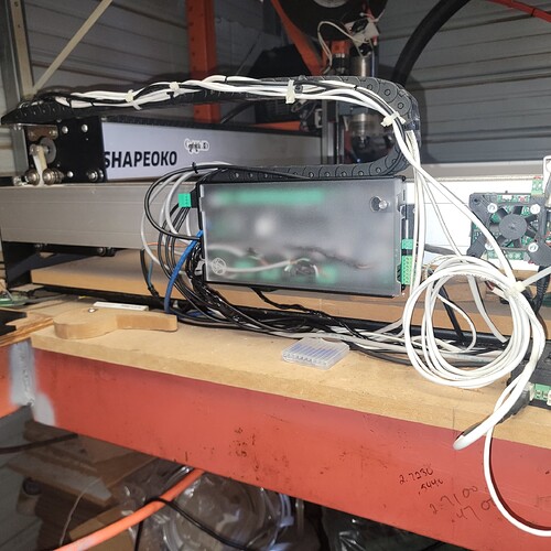

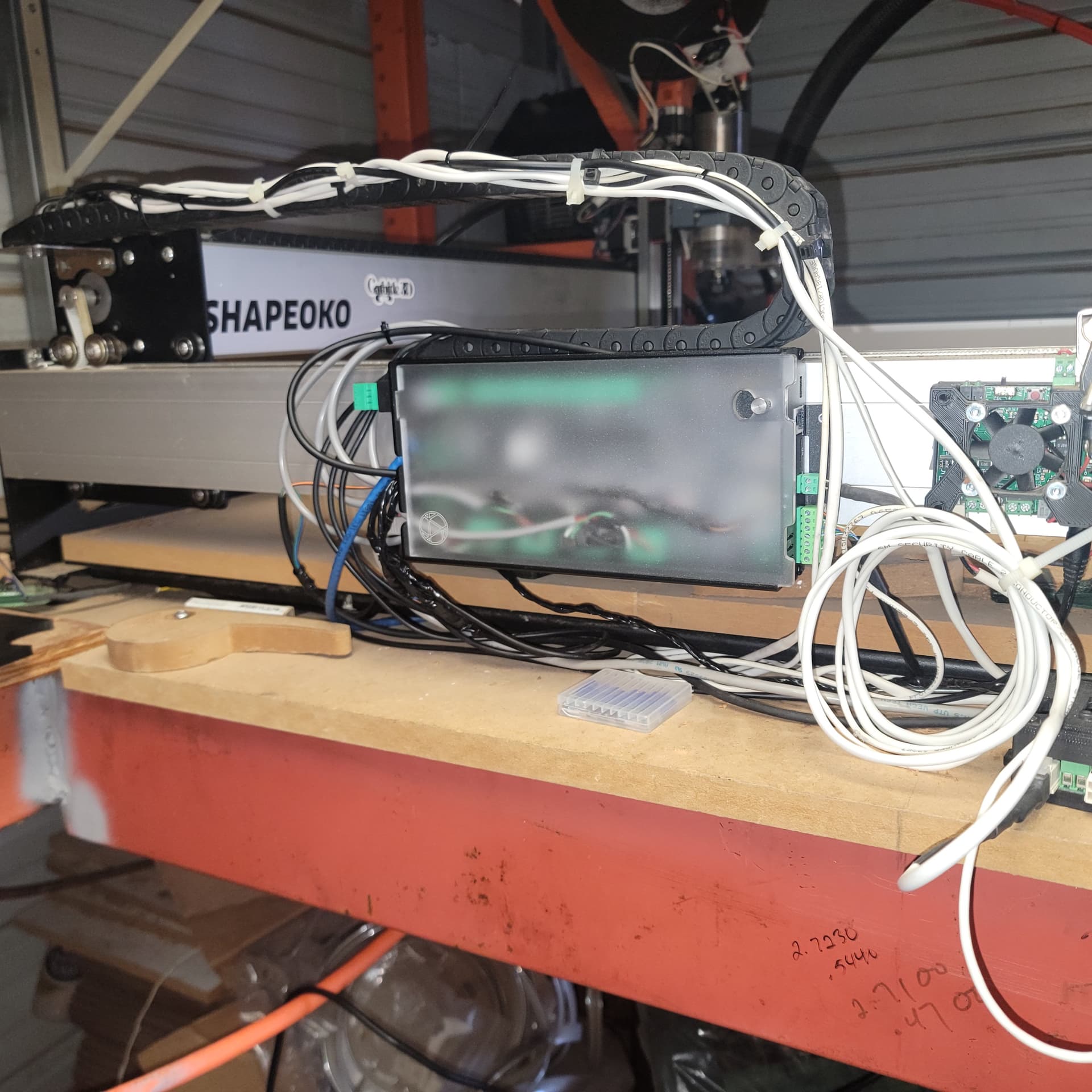

I upgraded my Shapeoko XXL with the SLB. So far, it is working very nicely

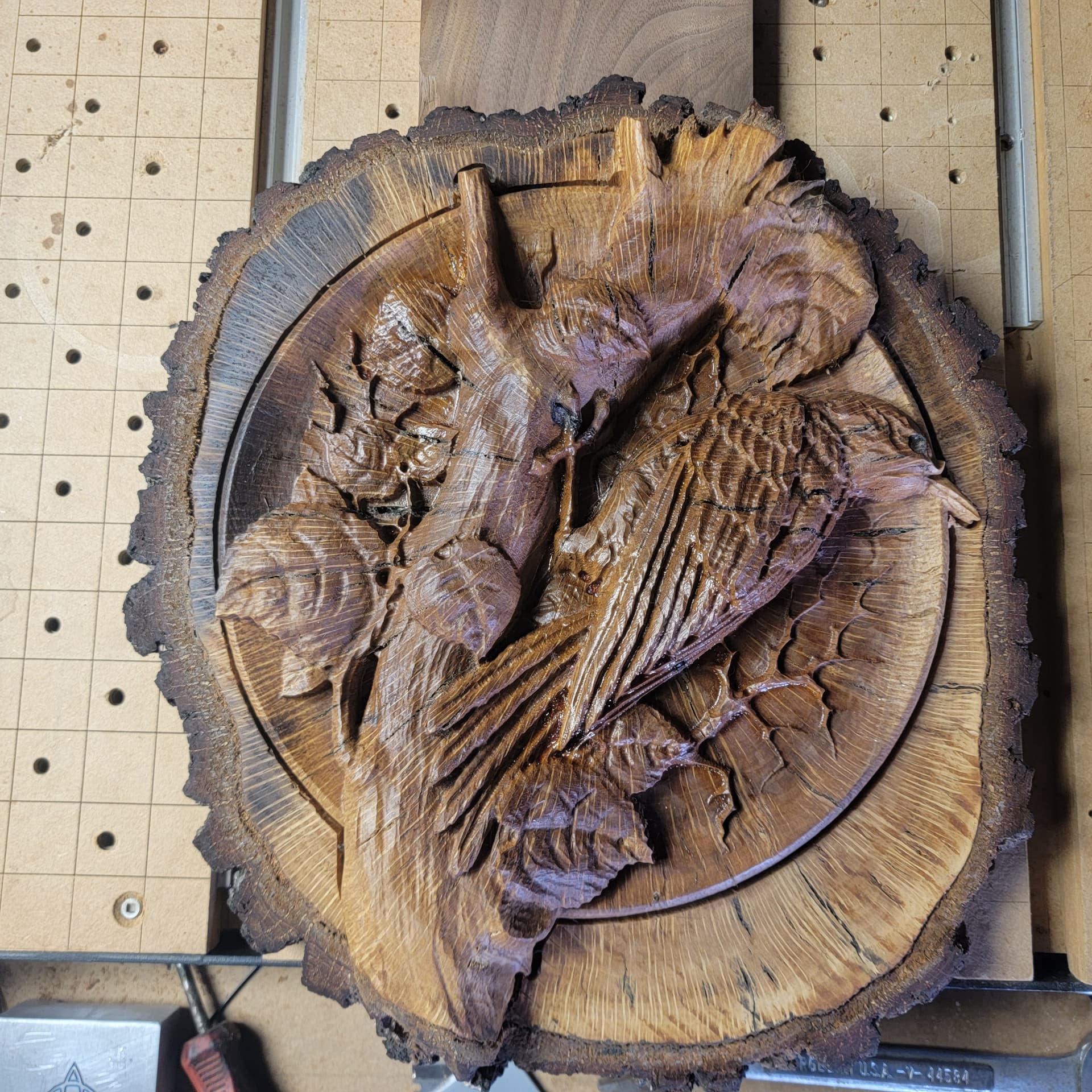

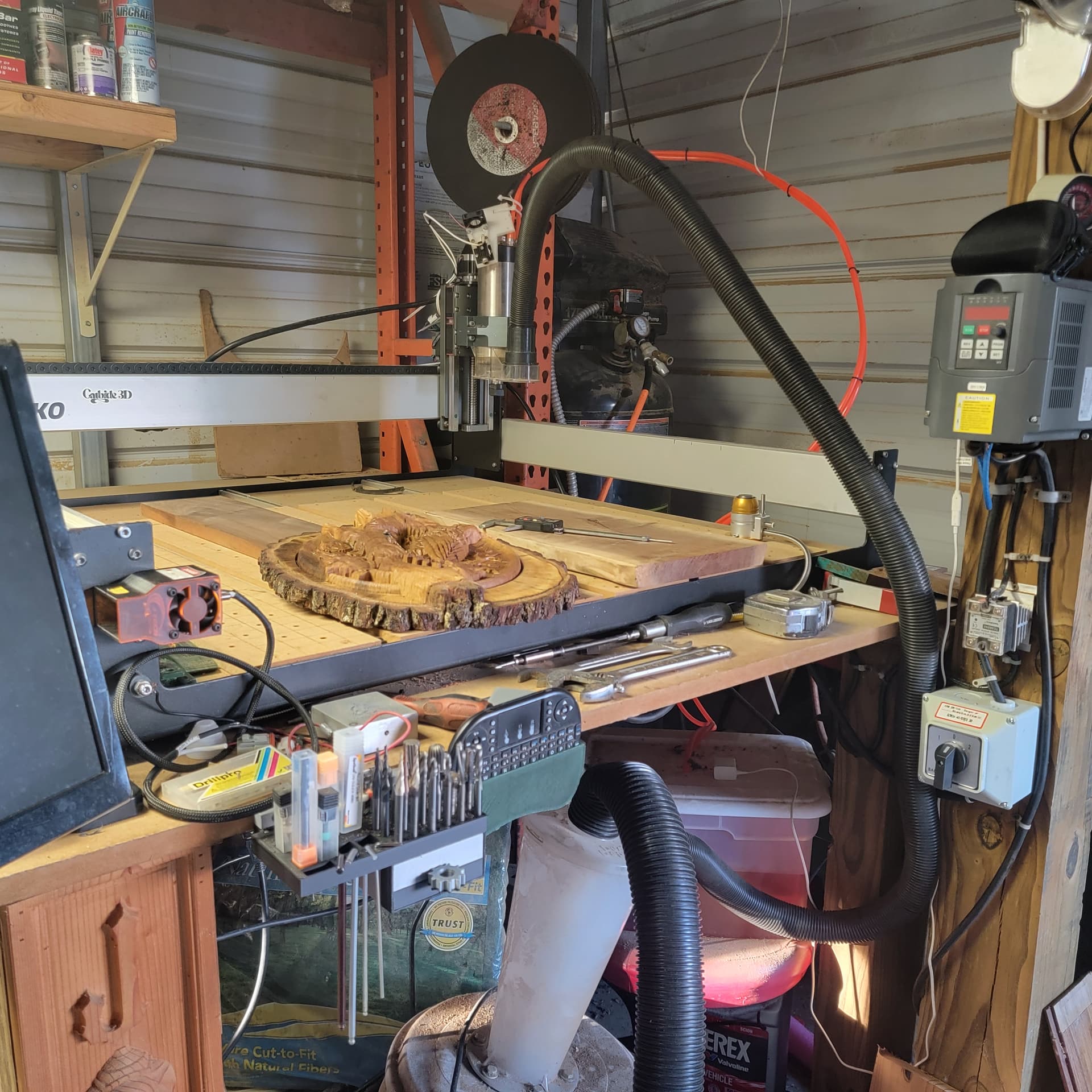

My machine and a final project
