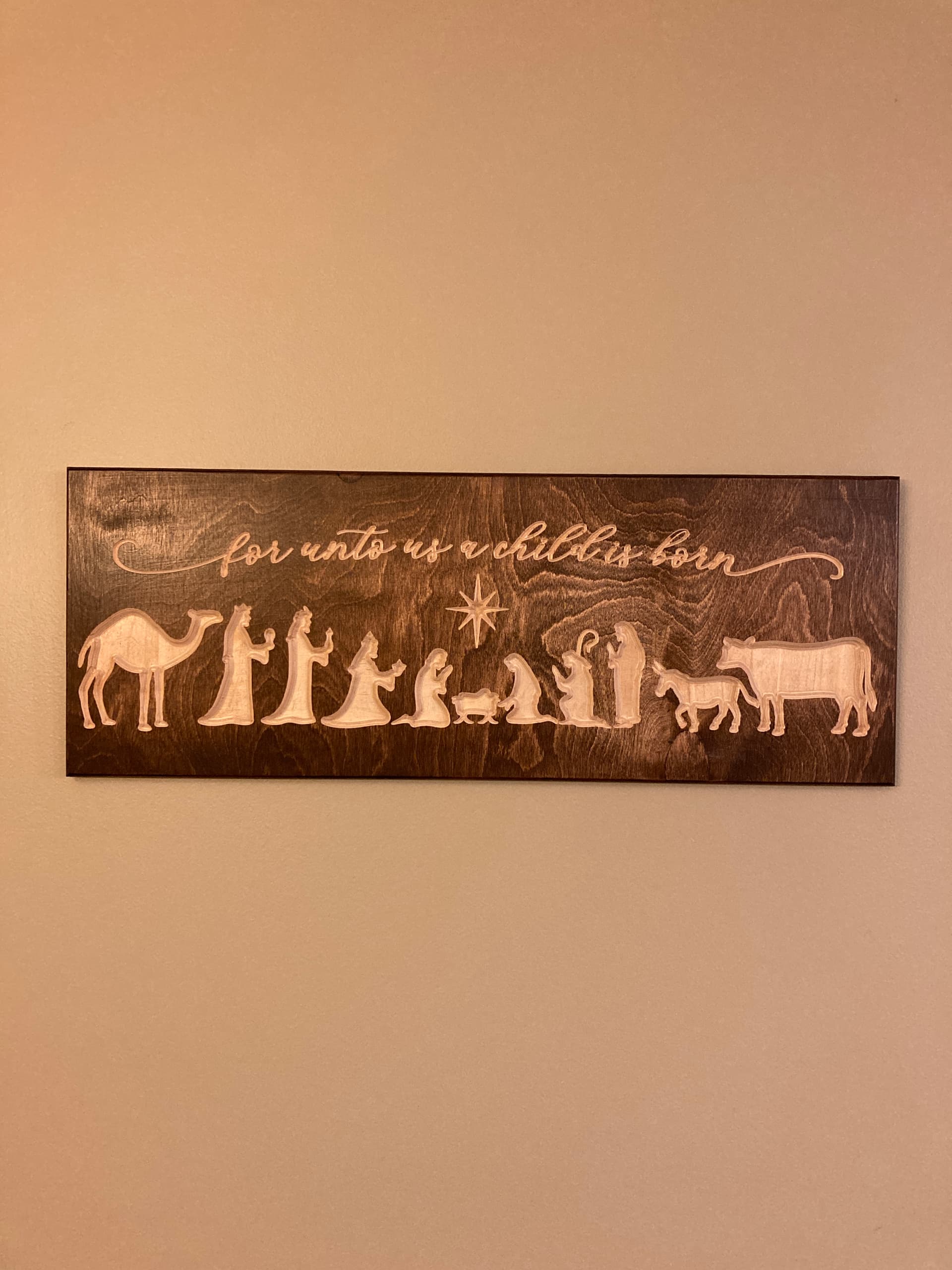

I used a piece of sanded plywood 9x 24. I finished it with Kona stain. I used a round over but to make the edges nicer. I then carved with a 1/4โ€ 90 degree v carve but set to 1/4โ€ depth. I used Oramask and was going to paint but liked natural design better. Everything went smoothly on the Longmill. Very happy with the outcome.
