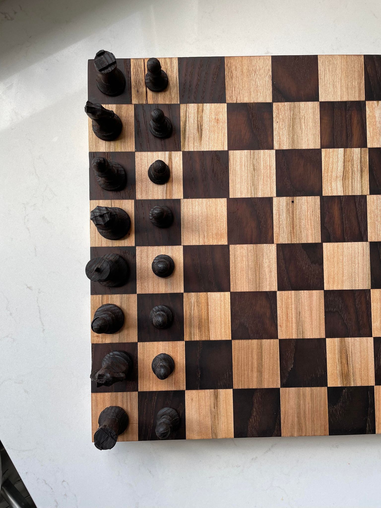

Chess set i made 1st dabble into 2 sided machining i messed up a little when sanding my tabs off i sanded the pawns bases on a bit of an angle nothing major just a little hicup. 1st real project done in Aspire and I really got the hang of it! Used Roasted Ash for the dark pieces and spalted maple for the light. Finished in mineral oil. Didnt even have to sand anything minus the board which was made seperate from the longmill.
Used this video as a Baseline guide
2 Sided Machining Tutorial
Chess Piece STL
Aspire File for all the pieces
Roughing pass was done on a 1/8th inch endmill while finishing was done with with a 1/16th ball nose end mill 2500mmpm feed and speed on the finish pass
This was roasted ash and the light pieces are on spalted maple (not pictured I already wrapped this up! rookie move
Really been working on 3d carving this year got into it with this video became really obesessed very happy with the detial that came out of this
