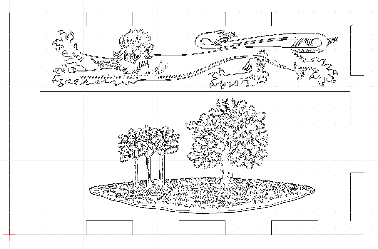

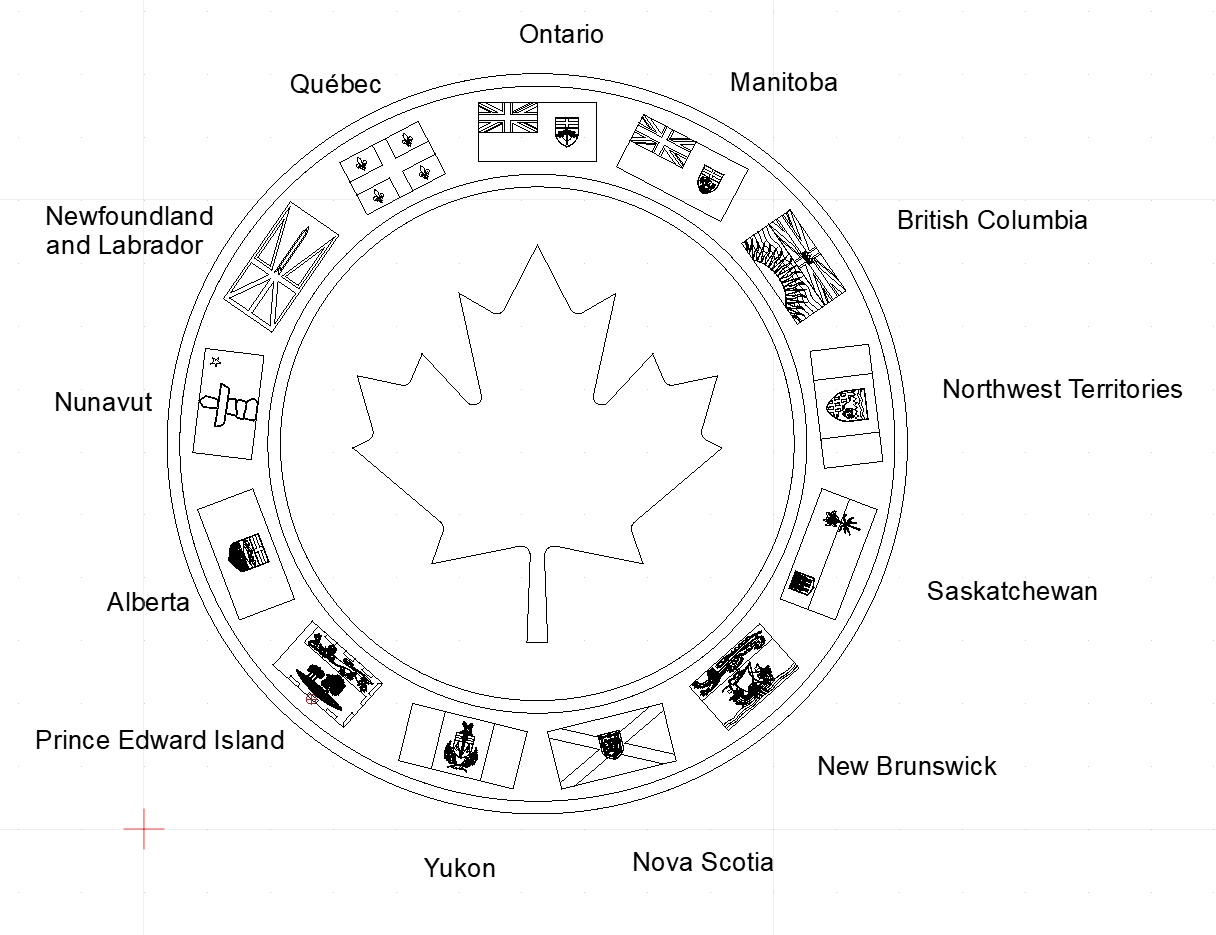

While waiting for the Altmill, I did the files for all the flags and arranged them around a red maple leaf. The provincial flags are small, about 3" x 4" so the level of detail I have in the files will need to be reduced depending on the quality of the carve.

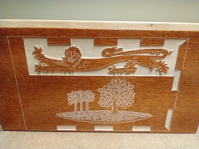

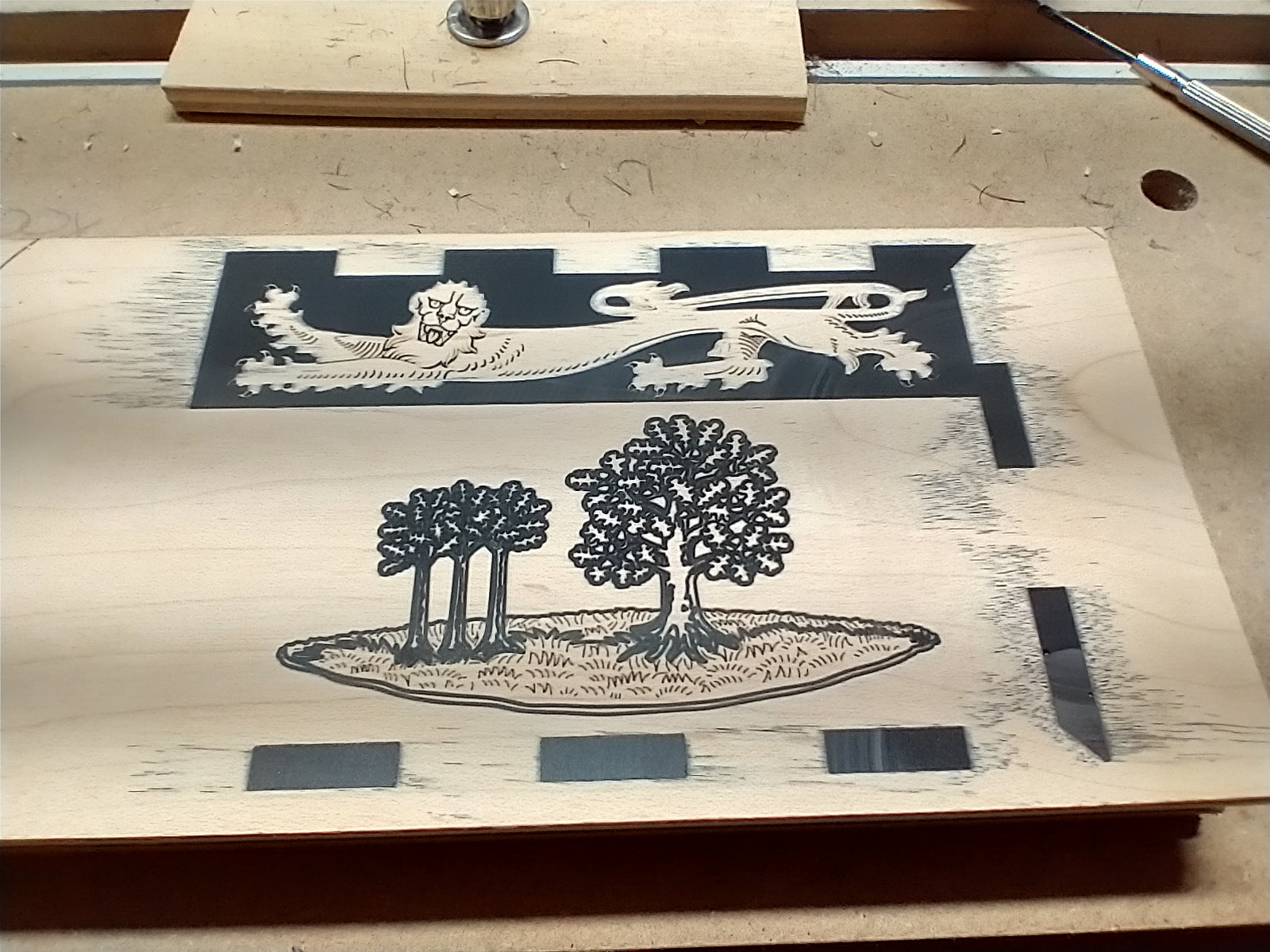

I’m currently working on the flag for PEI. It has a lot of very fine detail, so choosing the correct tools and removing some of the finer details will be required. I suspect some trial and error will be required.

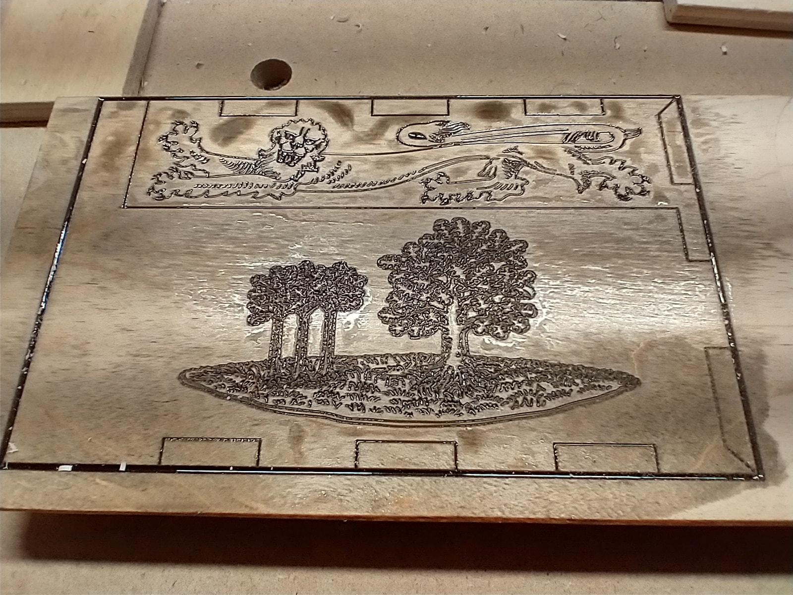

I carved the flag on a piece of maple hardwood flooring. I didn’t surface it before so it probably wasn’t entirely flat. I think I’ll make the recess 0.5mm instead of the 1mm I have now. And I hope to make the grooves inside the lion and the trees a bit deeper. Currently using a 60° v-bit for those
I’ll try again tomorrow but will surface the maple first. The lack of contrast in the carve will surely make it more difficult to see the detail.

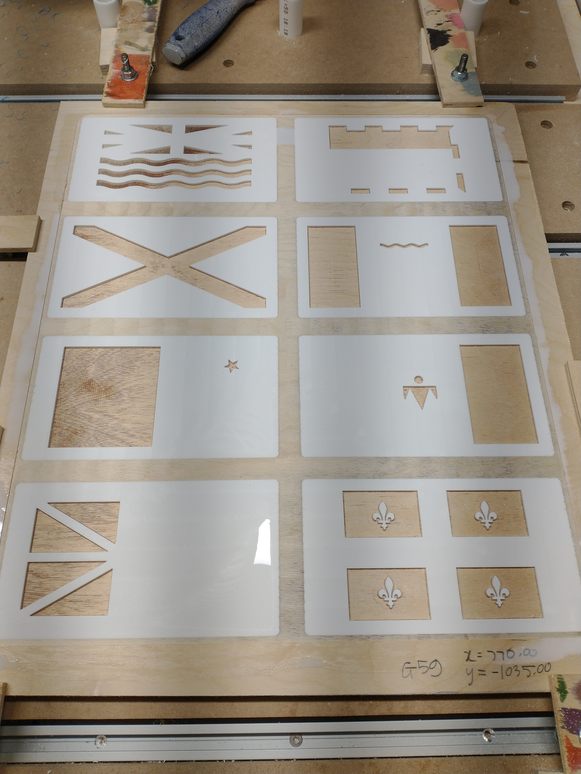

I decided to go full colour.

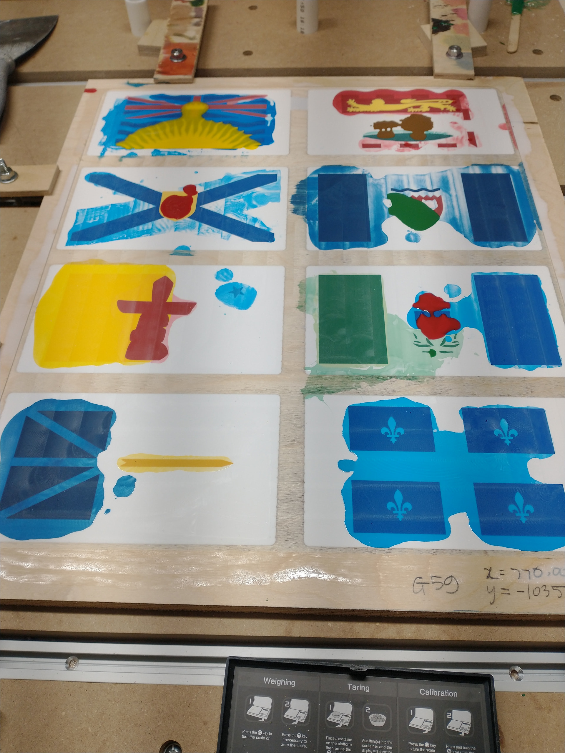

Because there is a lot of curing time to wait in between epoxy pours, I am doing them in two batches. The first batch of eight will comprise the flags with a high proportion of white for the field. The picture below is of the white epoxy layer with the first pocket carve that I’m about to fill with coloured epoxy. Some flags only require one colour. Others will need to be done in multiple steps, via a combination of pocket cuts of v-carves.
Colours will be approximations as all I have are blue, red, yellow, white, and black pigments. And while I have the Pantone or RGB code for most of the colours, there’s not really a RYB equivalent. I have a colour wheel and will work with that to get an approximation.
I finally had a use for the different workspaces in gSender. Since a part of the mill is reserved for this project, I have a separate workspace with it’s own zeros. I can use the free space to do other small carves in the meantime.
Note to self:: do not use a surfacing bit on epoxy without using the dust shoe. I have epoxy strings all over the place.

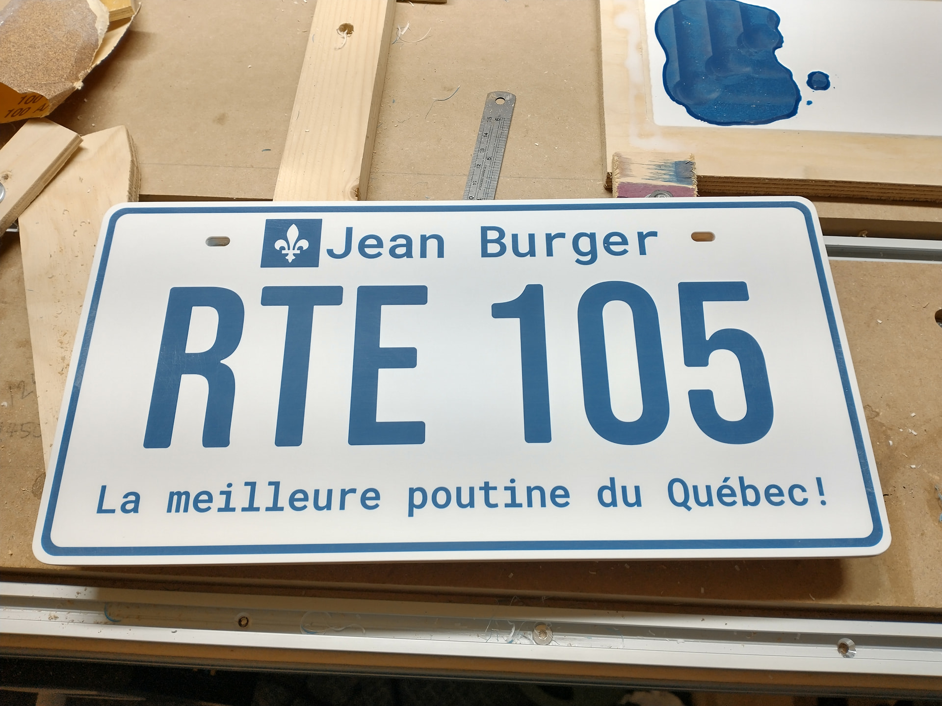

While waiting for last night’s batch of epoxy to cure properly before surfacing again, I completed this epoxy project I made for a restaurant that I frequent when going to my cottage. They have a wall of vintage license plates and I figured this would make a nice addition. It’s located on Route 105 in the province of Québec. An unsolicited gift from me to them.
Fun fact: There are a few photos of Arnold Schwarzenegger flipping burgers when he was there many years ago. I guess he was famous enough to have a photo op. Probably Conan the Barbarian era or earlier.

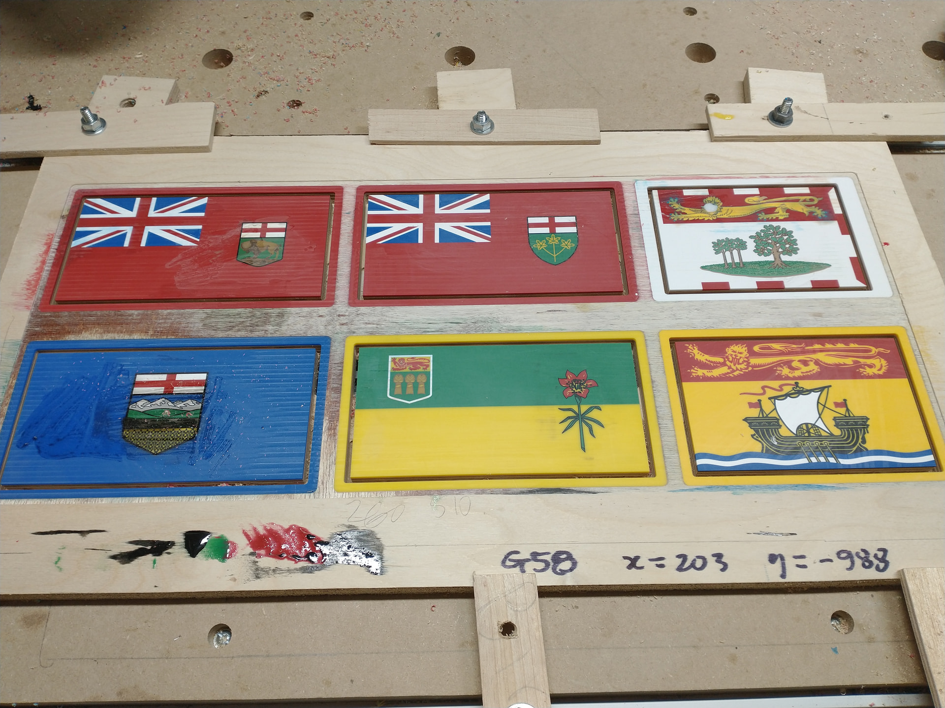

Coming along nicely. The large pockets have been done. Once this morning’s epoxy cures, I will do a final surface. Then it’s just a bunch of v-carves. Any epoxy excess in the carves will just be removed by sanding.
Colours are still hit and miss. I’m going to have to do a colour palette with the corresponding pigment proportions for any future project.
The nice thing about working with epoxy is that any screw up can just be carved away and re-poured.

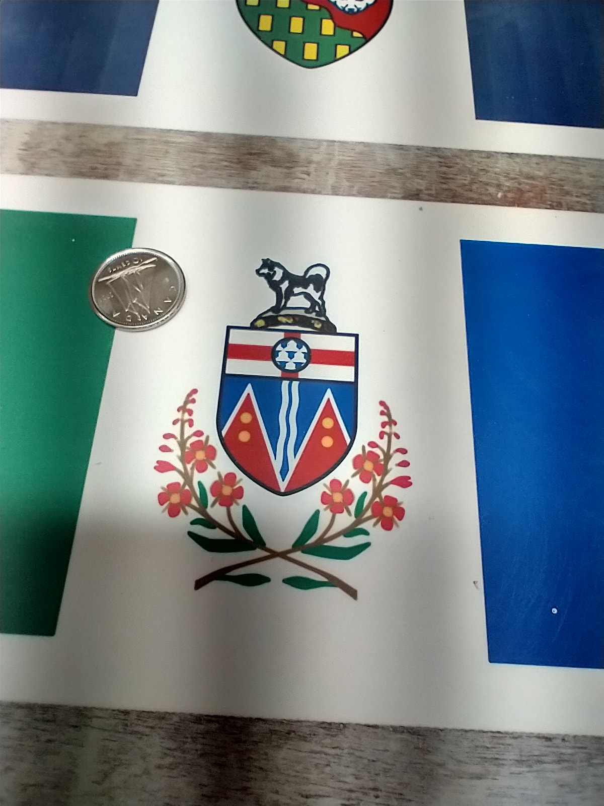

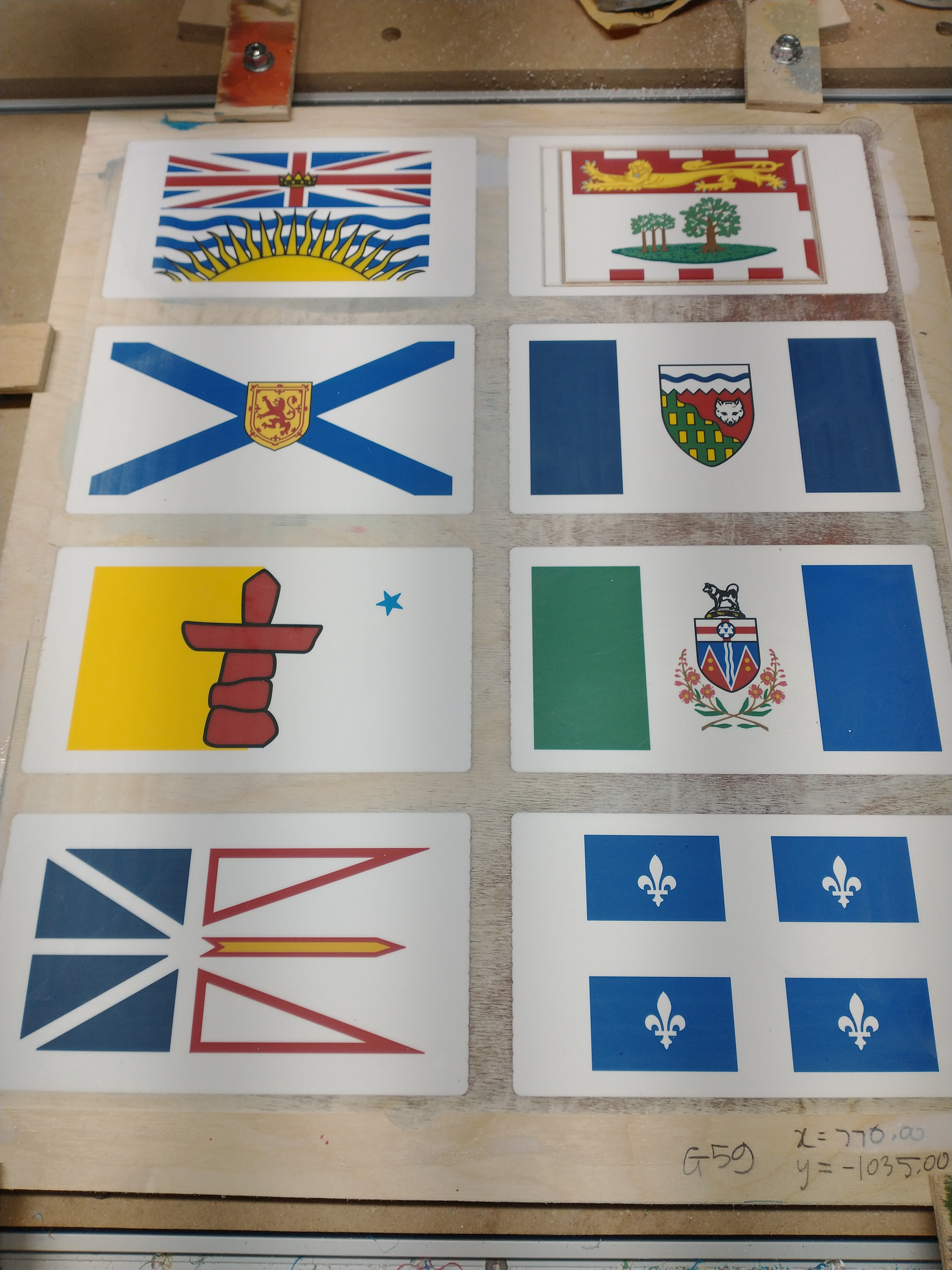

Done with the first 8 flags. I’ll cut them out and once the epoxy has cured for several days, I’ll wet sand it down to low luster. Some of the details will be more apparent as well. For example, just below the dog, there’s some red and yellow hidden by a thin layer of black. That will be sanded off.
I must say I’m impressed with the Altmill’s precision.
I removed some of the details from the carves because I thought they’d be too fine for the Altmill to carve. Maybe I should have left them in. I could out them back if I wanted to, but I’m not going to attempt it. They are small enough that they are only noticeable up close.
Now that my technique has been refined, the next 5 should go faster. The order in which the carves takes place makes a difference in the crispness of the carve. I now know what needs to be done last.

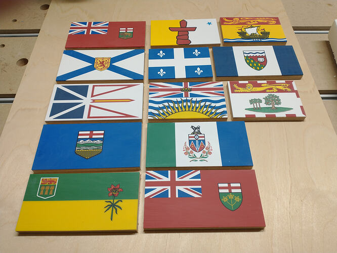

Just completed the remaining 5 flags. Actually, I had spot for an extra flag so I re-did the one for PEI with some additional detail. Now that they’ve all been cut out, I will sand the epoxy with wet/dry sand paper to a low shine.

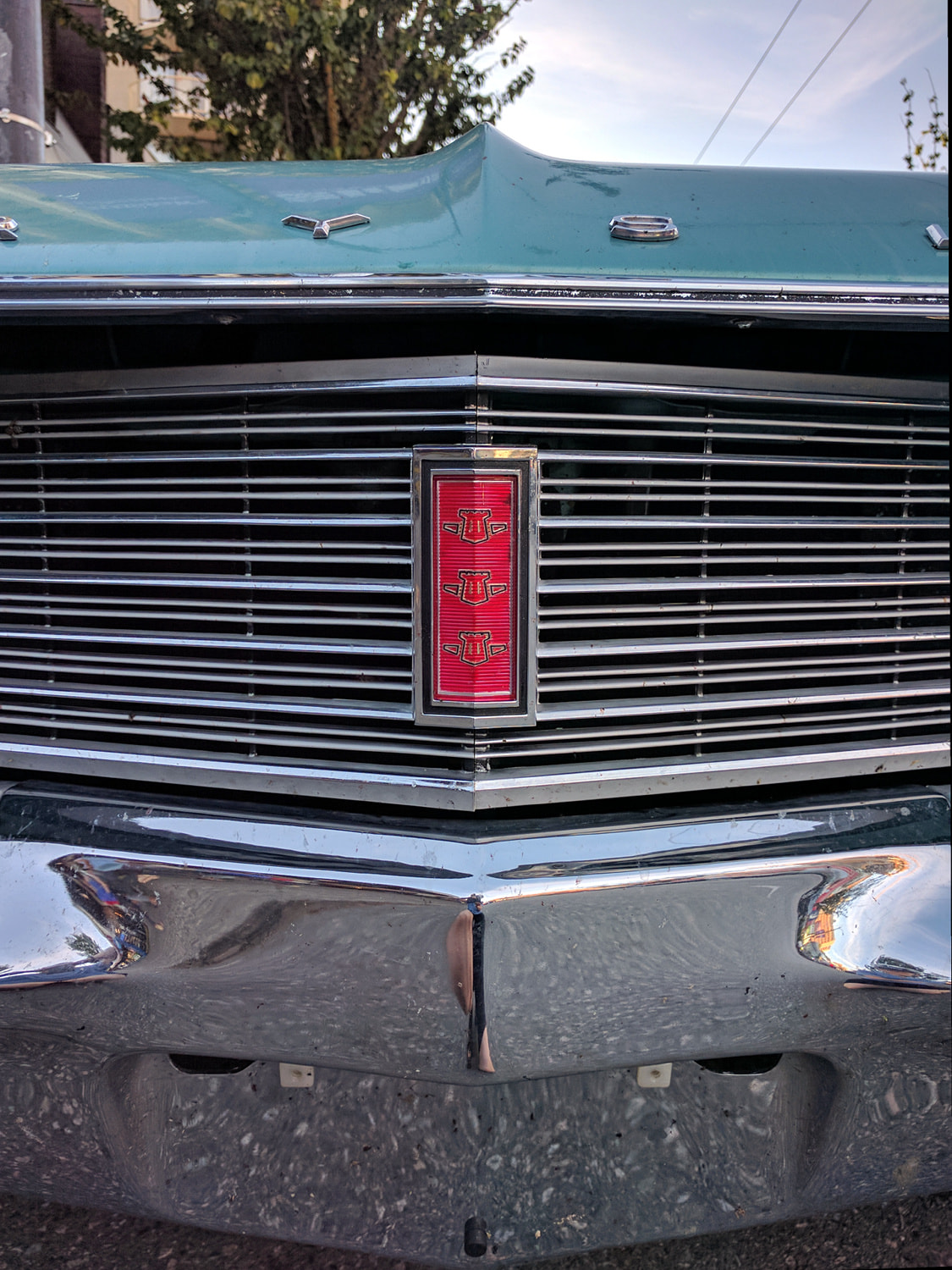

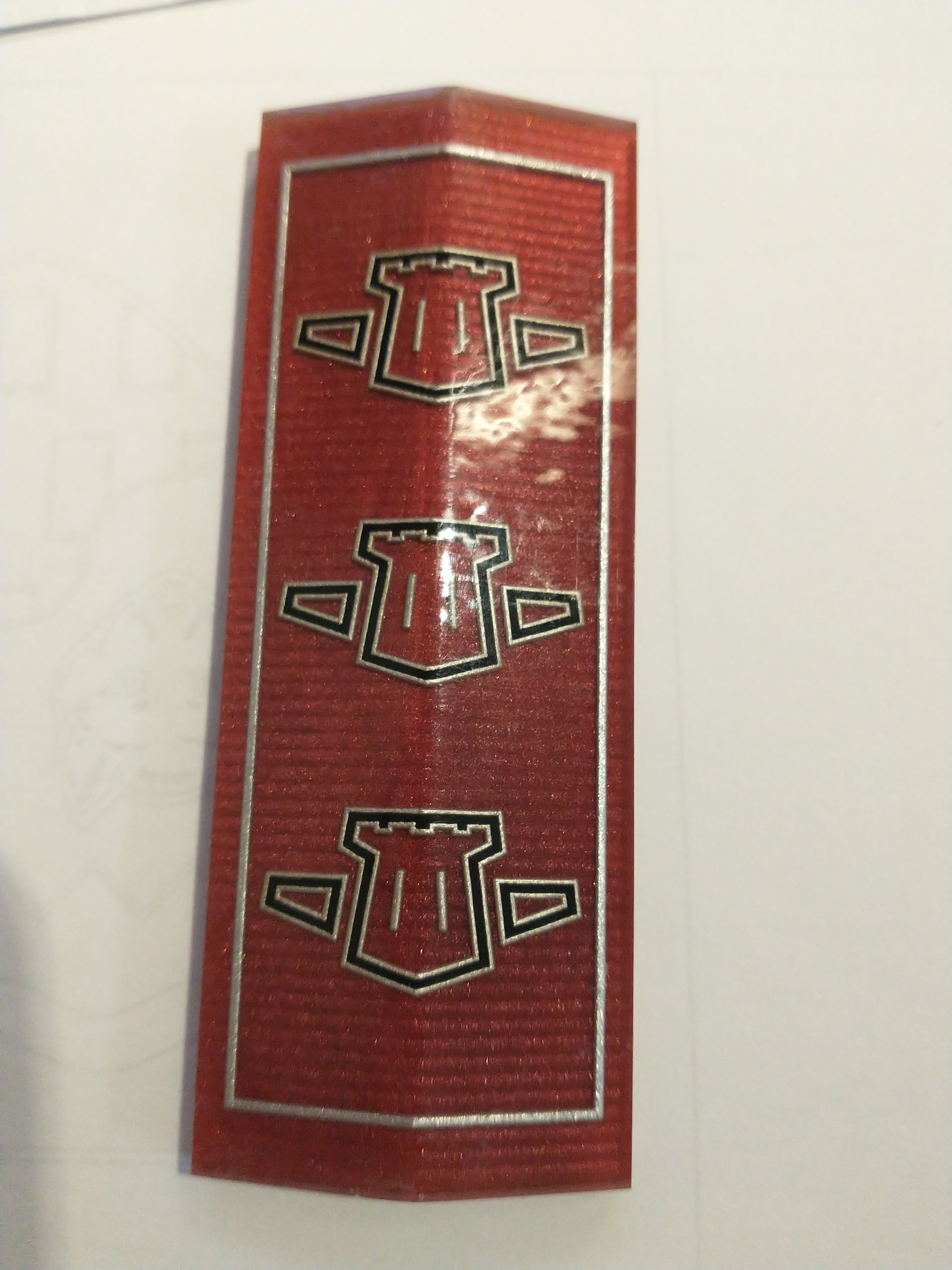

I was sidetracked a bit during the Christmas break. I’m not a car guy, but the father of my daughter’s boyfriend is. He has a 1968 Chrysler Newport. The grill emblem on those things tended to crack and they’re impossible to find (used or NOS). We were chatting about plans during his retirement and he mentioned trying to make a replica of the emblem. He wasn’t sure how to approach it, especially on painting the lines for the towers. Long story short, I told him I could probably do it on my CNC. And since I was using epoxy for my flags, I could see what I could do with epoxy. Anyways, it turned out pretty good.
Here are all 13 flags after a quick pass with 600 grit wet and dry sandpaper. I’ll move up grits progressively until I get the gloss I want.

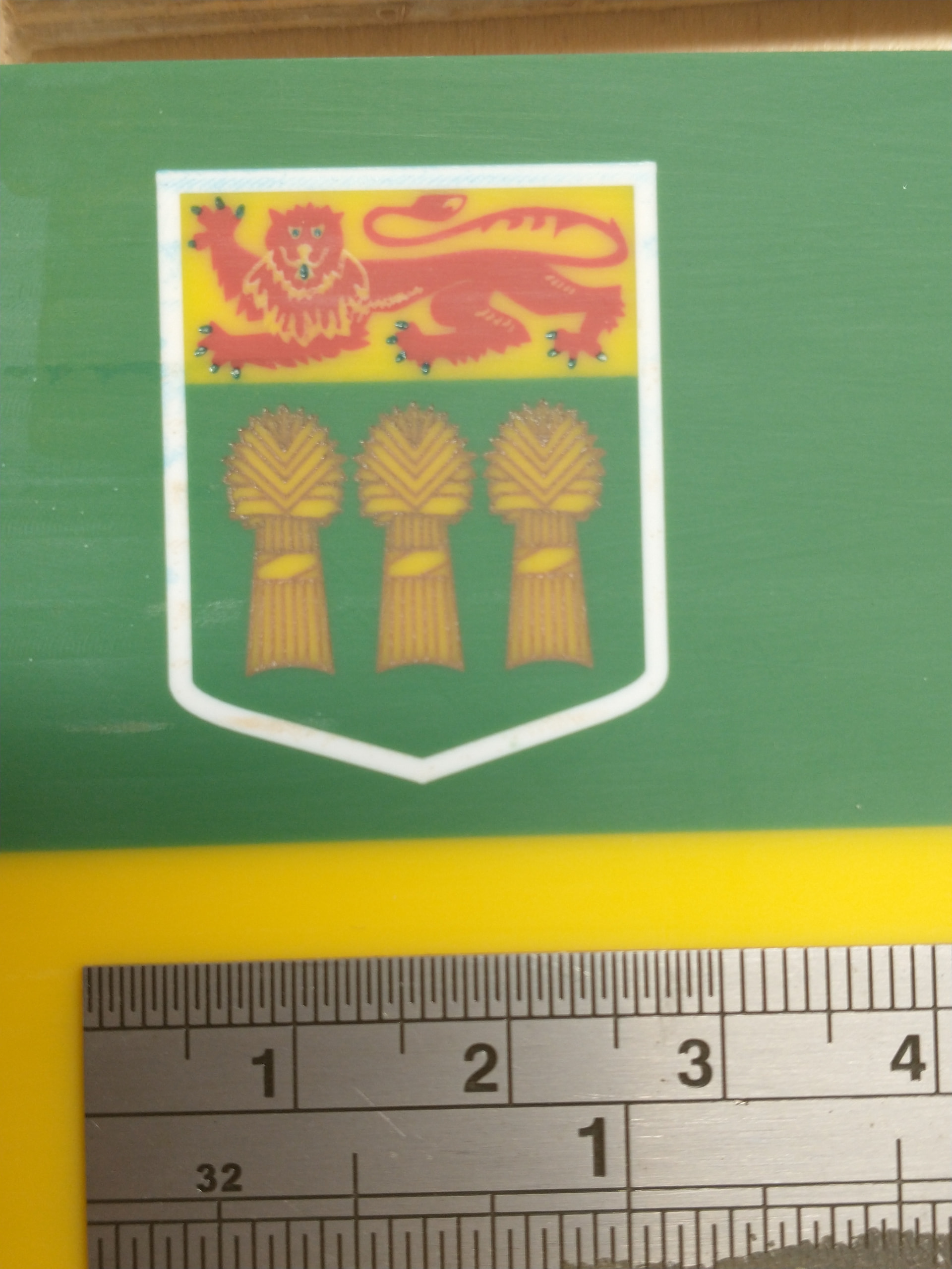

The second batch has finer details than the first. Several reasons for that. One, I used a 30° v-bit for the carves. Second, experience and technique.

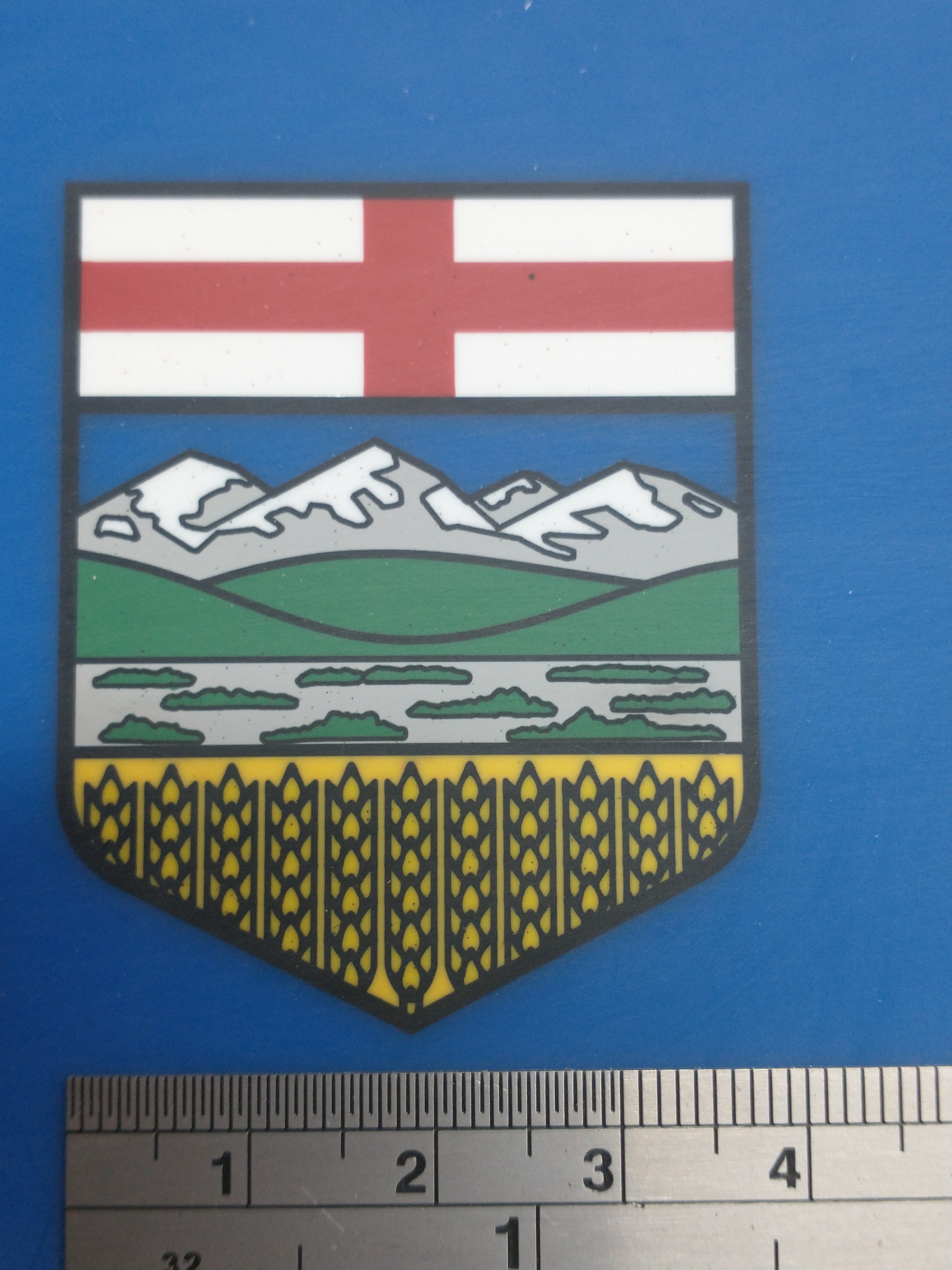

Here is a close-up shot of two of the flags. A few specks of epoxy that I need to sand off show up in the pictures. But they’re not really noticeable to the naked eye. There might have been some micro bubbles in the epoxy which got filled in with subsequent pours. But I think most of them are just surface spots that I didn’t sand away yet.
I definitely need a better camera!
Next step…the 36" diameter medallion with the Canadian flag or maple leaf in the middle. Not sure what I’ll do yet.
