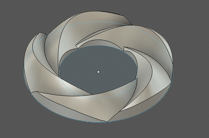

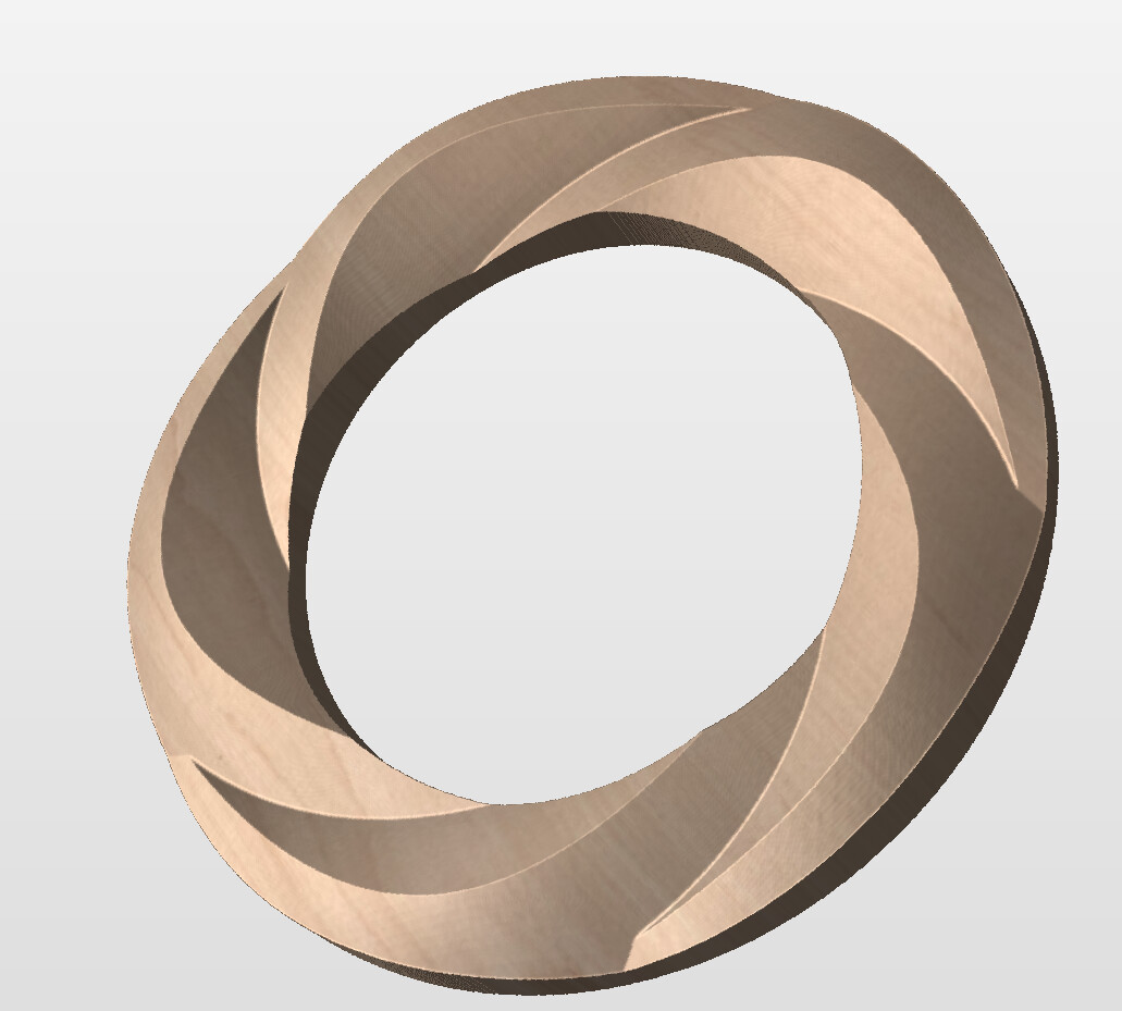

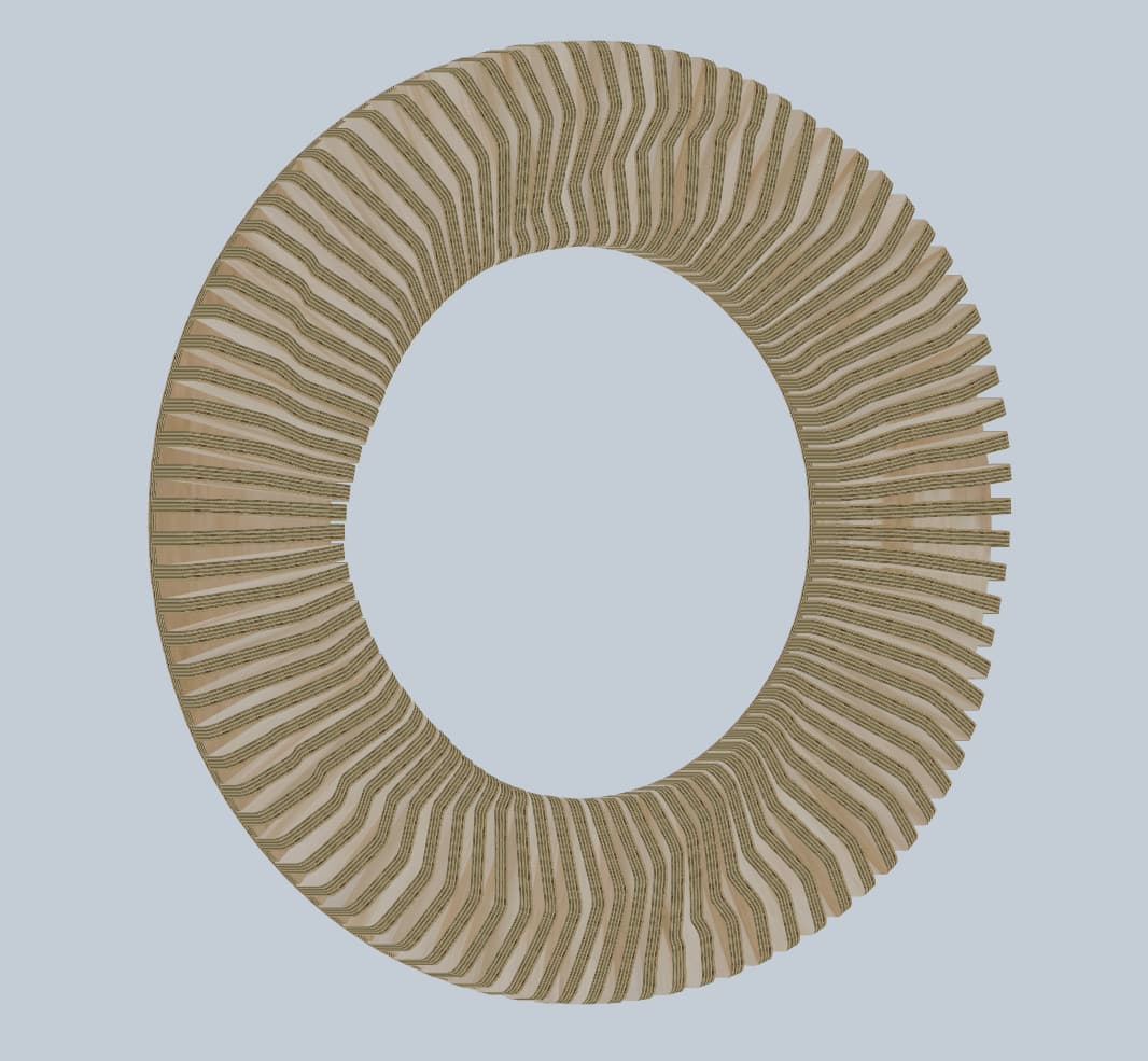

I decided to make a projects page for some of the stuff I will be doing. Now that winter is approaching, I will start using my Altmill a lot more. My second project is a mirror frame. Last winter, while waiting for my Altmill to arrive, I was playing with Fusion to see what interesting things I could do. I am not a modeler by any means but I figured that interesting shapes can be made fairly easily just by trying things out. One of the first designs I came up with can be used as a picture frame or wall art. With the Autodesk Slicer program. it’s possible to take a solid model and make radial slices out of plywood, which can then be assembled. Slicing is not part of this project. I’m just adding the info for reference.
I will be making a frame for a round mirror. Specifically, I will get a 500mm round mirror from Ikea, which will be inserted at the back.

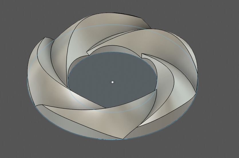

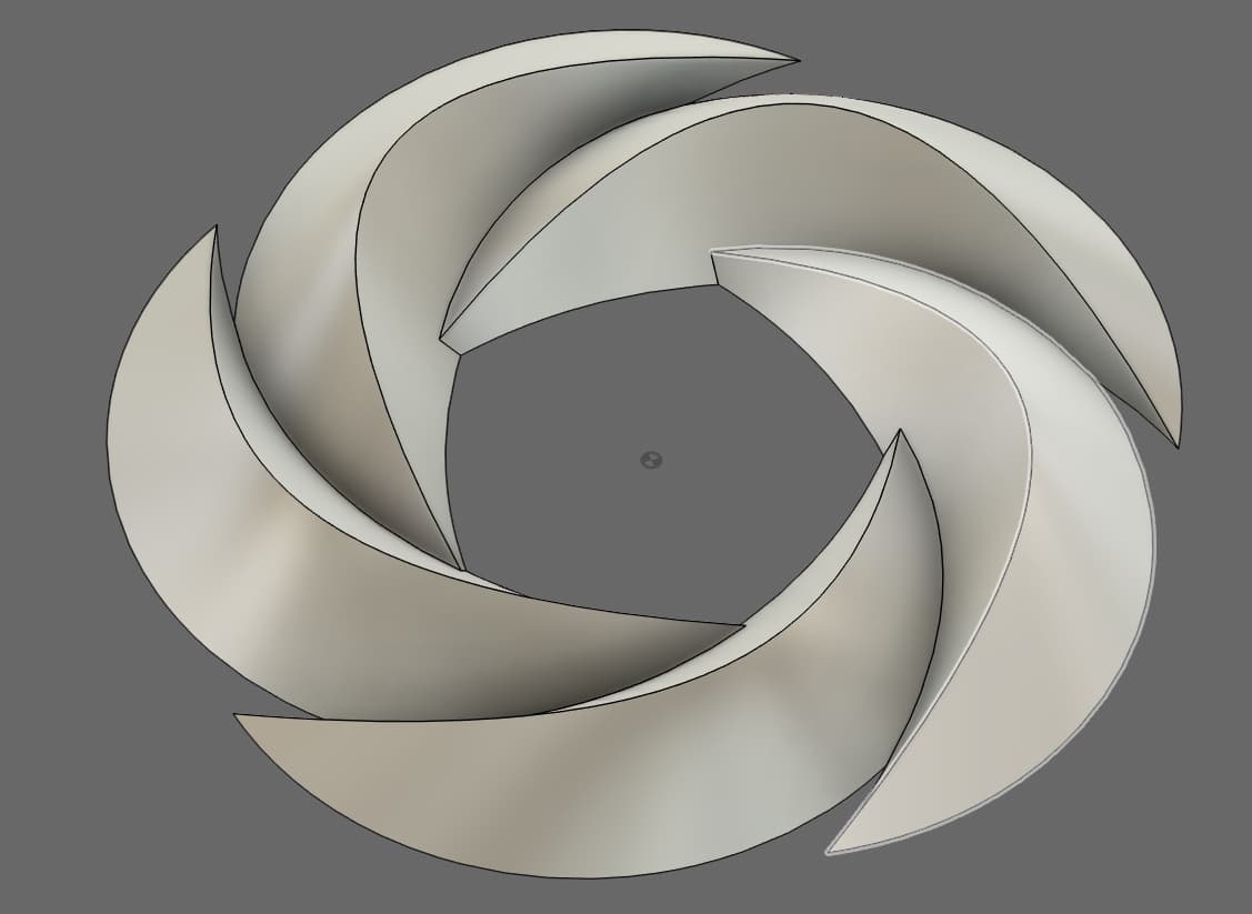

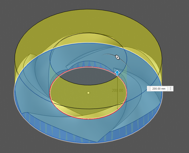

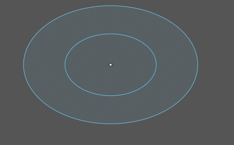

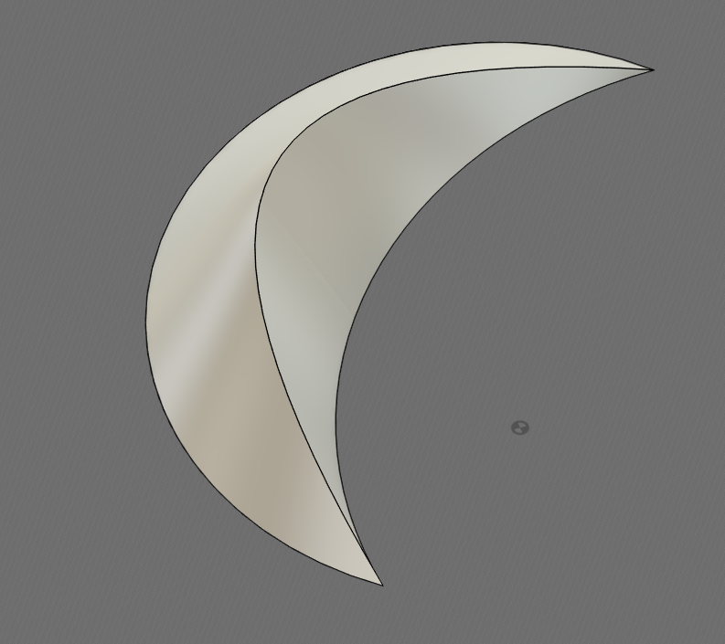

The object starts off as a crescent shape that is copied around a centre point. You then make a donut the size you want and extrude it using the intersect option to remove the part you don’t want. That gives you the basic shape to work with.
The beauty of parametric design, when done properly, is that modifying previous parts automatically changes every subsequent object. So if I went back to the crescent and changed its shape a bit, the final object would be changed as well. Ditto with the size and placement of the donut. Once you get the hang of it, it’s very easy and fast to do an object.

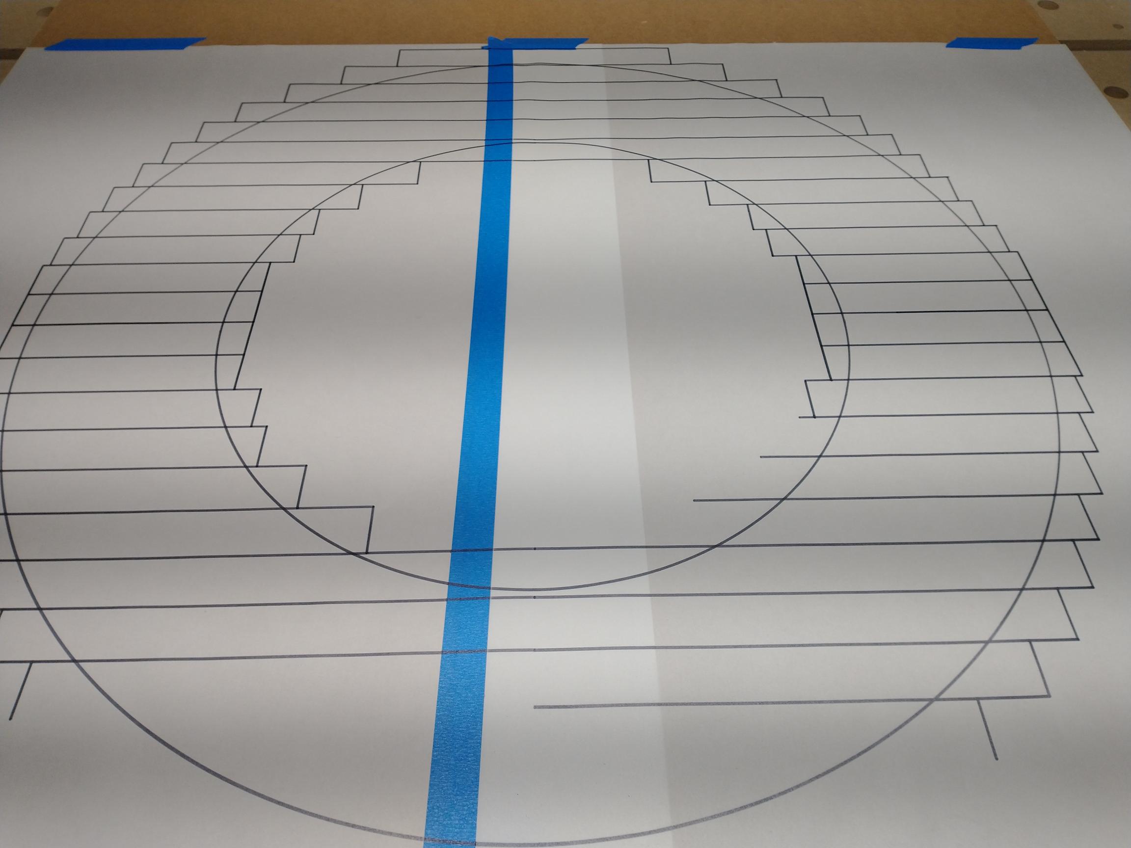

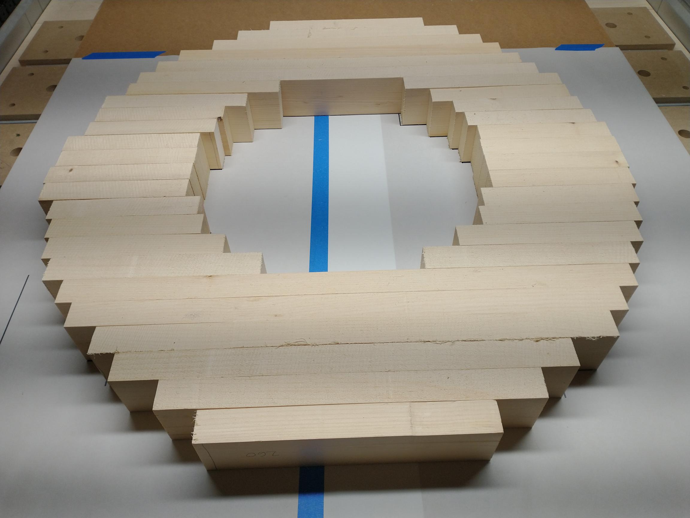

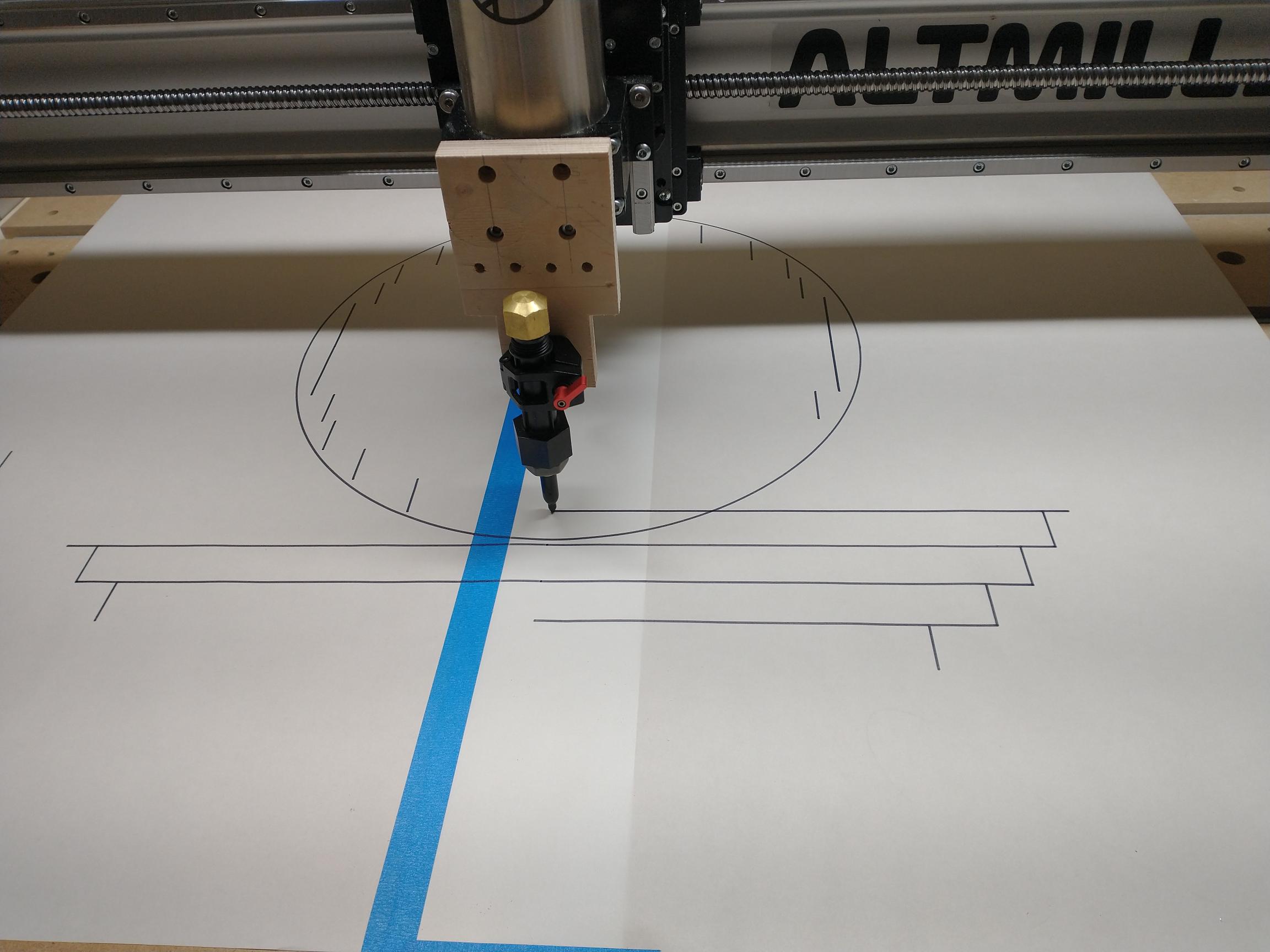

First thing I did is trace the outline on a piece of paper. That ensures that the wood pieces will be positioned properly during glue up. I then used 30mm by 65mm clear pine I had on hand. My initial plan was to use maple, birch, or other hardwood but I want to make a prototype first. Since I had the pine, I’ll use that as a prototype and if the results are good, maybe just use that as the final frame.

I thought I understood what was going on but then you decided to throw a wrench in my understanding with the slicing bit. Can you explain what is going on here?
@Jens I think you understood quite well. The slicing bit has nothing to do with this particular project. I just added the information to give another example of what can be done with the model other than just a carve. I edited the original post to clarify that.
Got it …. but it seems that the slicer program was discontinued :frowning:
It is deprecated but still available for download from the Autodesk site
Slicer for Fusion 360

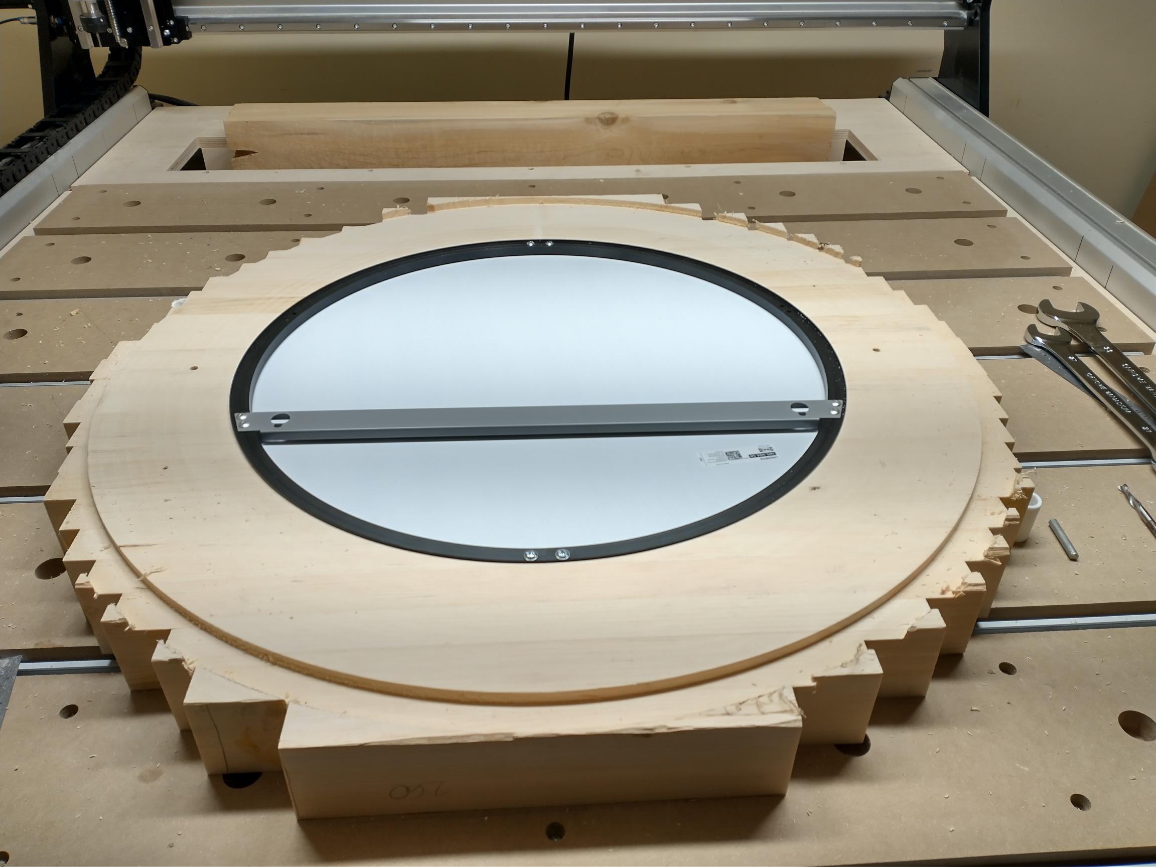

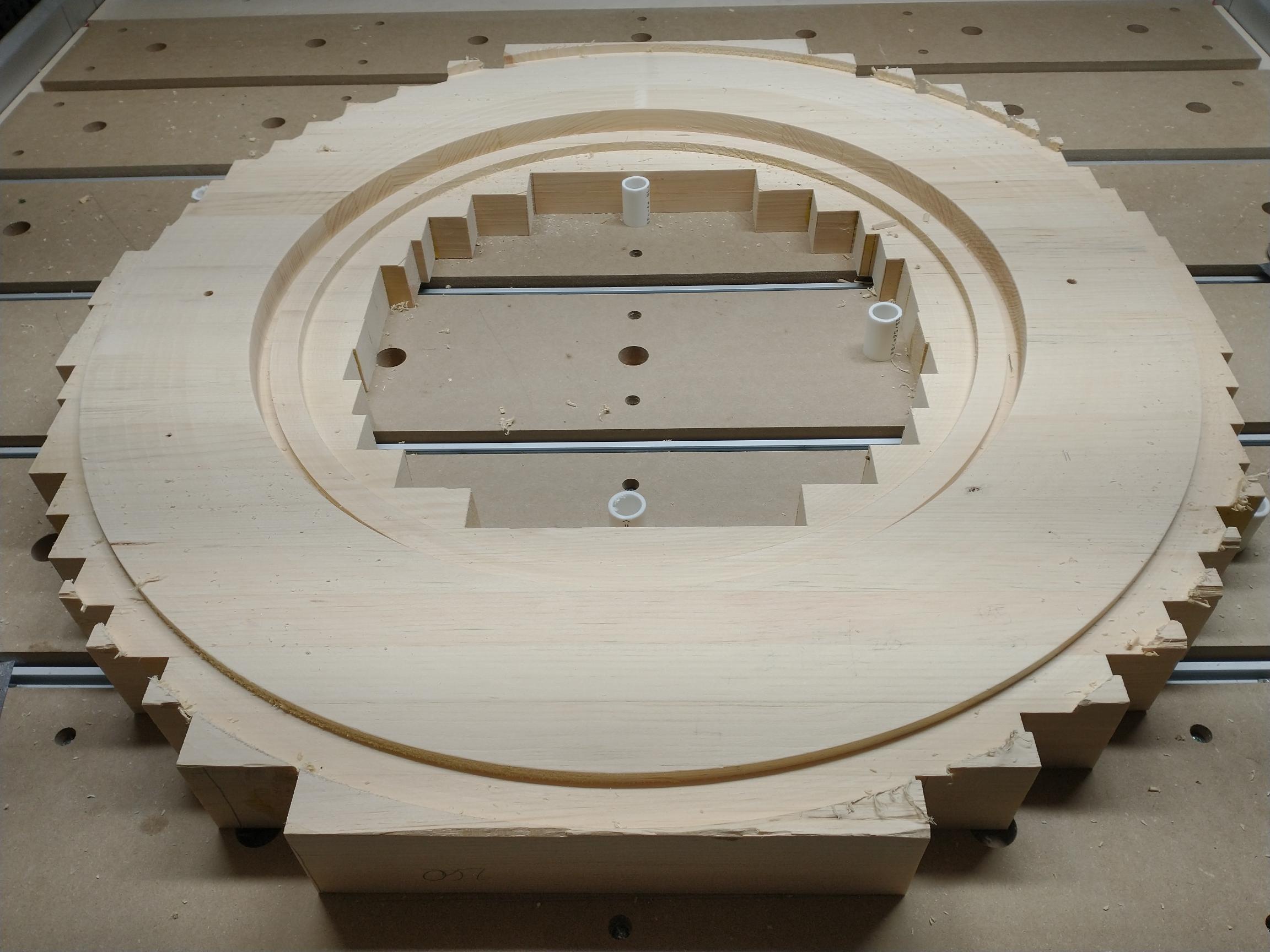

I just finished making my cuts on the back. It’s sized for the IKEA 500mm LINDBYN mirror. It will be inset complete with the frame it came with. I could have removed the frame but decided to keep it.
Compared to the surfacing bit used yesterday, my 1/4" flat end mill is way noisier. I’m guessing its length may factor into that. I needed ear protection.
This is my first big project and I must say it is a bit nerve wracking. A lot of things to think about while you’re setting up the toolpaths and again while the Altmill is making the cuts. Especially on a 2.5" deep carve like this, you need to make sure there’s always enough clearance. I’m using the default feeds and speeds that are published for the Longmill. I hope to increase them as I gain more experience.
I’m not sure how I’ll cut the inside and outside edges once the other face is done. I might use the Altmill if there’s enough clearance to cut the entire 2.5" depth. If not, I cut out a recess to use as an edge for a flush cut bit on my router table.
Wouldn’t that just be a matter of cutting 1.25” off when you are working on each side?
In theory, if your registration is correct, there should be no discontinuity where the cuts from either side meet. If there is a little bit of an issue, sanding should take care of it.
Hmmm, yes. But that ship has now sailed. Like I said, lot’s of things to think about :slight_smile:
Now I remember…
the dogs would have been in the way of a deeper cut.
That’s why God invented double sided tape …..
If the ship has departed the harbour, how are you planning to register the other side?
In the pictures, you can see two 1/4" holes on each side of the frame. Those are registration holes for a plywood base that will be screwed into the frame to hold it down. The plywood has the frame’s centre point drilled in to set my XY zeros.
Since you have registration holes, why did you decide to involve the plywood board when you could have just put registration holes into your spoilboard and flipped the model? (assuming you have double sided milling sorted in your mind).
I guess that would still involve double sided tape since you can’t use clamps.
The plywood is screwed into the frame and held down via the t-tracks. Not sure how much I can trust double sided tape yet. I’ve used it to hold down plywood and know it’s strong in shear but you need good contact and this is a 700mm diameter piece which may warp a bit. I didn’t want to chance it.
