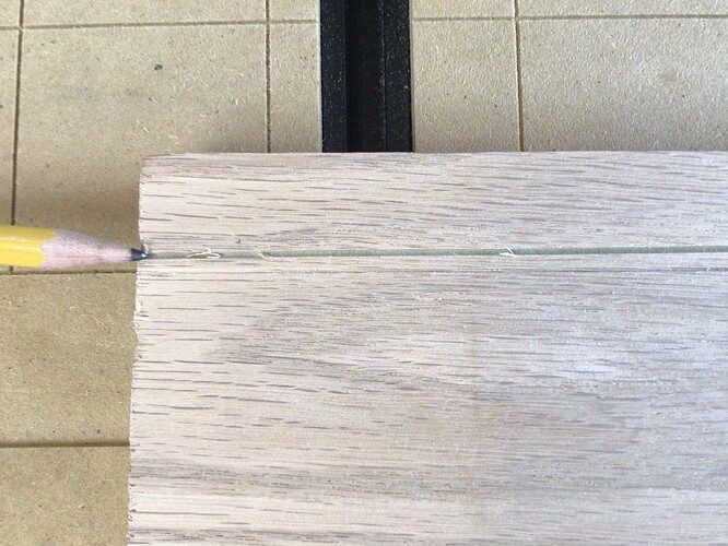

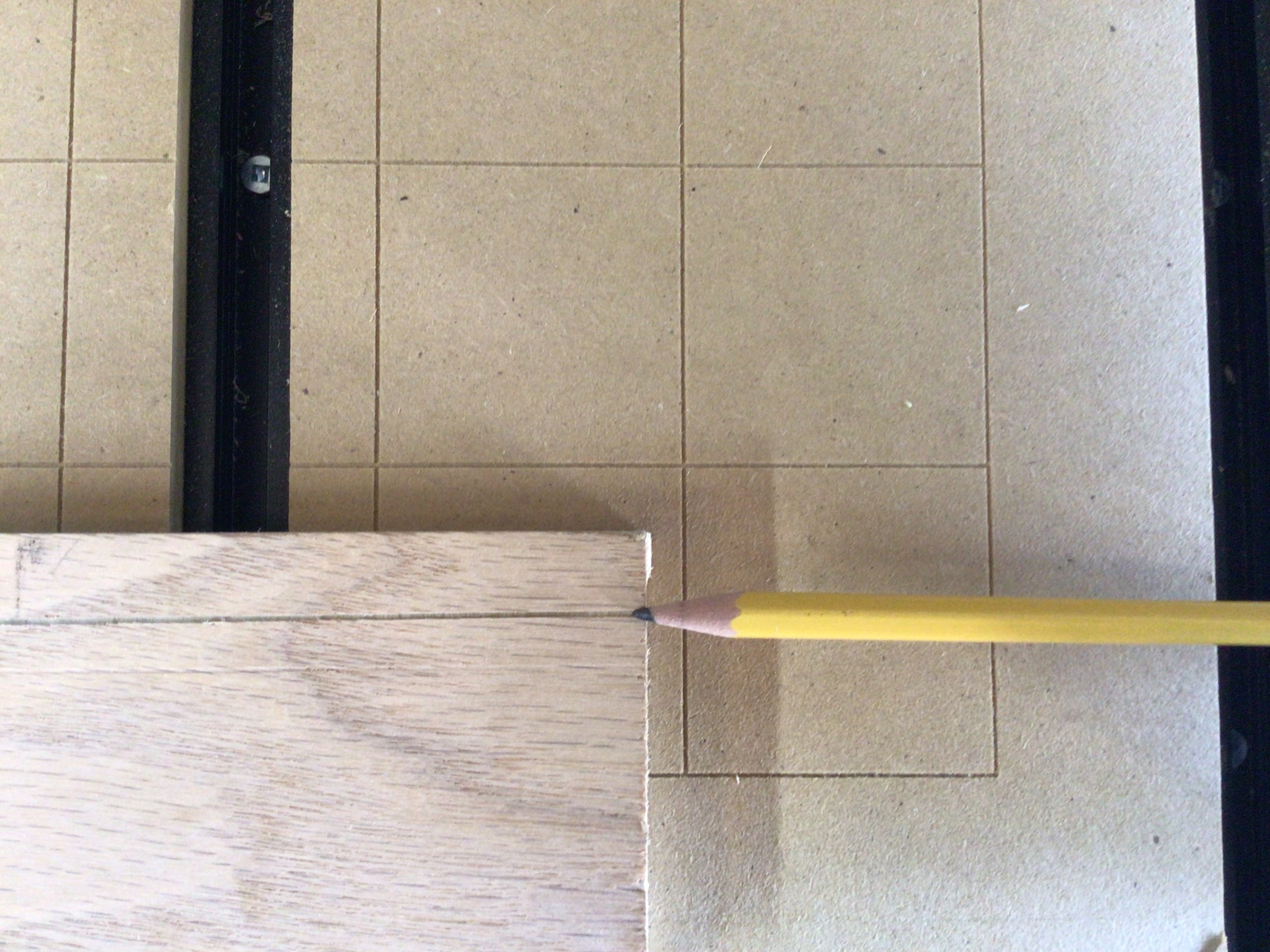

Here are the pictures of the cut on the board. The first is the start of the cut and the second is the end.

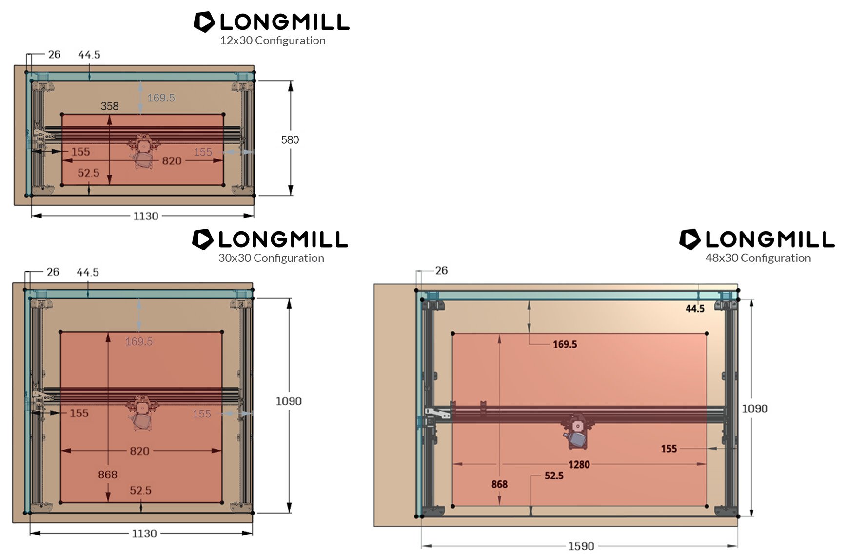

Why do my measurements of the machine not match the dimensions given by Sienci. The overall length of the machine end of foot to end of foot should be 1090mm, I only 902mm? The width is spot on at 1130mm.

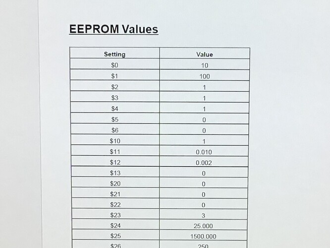

Ok, last question for tonight. I just ran diagnostics and my $3 value is at 1 and the default is 5, could this cause any of my issues?
No.

  2. I can’t get my head around the test board you posted. I’m assuming the carve is a line running along the X axis. There is no Y axis movement involved at all. To me, that would indicate that the board was not held down parallel to the X movement. Further, if you held it down parallel to the grid lines you carved, the test board would be fine. So, it seems that, after you carved the grid, you changed something. That’s not a criticism, just an observation. Now, then, the grid is no longer an accurate depiction of how your machine is moving. When you line a test board up to the lines of the grid, it will always be off.
