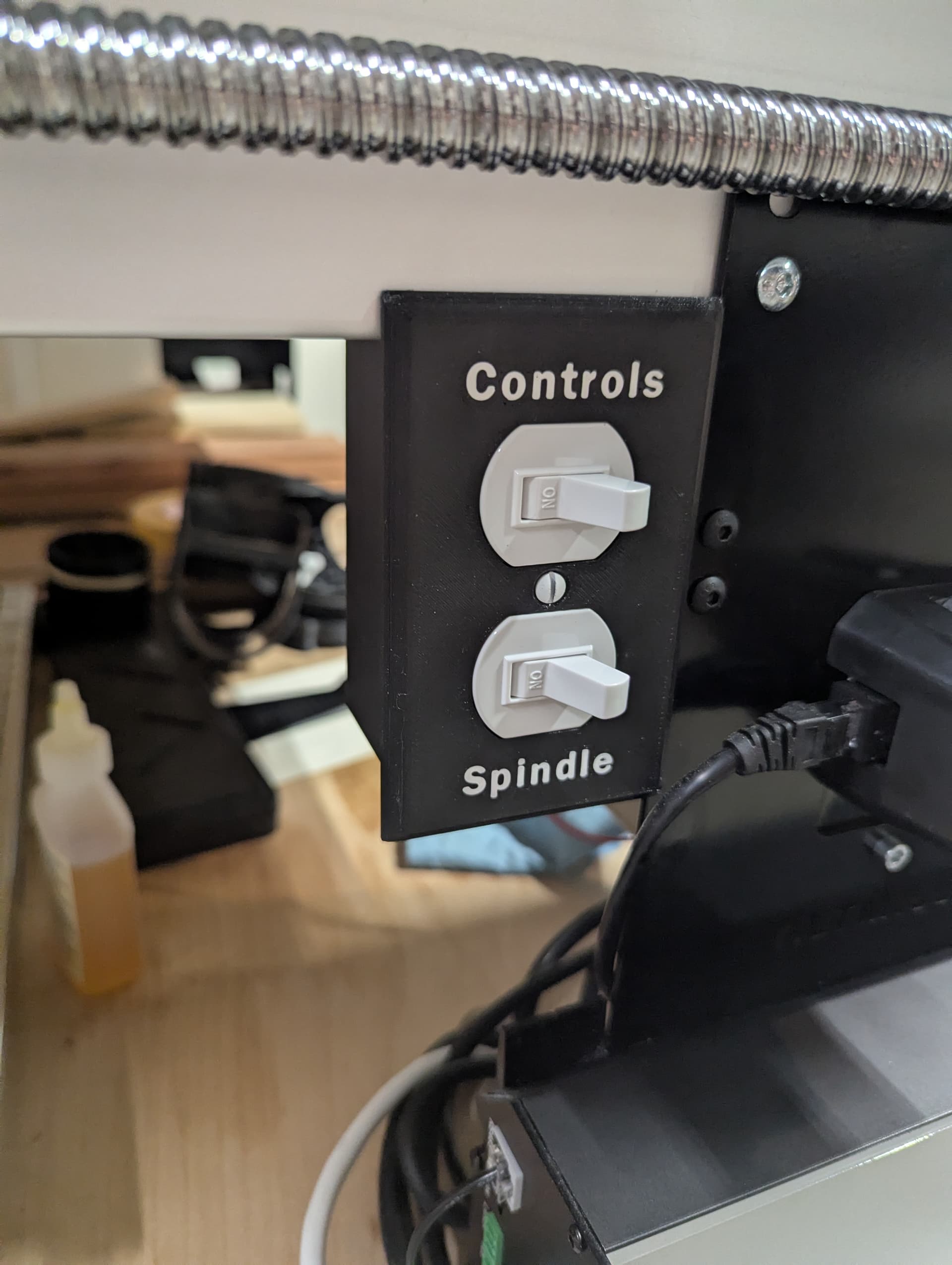

Contactor/Relay box

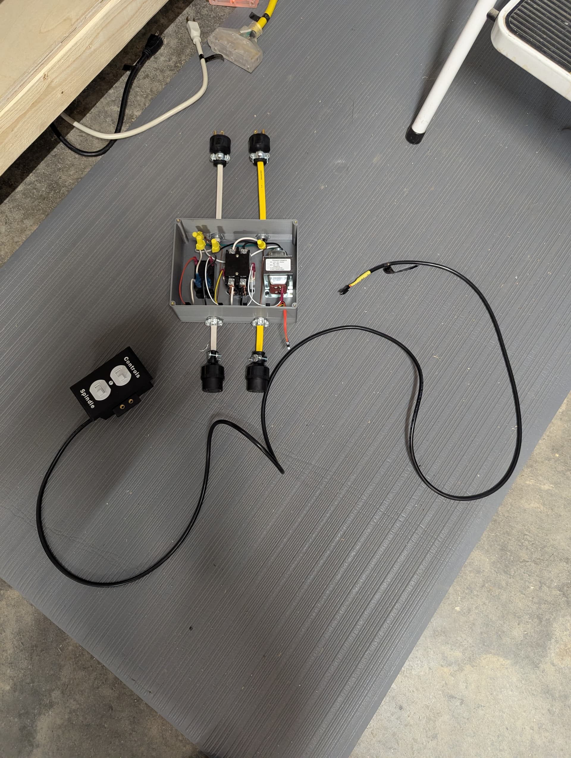

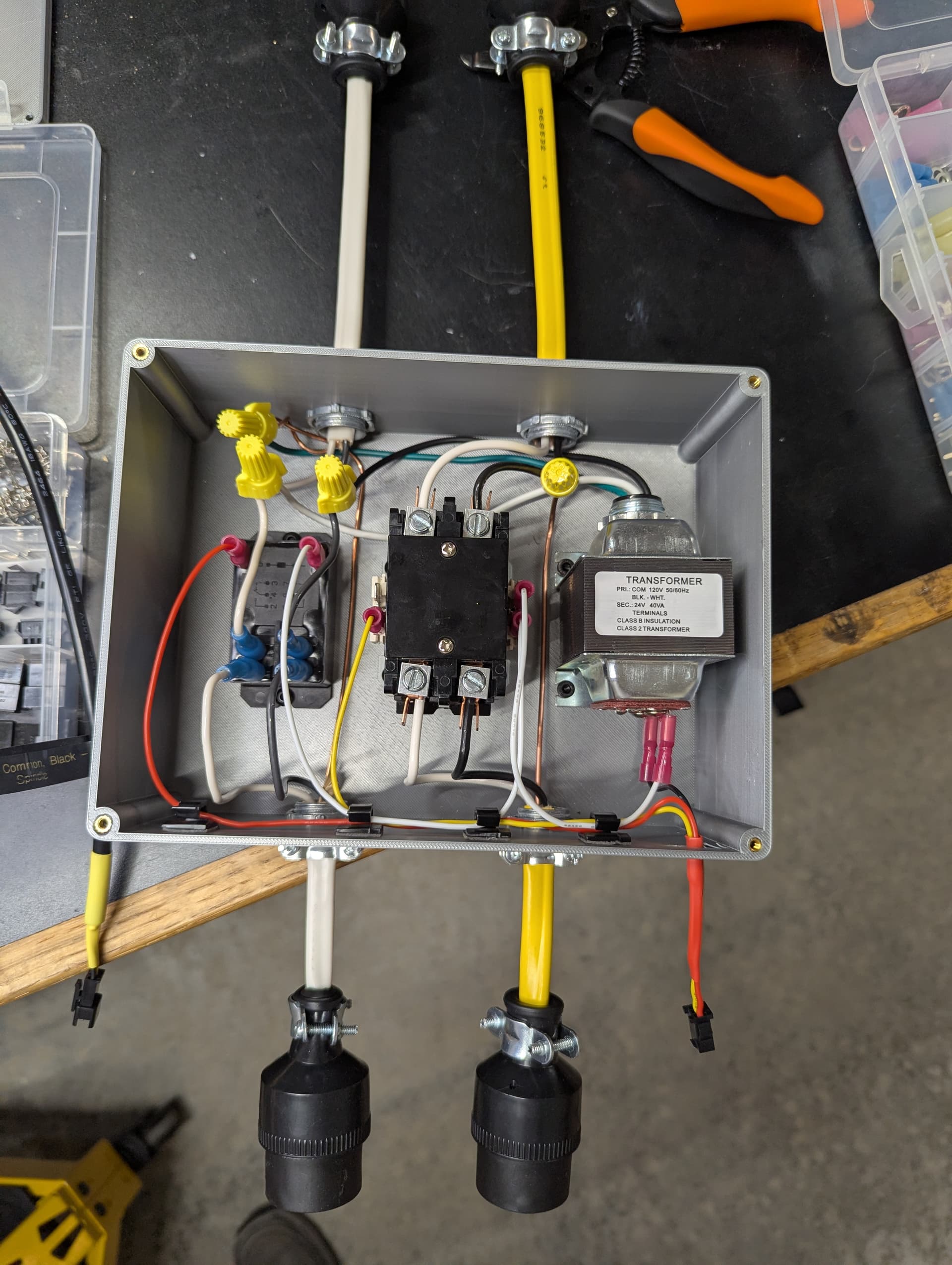

I was annoyed with the fact that I had to unplug cords to turn off my Altmill so I decided to make a control box with a relay and contactor to control both the Altmill and Spindle circuits. I used a 24vac transformer to power the relay/contactor and my switch operates the relay/contactor by breaking the 24v low voltage circuit. I 3d printed the box for the switch, switch plate and the control box.
