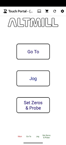

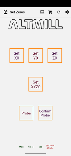

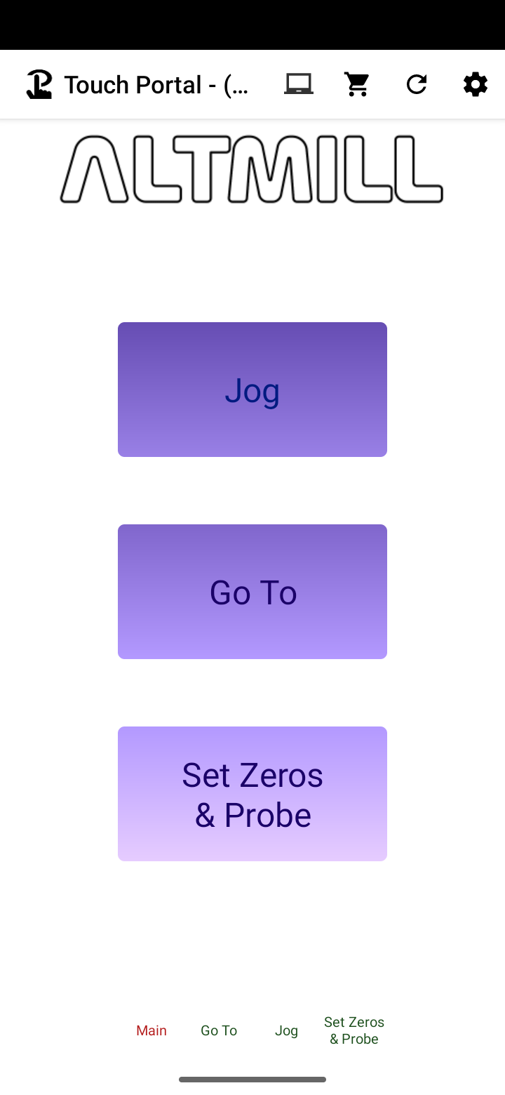

The post by @mick_s on the layout of some buttons in gSender got me to look into the pendant again. The pendant that I have (outlined here: Another pendant using a programmable keypad - Show Off! / :chair: Projects - Sienci Community Forum) doesn’t really address the issue of the buttons being too close. When using it, I always had to pause to make sure i was pressing the right button. You shouldn’t have to do that. And the fact that it requires a USB cable meant that I wasn’t using it much.
So I decided to look at Touch Portal that @gwilki discussed in this thread. I had to upgrade my smart phone so my old one could be used as a pendant for Touch Portal.

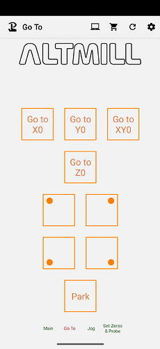

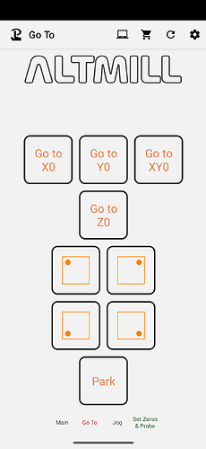

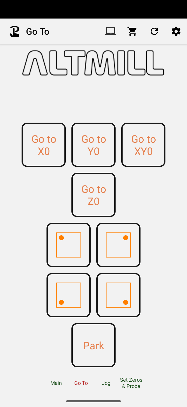

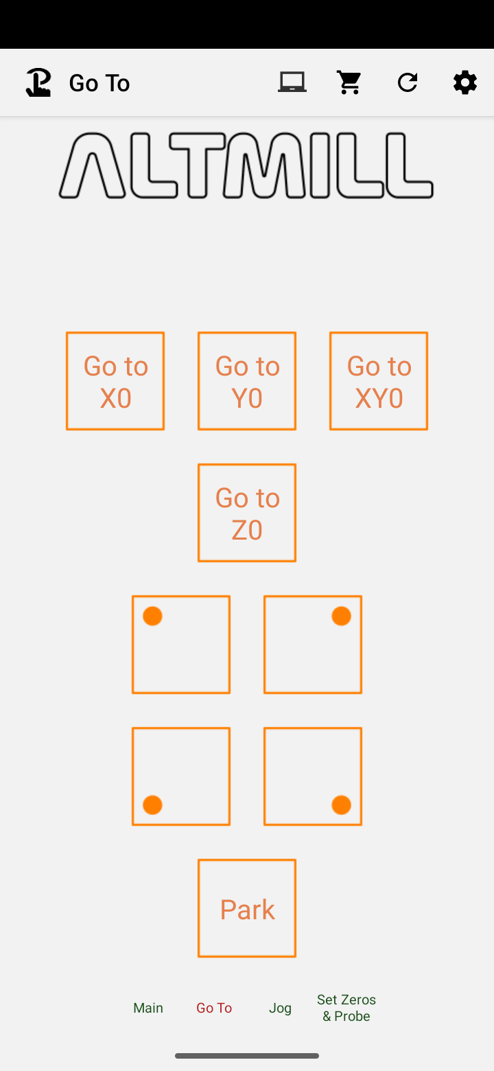

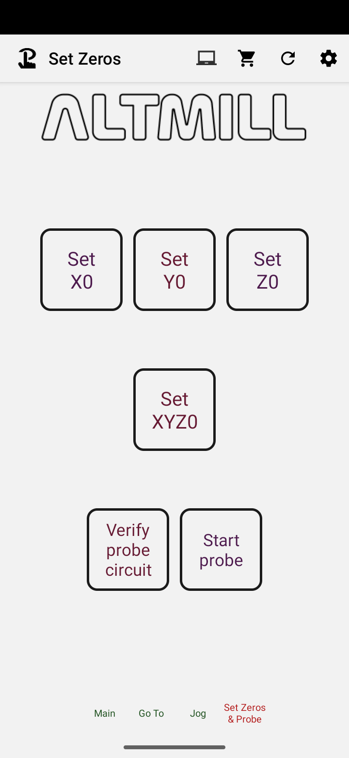

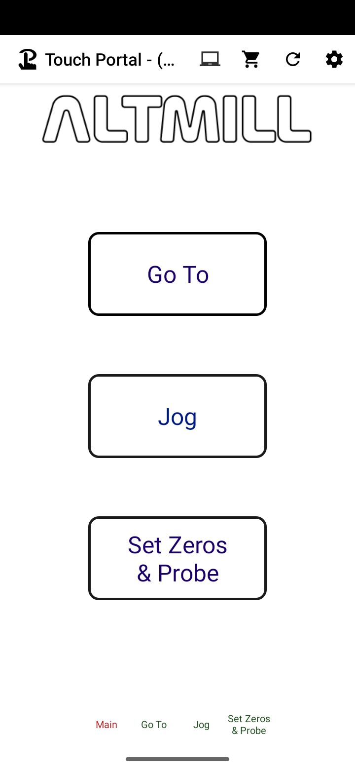

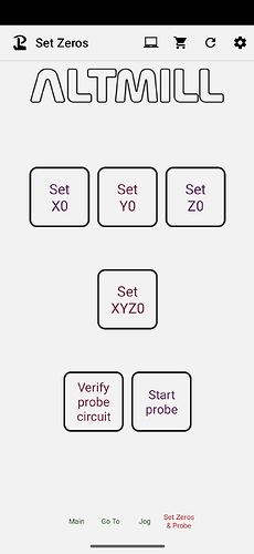

I spent a bit of time working on the interface today. I used some of the same icons I had for the pendant but may spend some time designing something more stylish later on. I have a grid of 6 x 14 with most buttons being 2x2. A finer grid allows a better layout for the buttons. The free version of Touch Portal only allows a grid of 2x8 so I had to purchase the pro version.
Apart from the main page, I have three pages defined. One for the GoTo’s, one to set the zeros, and one to jog. I think that covers most of the ones I would use close to the Altmill. All the other stuff I do at the gSender console.
And in case you’re wondering, you can’t add logos in Touch Portal but you can group icons together to make them look like a logo.
The Altmill “logo” is actually three inactive buttons, each with an icon representing 1/3 of the logo.

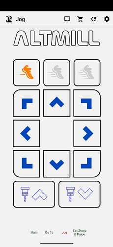

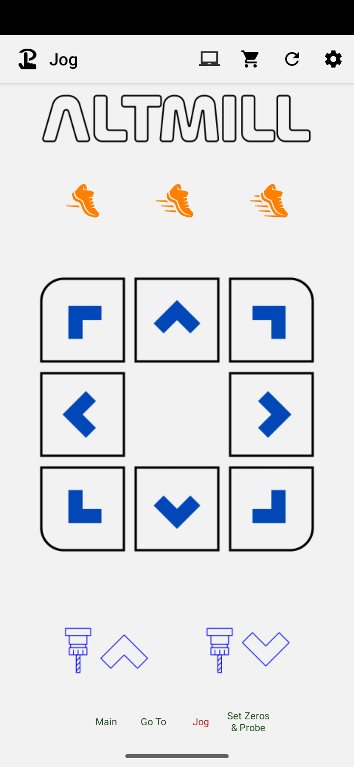

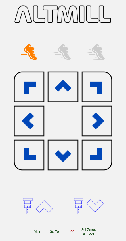

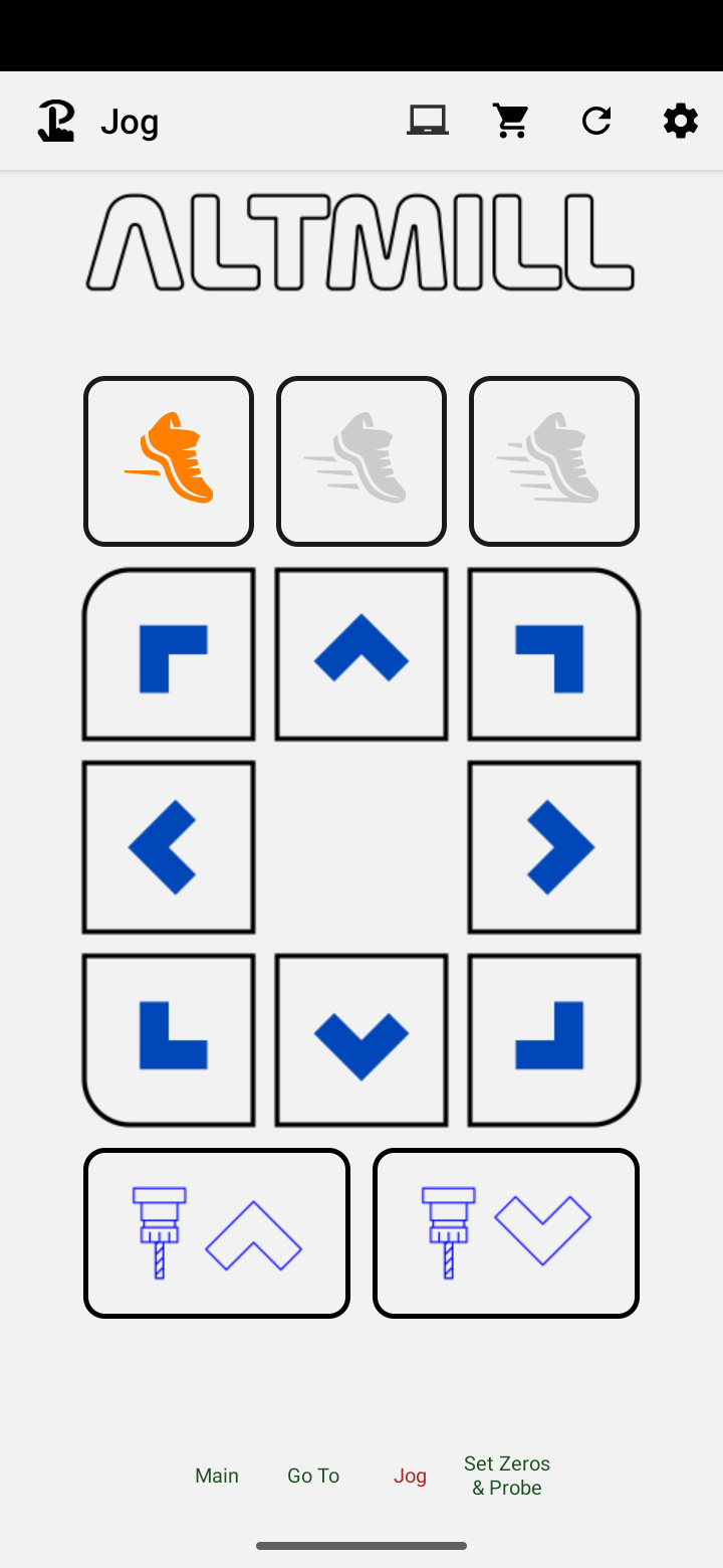

I made a few changes to the Jog page.
  1. The jog speed buttons were changed to a radio button style so that the active one is highlighted.
  2. When navigating to the Jog page, the jog speed is automatically set to “Precise”. I did this because Touch Portal has no way of knowing the actual speed state in gSender. So by setting it to one of the three speeds on page load, at least you wont have any surprises.
Touch Portal has a way to read values from the host computer. I’ll have to investigate if it can read values from gSender. The jog speed would be great, but it would be the cat’s meow if it could read the XYZ coordinates too.
I purchased the border pack in order to easily add borders to the buttons. I could have done it in my graphics editor, but for $2 extra, I decided to buy the add-on.

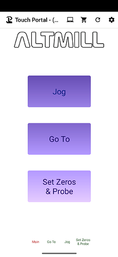

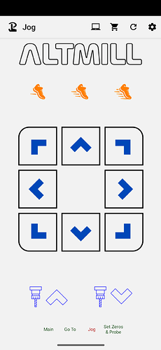

Final version for now.
Before I do any more improvements, I’ll see how much I actually use it. Not bad for an old phone and $20! Thanks for the tip Grant.
