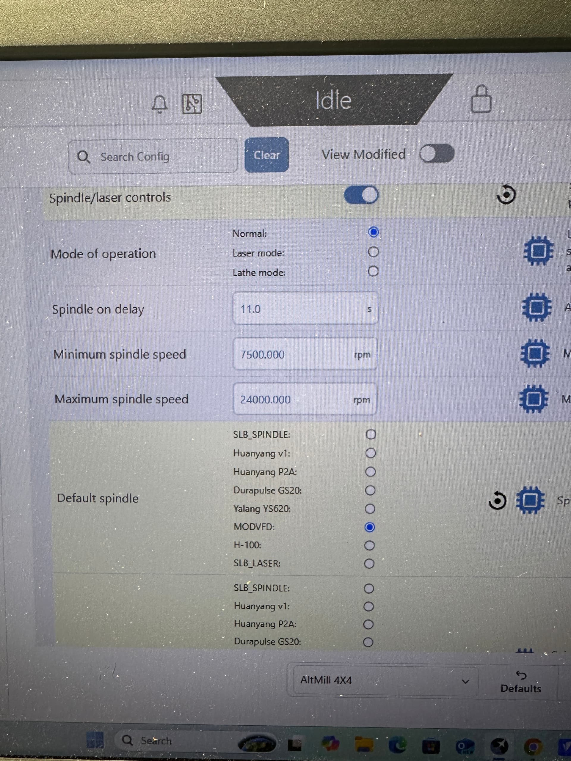

DB600 VFD Settings in Gsender
Managed to get my DB600 VFD working via RS485 in Gsender
here are my settings

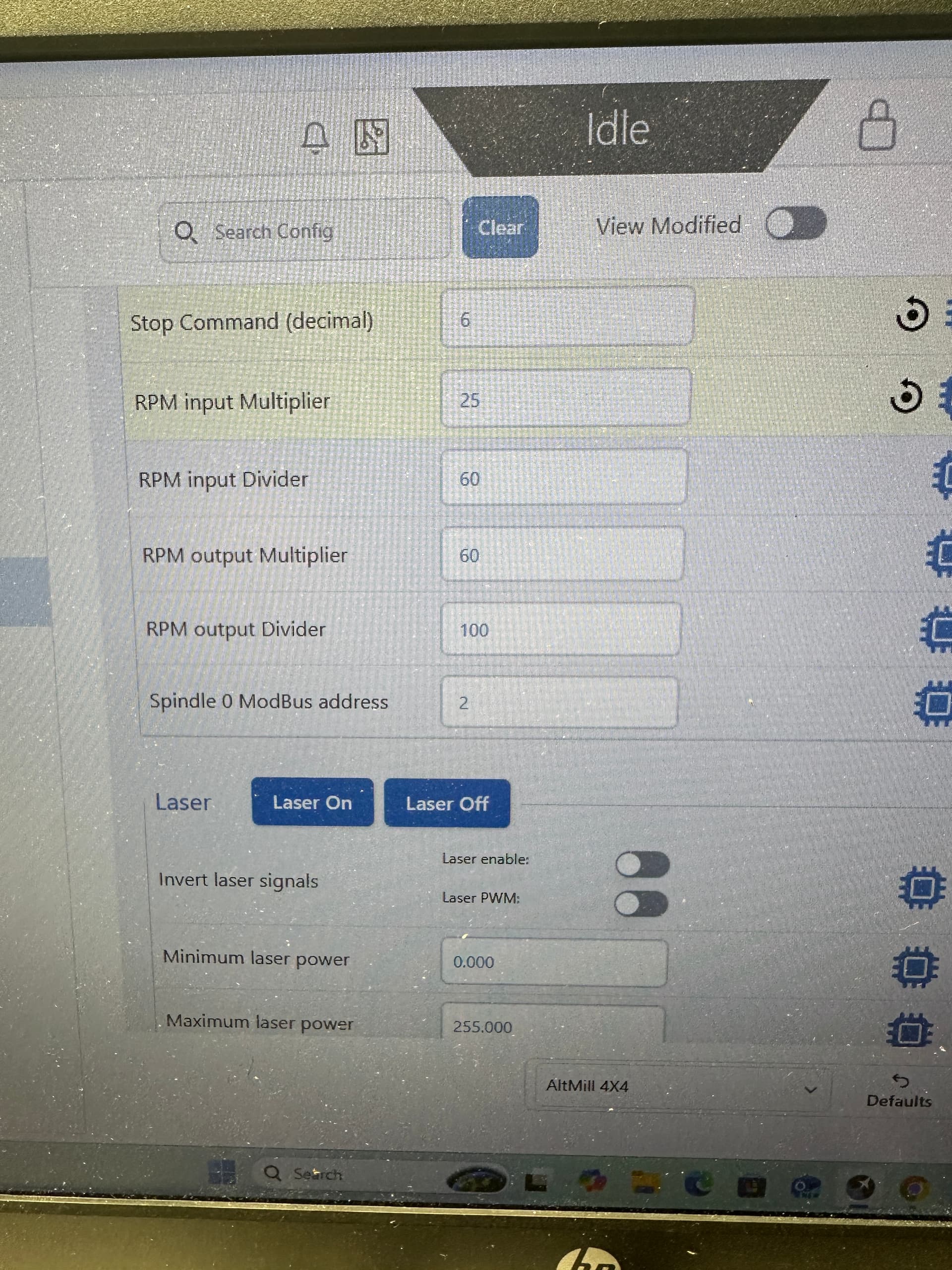

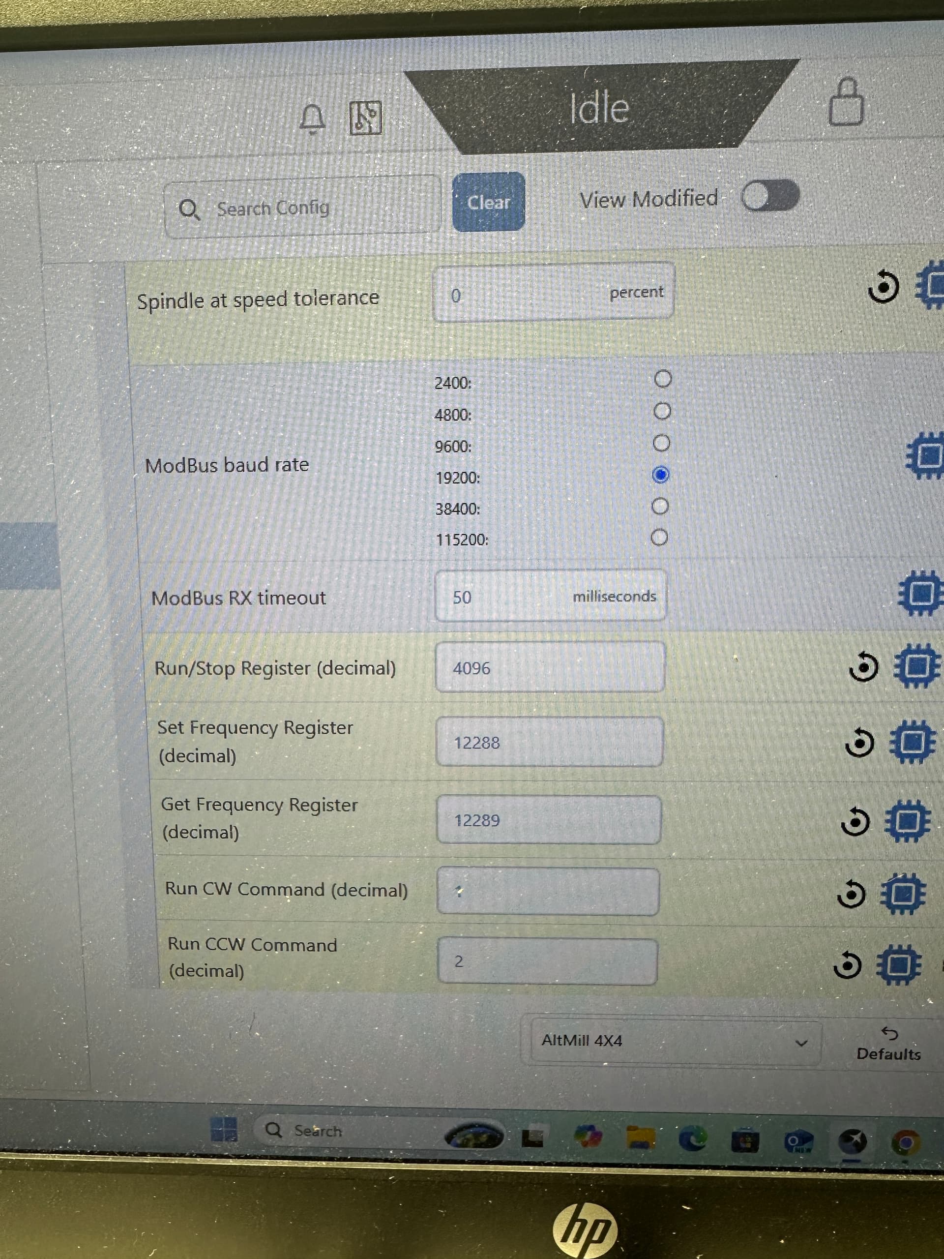

Description Setting Recommended Value (dec)
Run/Stop (operation) register address $462 4096
Set Frequency (command) register address $463 12288
Get Frequency (feedback) register address $464 12289
Run CW Command (data to write) $465 1
Run CCW Command (data to write) $466 2
Stop Command (data to write) $467 6
RPM input Multiplier $468 25
RPM input Divider $469 60
RPM output Multiplier $470 60
RPM output Divider $471 100

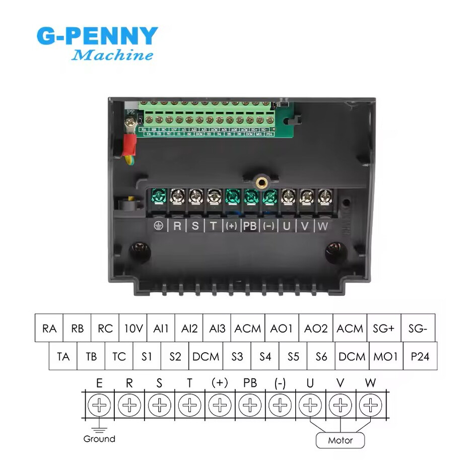

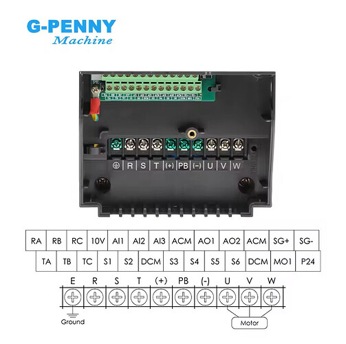

Can you link the vfd source? Googling only pulls up BD600 vs DB600
This is where I purchased from
G-Penny on Aliexpress
https://www.aliexpress.com/item/1005002074481684.html?invitationCode=alozcnRqeGJtUDJXVU9CbVFuWHNGWDBrSERXbVFJZldHbVI1Unc0T3p6YWVQemFTZUJrNWVWT0s1MU1hdTAyWg&srcSns=sns_More&spreadType=socialShare&social_params=21939865392&bizType=ProductDetail&spreadCode=alozcnRqeGJtUDJXVU9CbVFuWHNGWDBrSERXbVFJZldHbVI1Unc0T3p6YWVQemFTZUJrNWVWT0s1MU1hdTAyWg&aff_fcid=284d054b9e5644fea7a77b8801a2deec-1758115478781-06153-_mrHb0hX&tt=MG&aff_fsk=_mrHb0hX&aff_platform=default&sk=_mrHb0hX&aff_trace_key=284d054b9e5644fea7a77b8801a2deec-1758115478781-06153-_mrHb0hX&shareId=21939865392&businessType=ProductDetail&platform=AE&terminal_id=7a34ac6453be41e3996667827343eaec&afSmartRedirect=y
