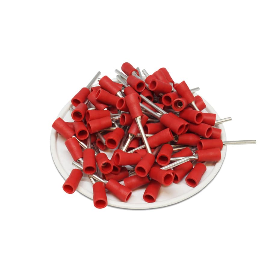

Will pin terminals work? Like, these, for example
I’ve used those in instances where a crimped ferrule is too big to fit into a terminal. Essentially converting a stranded wire into a solid copper pin (ok, it’s formed in a die). Just like terminating your standard NMD house wire.
I think those are a great alternative to ferruls, and as a bonus, no special crimper required.
Tks, Claude. I ended up finding some locally and I’ve put them on all the motor wire ends and the two on the probe connector.
