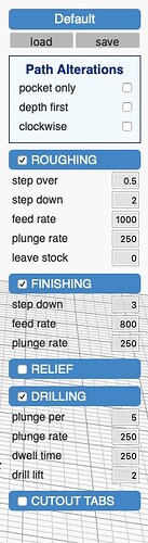

I used 1/8 bit and thickness 30mm of laminated wood.
CAMLab default setting 10 time, one time 3mm x 10mm
After 2 or 3 time, 10mm, suddenly drill bit was down on the line that is not hole, I can not understand the motion. I think G-code has problem of CAMLab output.

Can you post your bit settings from Camlab? I’ve never used it, so I don’t know if that is possible. I think that anyone here that would like to help needs to know feeds and speeds. That bit looks burnt to me, so I’m thinking that may have caused your problem. Also, did you have ramps set, or did you plunge straight in for each pass?
Finally, I would bet that the gouge that we see was caused by the broken end of the bit, not any problem with the Gcode.
I send screen capture image of CAMLab.
You can see bit setting.

I went onto the camlabs site page and I can’t see a way to have it ramp into your cuts. It’s likely there, but I can’t find it. I would bet that is the issue. It is plunging straight down 3mm, then starting the cut. There are users on here that use camlabs. Maybe one of them or Chris can help you more.
I always ramp the plunge with small diameter bits to reduce the strain.
