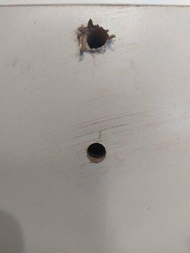

I’m trying to drill holes into laminated wood boards using the millone, however when drilling some holes the whole thing goes “pop” and I notice the motor slows down and the finish looks like the hole on top, but other times the finish is good like the hole on bottom. I tried 100 as the feed rate and 25 as the feed rate but both have the same issue. What am I doing wrong? The drill bit is 1/4"

Are you using a drill bit or an end mill? What make is your router? At what speed are you running the router?
What software are you using to generate the Gcode?
Finally, when you mention feedrate, are you running metric or imperial?
Lots of questions with no answers, I realize. But with the answers, I’m sure we can help you out.
Thanks for the reply, I’m using 1/4" end mill but I notice similar things using a drill bit as well. The router is Makita and I have speed set to “2” on the router. I wrote the Gcode manually myself, currently using

@zhumxcq It’s not clear to me what the F20 means. That is, I know that it is the plunge rate, but I don’t know enough g code to know what measure it refers to and what interval. Is that 20mm/sec, 20mm/min. You’ve said that you are in metric, but I don’t see an indication of that. So, to me, in my ignorance, this could be 20in/sec or 20 in/min.
All that said, you don’t say if you are using a downcut or an upcut mill. Looking at the pic showing the blow out, I would guess that you are using a downcut bit and plunging too quickly. Are you getting a clean cut on the top of the material?
Now that I think about it, it is 20mm/min, as it is very slow when plunging downwards. It is originally set to 100mm/min. The blow out are happening on both sides, I’m not too sure if it downcut or upcut, I can take a look tomorrow. This blow out is also happening with 1/4" drill bits as well.
I think the problem is heat. Going down 20mm in one pass that slow will cause the chips (or dust) to stuck onto the mill and not to come out of the hole. The glue will enforce this. Try to go in more passes like:

Btw, I think 50mm/min is still too conservative, could/should be me much higher.
