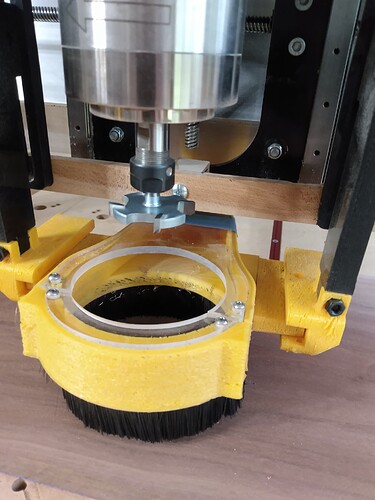

Hello, all. I am hoping someone can help me. I have the LongMill 30x30 MK2.5 with a spindle. The dust boot that came with it doesn’t work for me since it attaches to the spindle and is relatively large. Does anyone know if there is one that connects to the Z axis, like the Magnetic Dust Shield for the Makita router? I have been looking all morning for something, and unfortunately, I have come up empty.
Check with pwncnc.com they have one for a MK2. I made that one, but had to modify it to fit a MK1. You can buy complete, or buy the files and print your own with there hardware.
I also really liked the Magnetic Dust Shield and wish it were available for their Spindle kit.

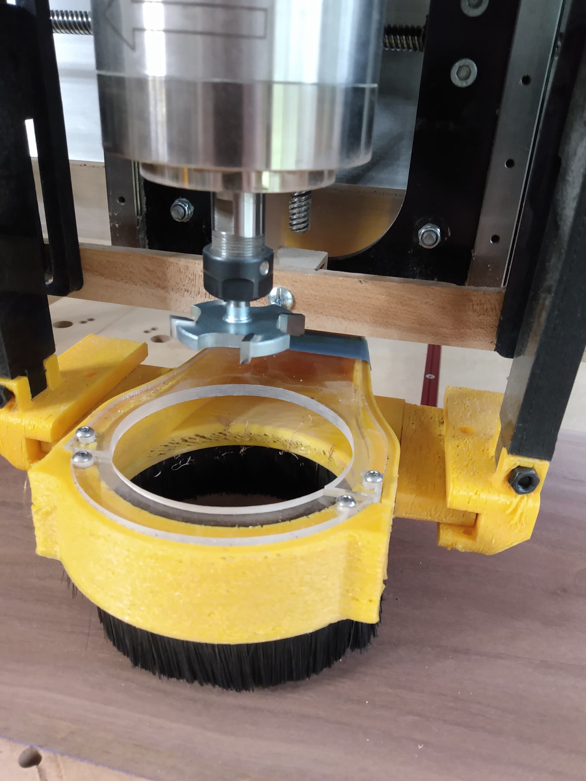

@ozguzzi Do you happen to have a photo? I looked at it on their site, and it looks exactly what I am looking for. They don’t have any photos of it on the CNC. You said you made one? Did you purchase stl files or from scratch? Thanks for the helpful information.
dam4 I bought the files from PWNCNC to make the dust boot for a MK2. It is a little different for a MK1, so I just modified a couple of parts. Should fit yours just fine,

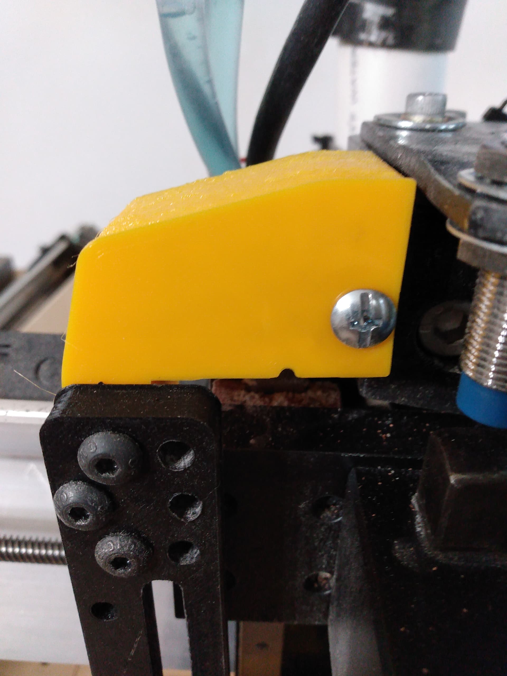

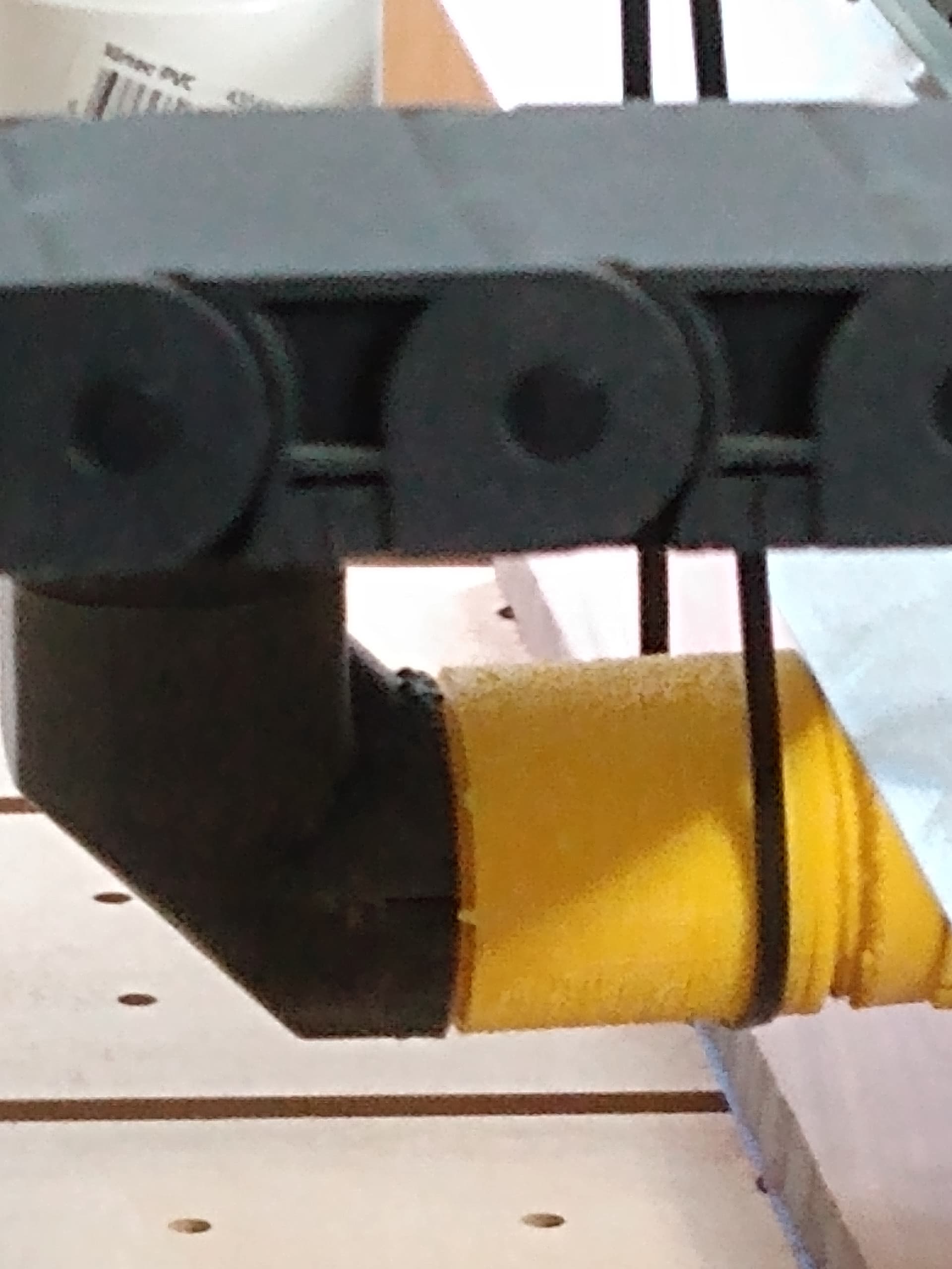

The front piece is held on by magnets. Here is the location of their maker files:
I made ver3.
You need to go to thier SHOP area, then maker files. They do sell it complete also.
