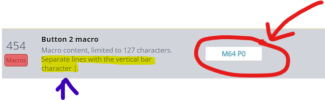

I have 2 of the SLB action buttons programmed to turn Switch 1 on/off for separately powered LED lights under the gantry. Each button works fine tuning the lights on and off. Is there a way to program a macro for just one button to toggle the lights on and off? Or do I need to use 2 buttons?
What’s your macro look like? I don’t have a SLB to test, but I like to think most things are possible.
I typed M64 P0 in the firmware for button 2 (turn on lights) and M65 P0 for button 3 to turn the lights off.

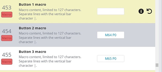

It’s just a 12 VDC power supply running into the switch relay on the SLB and then onto the LED lights. The LEDs are not addressable and have no data, they are one color. Here is a picture of the firmware settings for setting up the macro on each button of the new E Stop. AS you can see I have buttons 2 and 3 programed with the on and off macro and they work. So, I am not too familiar with setting up macros. Would I copy and paste those 2 lines you sent into macro field for the buttons? Also, I am not sure what you mean when you say “if global.toggle is one make it a zero, otherwise make it one”

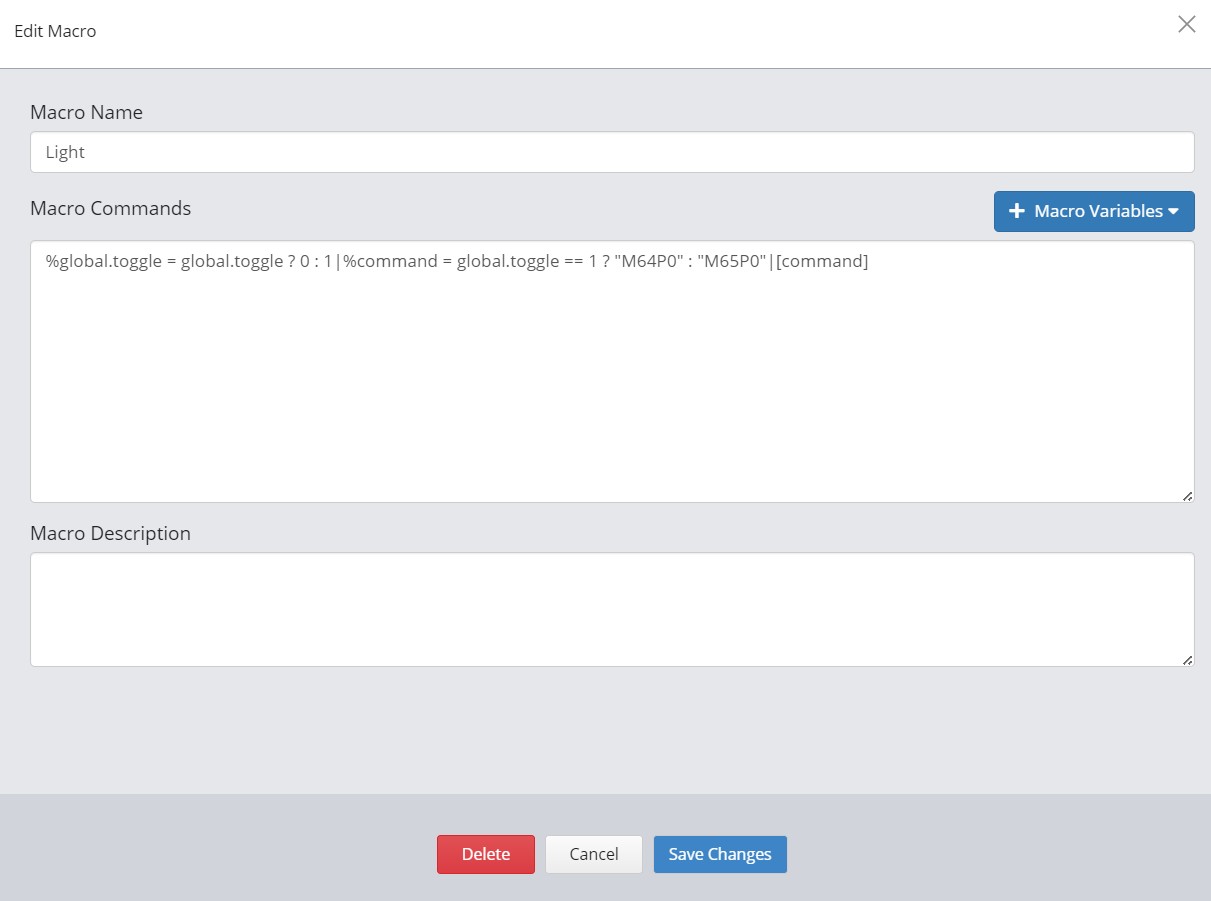

Paste this (three lines separated by a | as it says in the hints):
%global.toggle = global.toggle ? 0 : 1|%command = global.toggle == 1 ? "M64P0" : "M65P0"|[command]
@chrismakesstuff Do regular macros not work in this “Button Macro” area? The macro above would work as a regular macro in gsender (and it’s less than 127 characters)
“toggle” is just a name for a variable that stores a value of 1 or 0. Since, as far as I know currently, we can’t detect the state of your relay with the SLB, we just alternate between 1 and 0. That, in turn, alternates which command to send (M64 or M65).
Well, I copied and pasted your string into the Macros
I then saved it and clicked the new Macro. A pop up said “Started running macro light” (light is just the name I gave the macro). Nothing happened. So the macro seems to be good but it does not turn the lights on or off. I would try KGN’s suggestion from the link above but I am not sure how to change the macro to fit what I am doing.
If you’re entering it as a regular macro, enter as I had it with 3 separate lines.
The one liner you used would go here:
I used the | character to separate the lines as it says in the hint.

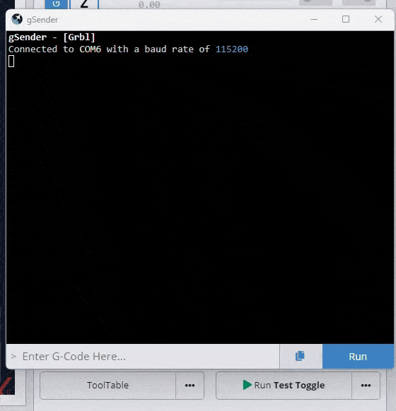

The macro works…I am running this on regular GRBL, so the commands (M65 & M64) are “unsupported”.
toggleMacro
@jkunda Looks like you should be able to run the three line macro as a regular gSender macro to toggle your LEDs, but the limitation might be the action button macro capabilities as of now. After @gwilki did some testing and I read some posts more carefully, it looks like macros for the action buttons are limited to pure gcode.

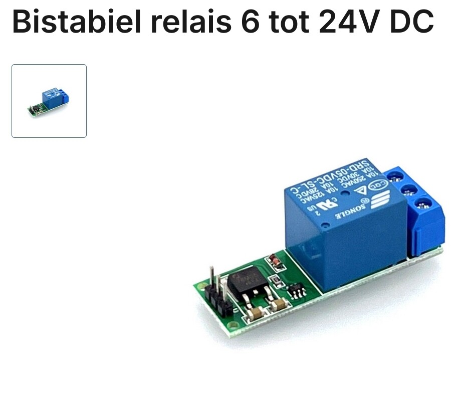

If software cannot help ya, it might be an option to look into latching relais or bistable relais. These relays work as an electronic light switch switching state via a pulse ( Your one button)
They don’t have to cost ya much. I can source one local at aprox $5. (Beware that these relais can be prety costly when you get circuit breaker grade ones)
The ones I am refering to here are looking more like arduine add on boards.
They don’t pull much power, cause they only draw when switching state, and are able to switch a substantial amount of amps. More than enough to switch a mere led strip or ten.

Haaai Grant,
This isnt a normal relais. It’s a relais that switches state when pulsed and stays that way untill pulsed again. The only thing the macro needs to do is pull up (or down) the input line to the relais, hold for a milisec and release the puls. The relays switches state when pulsed and latches that new state untill pulsed again.
This way you can use the button with the same macro to pulse the desired P0 output to switch the relais between normaly open and normaly closed. I like to think that a simple
M64 P0, M65 P0 might do the trick to create enough puls to activate the relais, but if not, 127char should suffice to create some sorth of delay inside the puls size to get the boomerian result.
